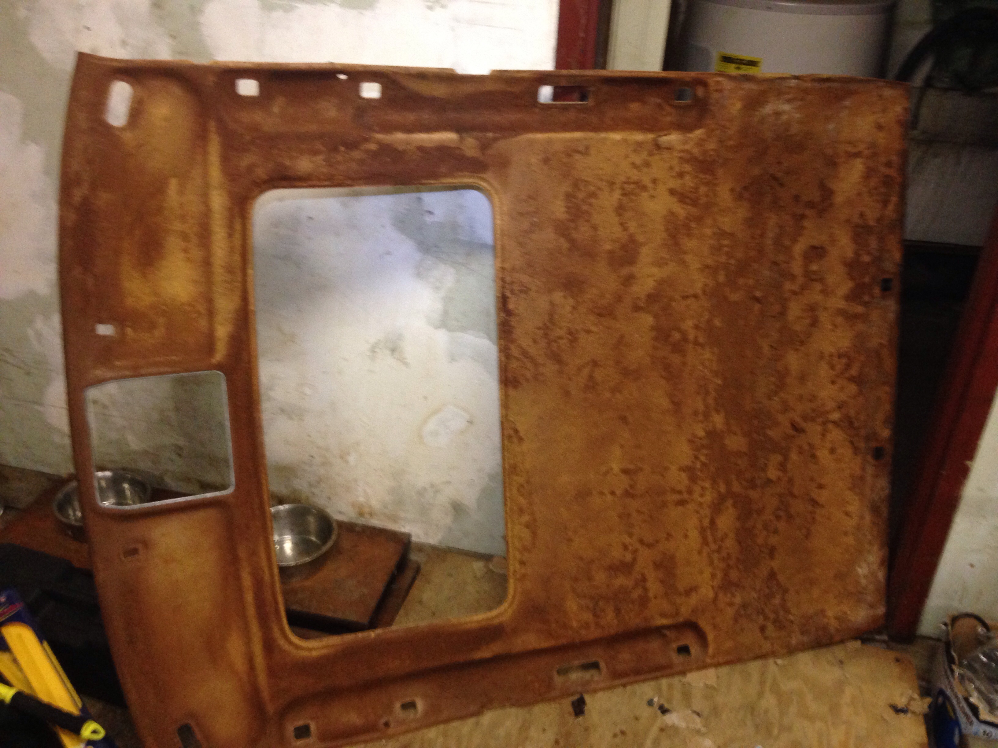

I just pulled my headliner board out of the car. Special shout out to Robert " rspi " for the awesome DIY video. I took MVS advice and went to joaan fabrics and bought 4 yards of suede black @ $11.99/yard
Can anyone send me a photo of a good tool to use to remove glue ?

I used a plastic scraper to remove the deteriorated foam, and then rubbing alcohol in a spray bottle to clean it up. I also used Bestine, which can be had at an art supply. It is not cheap, but is designed to remove glue, primarily rubber cement, but works on other kinds too.

I just use a stiff plastic brush to remove what doesn't pull off. Have never used anything to make extra efforts to get any glue off.
