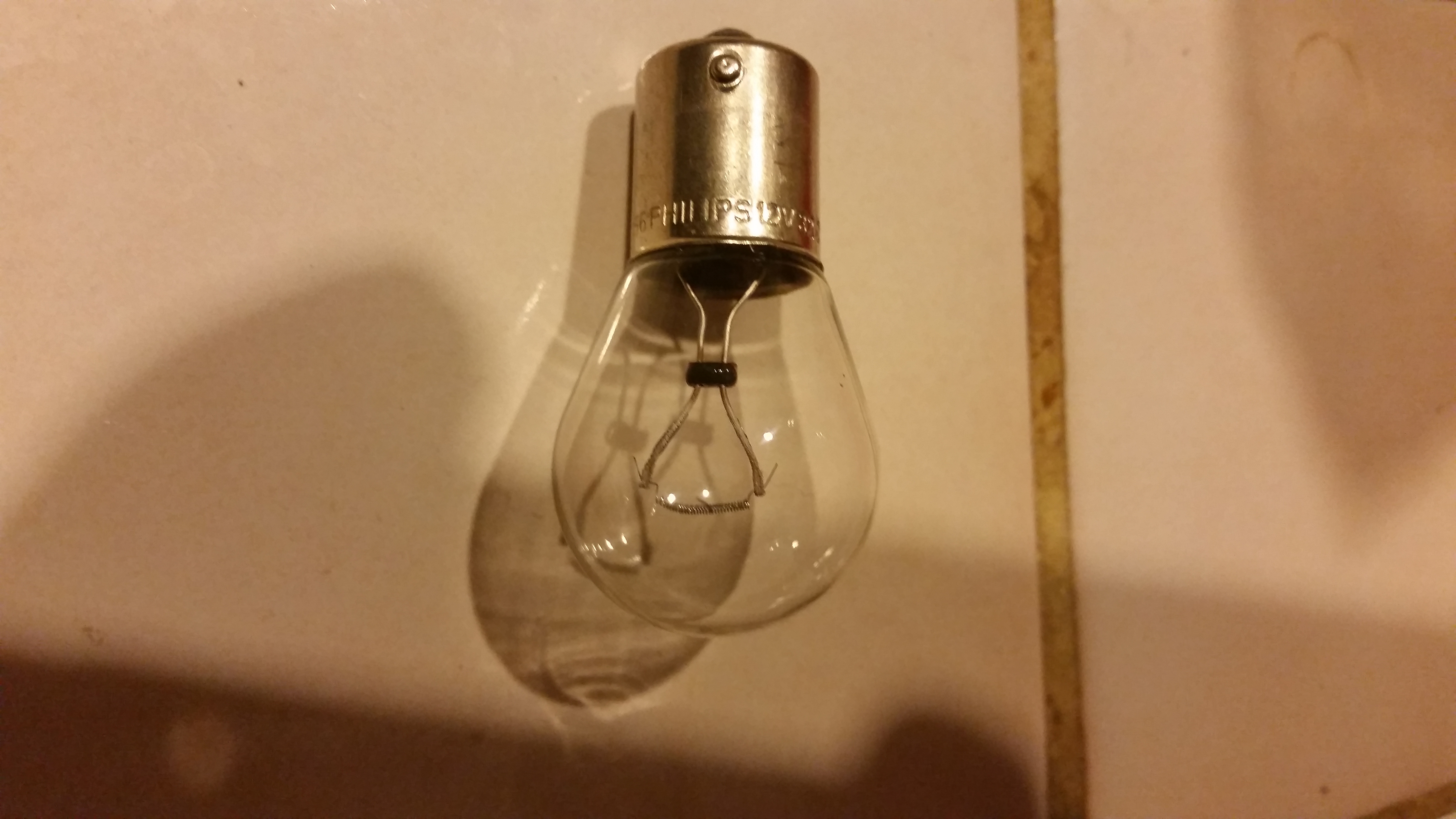

My issue turned out to be simpler in nature; a bulb that looked good visually but failed continuity. You have no idea how happy I was to see the issue reproduced on the other taillight once I swapped the bulb over. I keep the bulb at my desk as a reminder to check the simple stuff first, even if it is unlikely.
