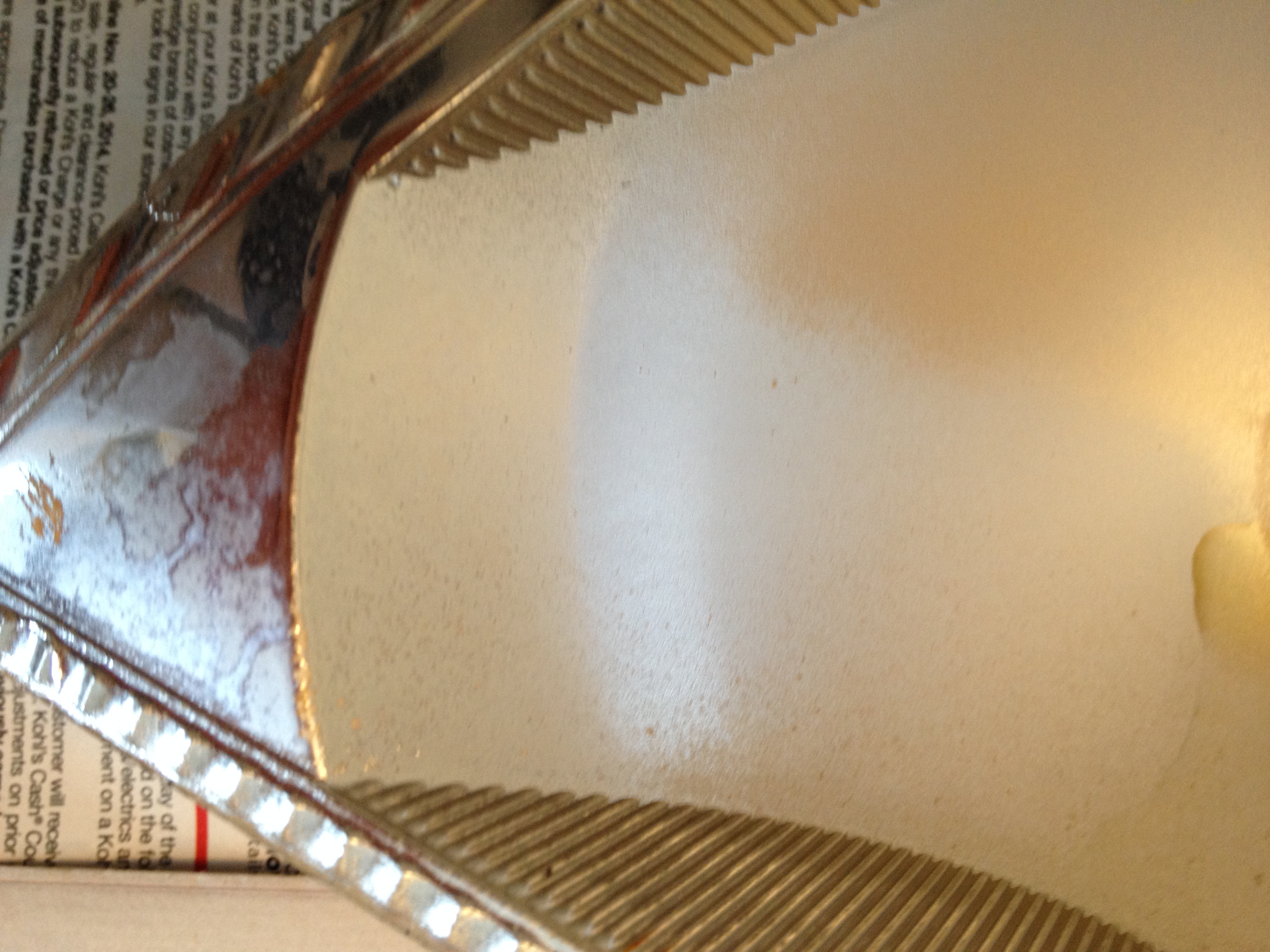

Step #3: Distilled water.
Damage is noticeable when comparing a Step 1 picture to a Step 3 picture: ^ Step 1 ^ | v Step 3 v As stated earlier, I believe the alcohol may have done some damage to the finish, and this round of distilled water just rinsed the lifted finish away.

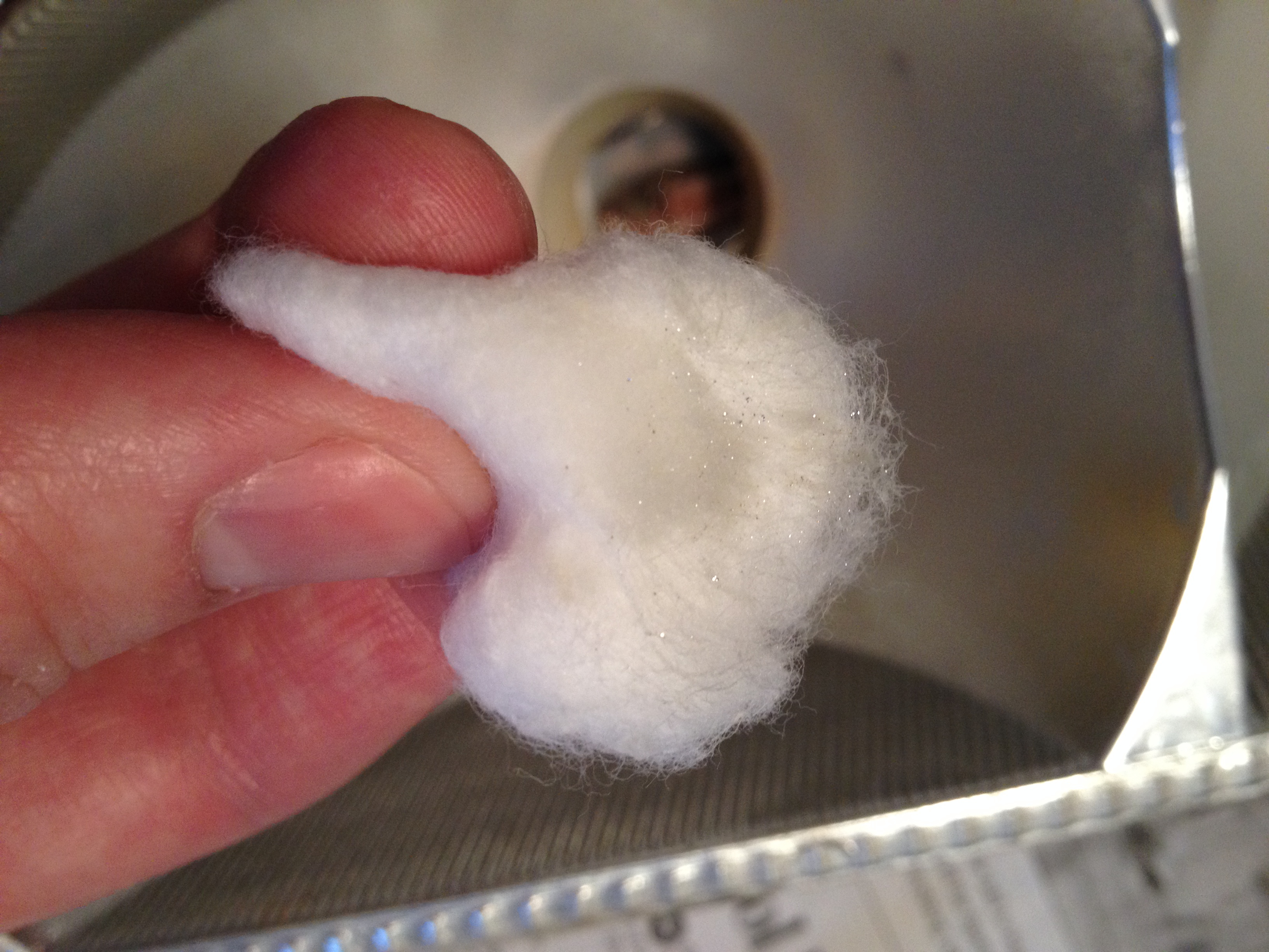

I did some other minor testing. With mild pressure using a cotton ball, I could not see any damage to the surface or residue on the cotton ball (This could be because the reflector was already so old and worn, but I tried this on the parts that were still shiny).
With moderate pressure, however, I would start to notice specks on the cotton ball: Going past moderate pressure runs the risk of severe, irreparable damage. When I applied moderate pressure and scrubbed, or swiped with heavy pressure, this was the general result: ----
After trying all this on the old headlamp, I felt confident trying a distilled water and compressed air combination.
Before and after pictures of the new headlamp.
Before: Obvious mineral spots. Probably wouldn't have significantly affected the function of the headlamp (especially when compared to my previous one), but I just had to be a little obsessive.
After: Noticeable reduction in mineral spots, though there is still some staining at the bottom. I decided to let this go and be happy with the improvement I had achieved.
Lastly, I had noticed there was some discoloration, presumably from normal heat/wear, in the ridges that did not seem willing to rinse out at all: It is clear to me that distilled water would not be enough to restore any kind of shine or clean any discoloration.
