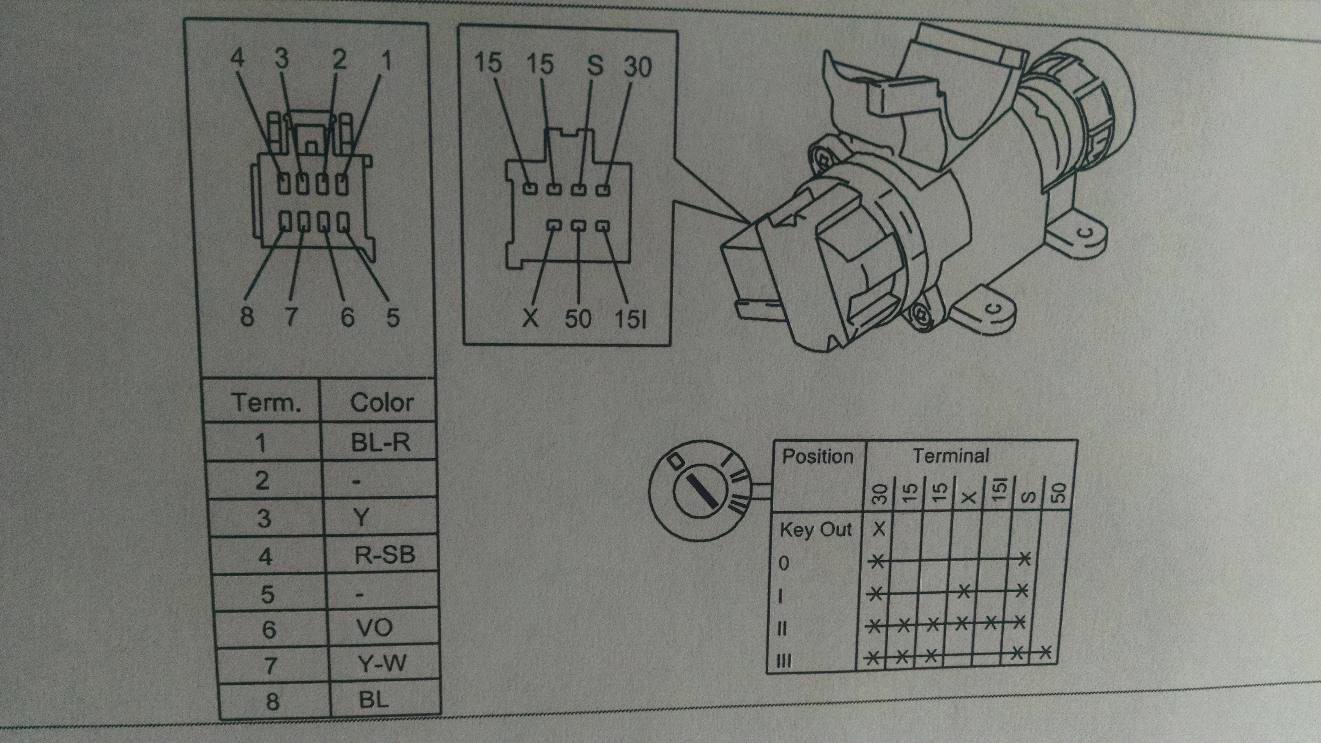

I had an opportunity to test the iginition switch and the signal for the various key positions (position 0, I, II and III). It all checks out according to the diagram above. Still nothing. This proves that the ignition switch is working (or at least it is giving out current as designed for key position).

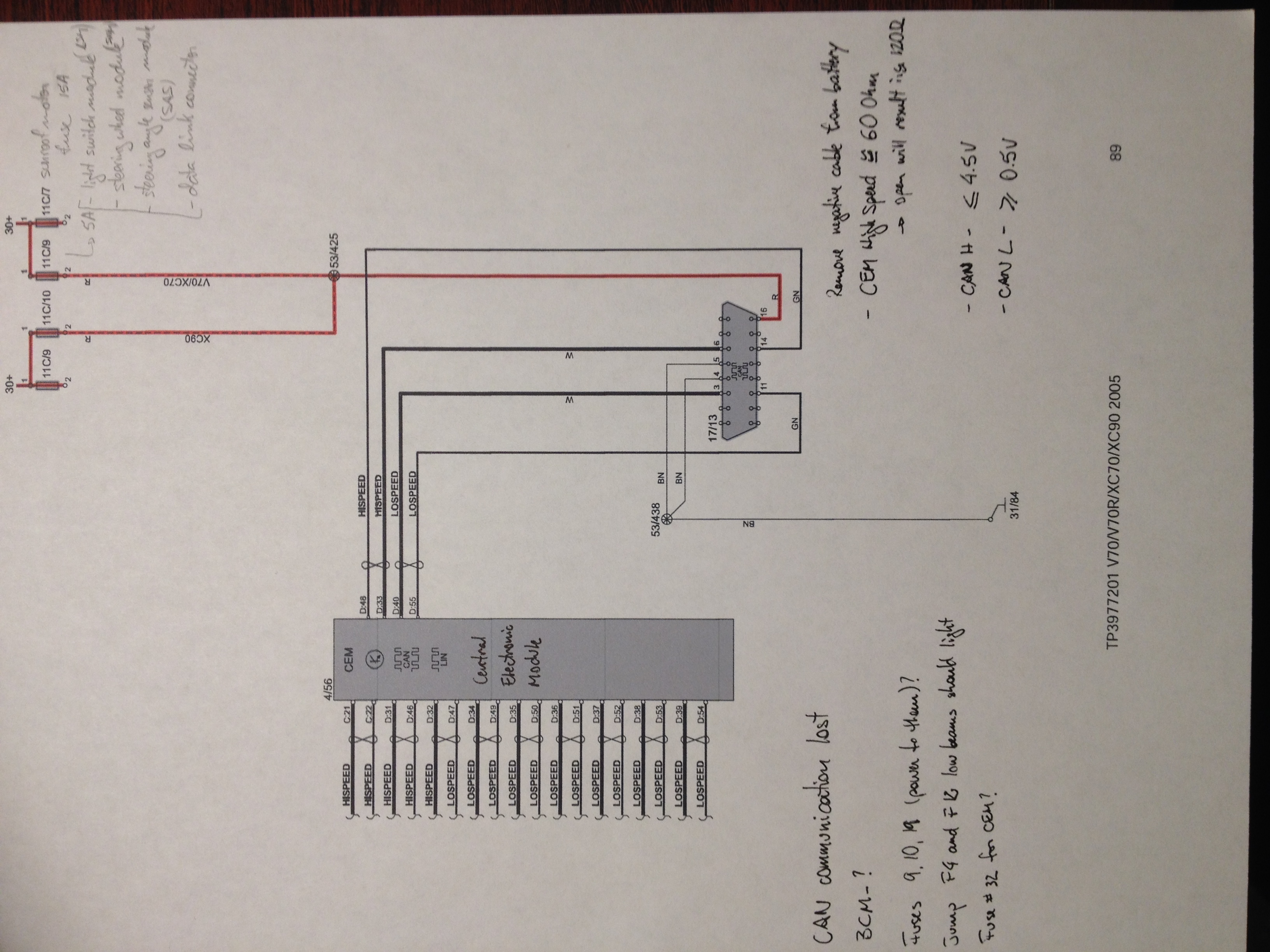

I have also checked for current in the OBD connector (Data Link Connector). According to one of the diagrams that I have found, the CAN High Speed should provide under 4.5 Volts between pins 6 and 14 of the OBD connector, and the CAN Low Speed should provide greater than 0.5 Volts between pins 3 and 11 in the OBD. This voltage supposedly comes directly from the CEM. There is no voltage in any of these points.
Also, with the battery disconnected, the CEM High Speed should read approximately 60 Ohms, and an open circuit should be about 120 Ohms. I've got nothing. Busted CEM?
So, it looks like the CEM might be the culprit. I still want to rule out the antenna ring immobilizer before proceeding to do anything with the CEM. Not a cheap component, and I don't want to go by trial and error with expensive modules.

You said you have power to engine management relay, I'm assuming that's FMA2, correct? Did you check auto tranny interlock which grounds pin C28 of cem? Starter relay is FMA4, can you pull relay and volt meter pin 2 for 12v when trying to start and pin 4 for zero volts? Can you also post schematic you used to check can?

That is correct, I do have power to the Engine Management Relay (FMA2), and don't have power to the starter relay (FMA4) (key in position II - didn't try with position III). Will test for power at the starter relay with key in position III. Attached is the schematic that I have used to test the CAM high speed and low speed at the OBD data link connector using output from the CEM. Won't be able to test the starter relay for a couple of days. Will post back as soon as I have results. Thanks for your help, I do appreciate having someone to bounce ideas with.
