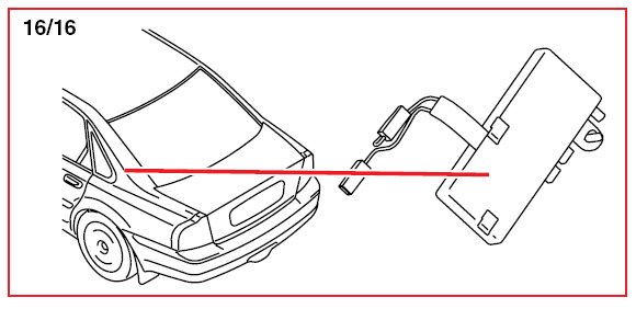

On your S60, the Main antenna is the rear window defroster grid and the Sub is in the rear bumper.
There are also two magic boxes between the HU and the antennas that amplify the signals.
The one for the Main (16/16) is also the adapter that couples the radio into the defroster grid.
2004 S60 main antenna amp 16-16 location.jpg (33.3 KiB) Viewed 13908 times

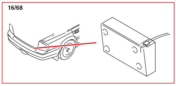

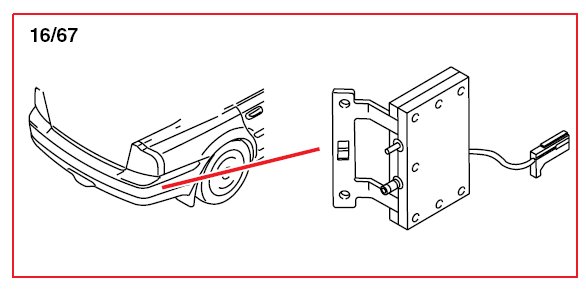

The Sub antenna (16/68) and it's amp (16/67) are here:
2004 S60 sub antenna amp 16-67 location.jpg (26.56 KiB) Viewed 13908 times
There may be some funky connections with the rear window amp/coupler.
Hard to say from here. This Brass Strip thing may be worth a better look,
but I'd be more interested in finding out what changed since it was new.
Where you are in relation to the AM transmitters may be also be a factor.
