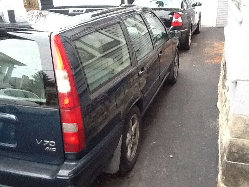

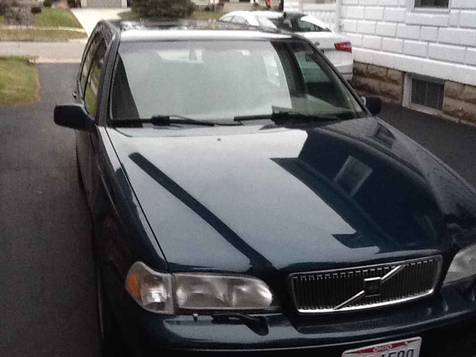

Just wanted to say thanks for the outstanding post and repair data base at this site. I looked at this 98 V70 in early November from Craig's list for $1500.00. I have never seen a more neglected car except at a boneyard. The short list was metal to metal on brakes, top radiator fitting cracked off, entire engine compartment covered in a thick mixture of oil and antifreeze, bad axle boots both sides, A/C compressor bypassed, power steering pump groaned,suspension shot, nice pool of antifreeze in cabin, motor easily rocked around, broken steering wheel adjustment handle and exhaust broke off at cat. I won't go in to the curb appeal of exterior and interior. Two good items caught my eye, the AWD looked newer and car only has 166,000 miles. As my wife dragged me away by my man parts I was able to get the VIN.
Being bored and old I ran the VIN and saw that this car has had only two owners. The car was sold in 09 to the current owner at 122,000 miles. Car was always in Columbus. I took the VIN to a friend at the Volvo dealership and found that the car was sold and serviced by them for 11 years. In 08 they put in $3200.00 of new AWD stuff. My read was the car went crashing downhill in the last couple years. Each issue this car has, taken individually was simply Volvo maintenance. I called the owner the week after Thanksgiving. She told me the best offer she got was from a boneyard for $300.00. I offered $310.00 and got the car.

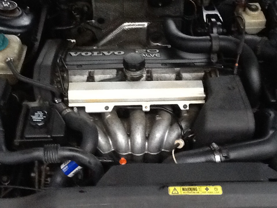

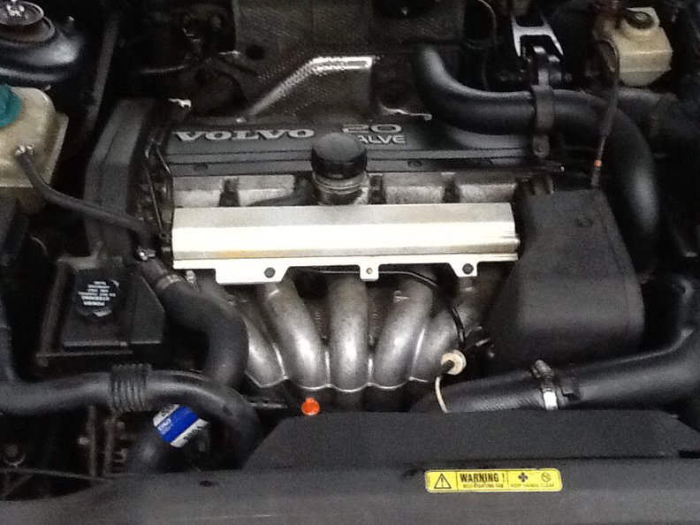

A neighbor's son has a roll back so we picked up the car for beer and ribs plus gas. On the way home stopped at a farm tractor dealer and steamed the engine compartment. Last stop was at a welder's house to repair exhaust.

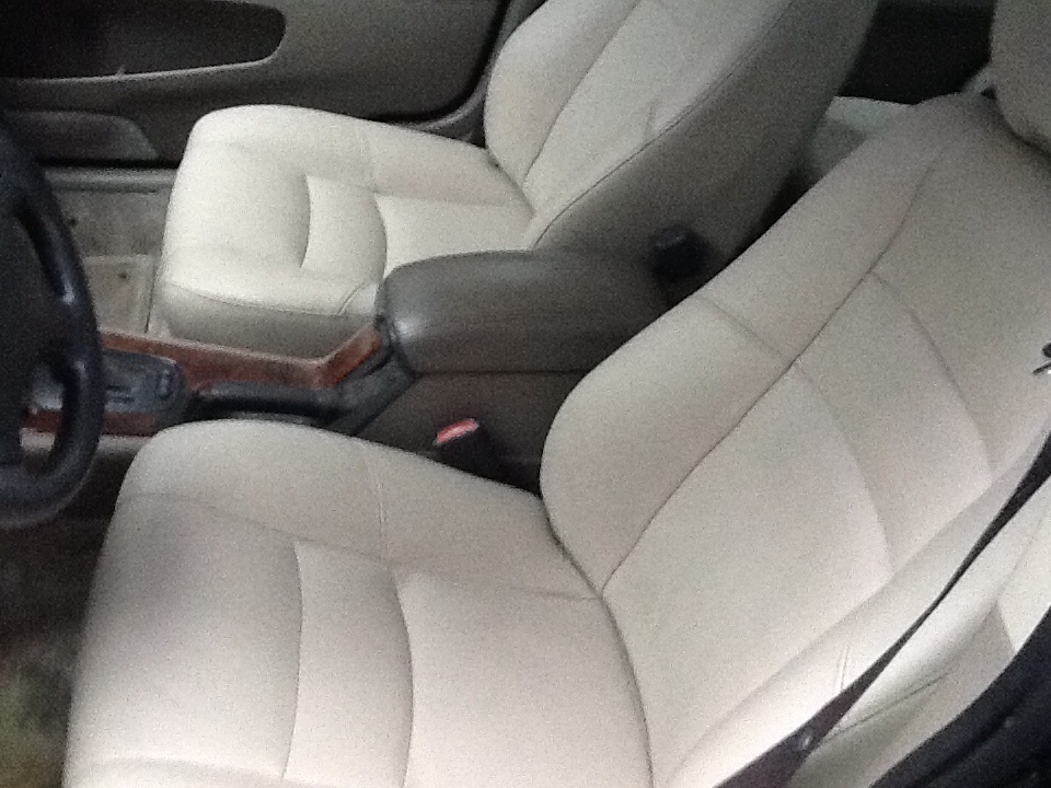

By watching Richard's videos and CN90's PCV steps I just started in front of car and started removing car stuff. Removing radiator fan and radiator opens up ample room for intake manifold removal. This opens up space to easily remove P/S, alternator and A/C compressor. This makes the oil lines and "O" rings a snap to replace. So basicly full timing belt service with WP, new serpentine pulleys, serviceable A/C compressor installed, rebuilt the alternator, rebuilt power steering pump, full service to PCV system, all new coolant hoses, new cam seals, new rotors and pads, new suspension, heater core, cleaned interior and dyed leather.
