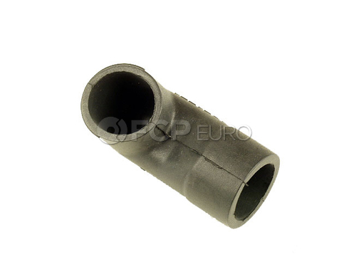

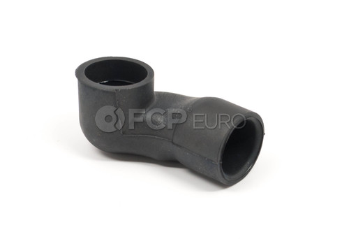

erikv11 wrote:This is a known issue that is usually overlooked in the forum discussions: there are two different shaped oil traps. Either trap will bolt up just fine to your engine, and will even work as long as you keep in mind that each uses a different small hose. If you buy a kit, the hose should be matched up to the trap properly and you will be fine.
I discussed this a bit at the end of this thread https://www.matthewsvolvosite.com/forums ... p?p=351093.
Oil trap 9146756 must be used with elbow hose 1271771, note it is straight
Oil trap 1271650 uses a different elbow hose, 1271653, note it is angled
Thank you very much for the photo, and a concrete answer. Rather annoyingly, EVERY picture I could find of the two different traps had them in orientations such that there was no equivalent combination, so I couldn't compare mounting holes very well. It definitely was clear from the pictures that the lone port on the side of the box (don't remember where it leads to off hand) was spaced differently in relation to the nearby mounting hole on the two models. The variation in hoses shows how that is handled. I hope other NA owners happen to stumble upon this in the future, because I couldn't find that information anywhere. Similarly, the dealers didn't seem to know this either.

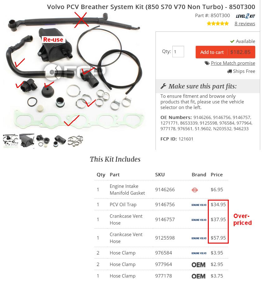

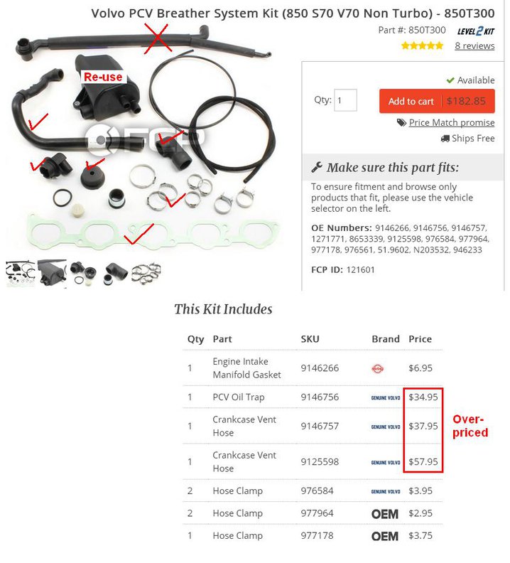

I am writing this for future readers, as much as I am an FCP customer, for this kit @ $180, it is way over-priced! As I mentioned previously, if one orders ONLY the necessary items from local Volvo dealer, the cost should be around $60-$70 and that is it. FCP pricing is higher than Volvo dealer!
I am attaching the photo of the kit you ordered and mark out what should be re-used (oil trap), what you be substituted (the long vent hose) with generic 5/8-inch hose.

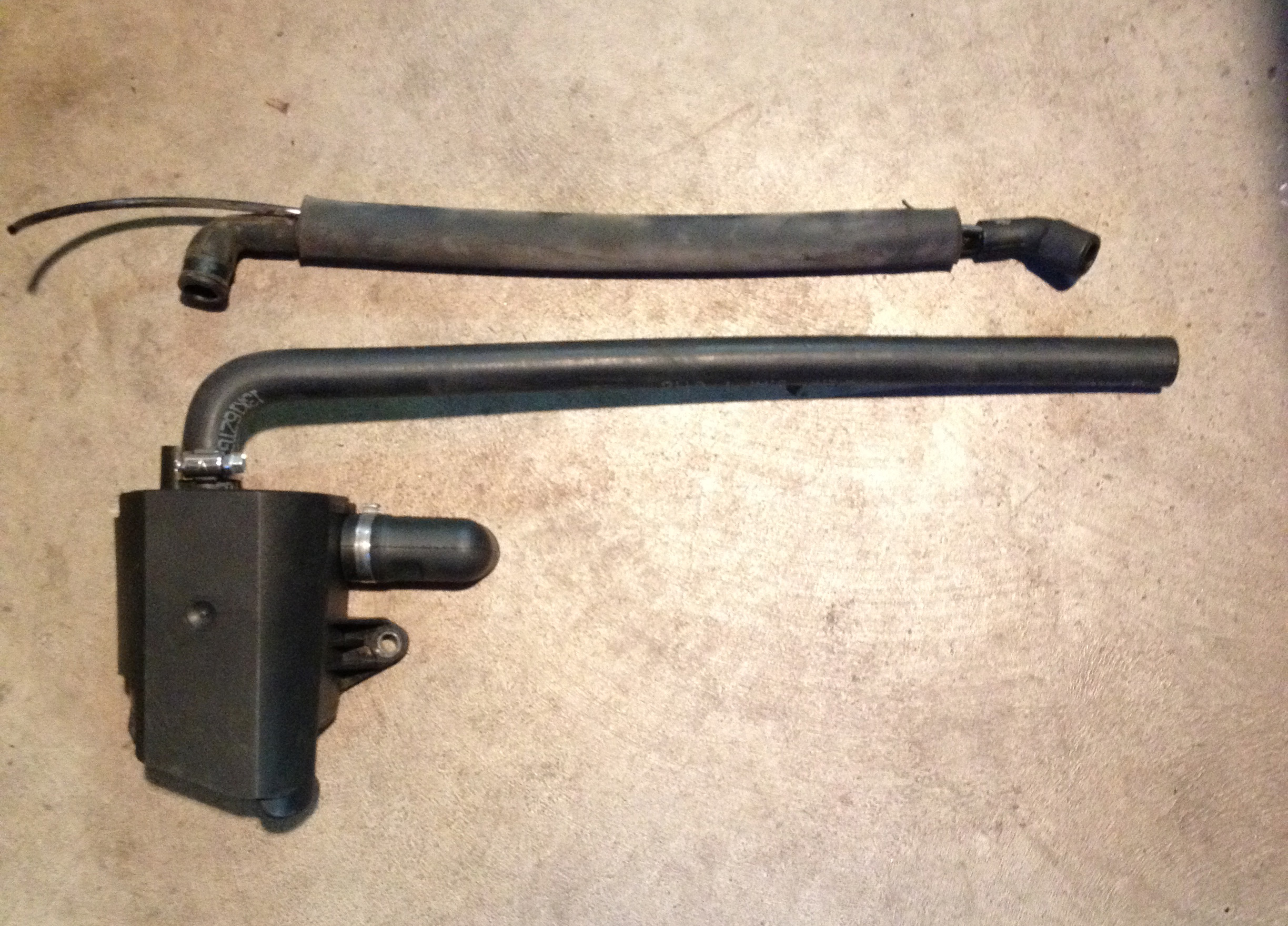

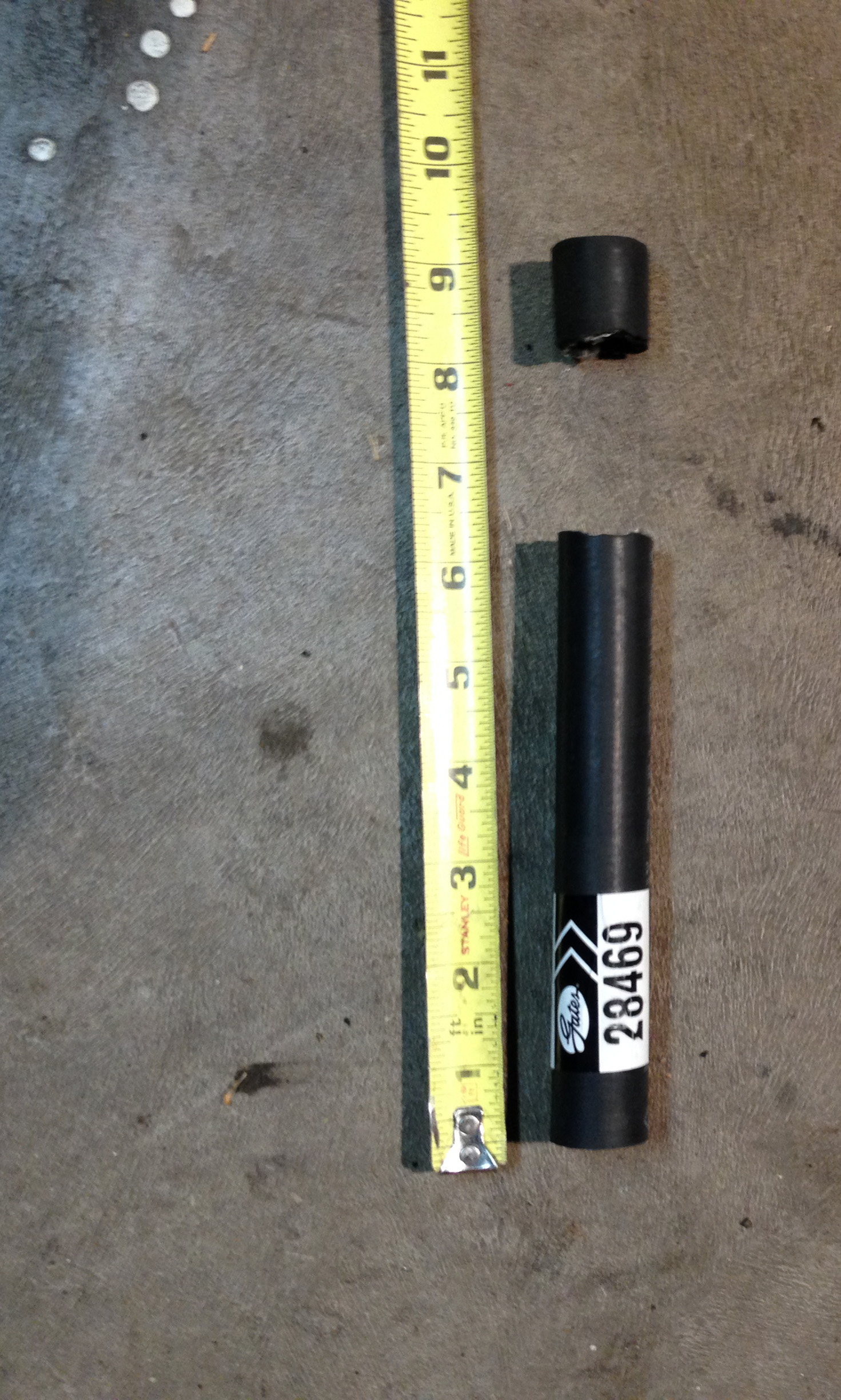

Yes, some info about the smaller vac line is tucked away in the same follow-up post where I suggest re-using the oil trap: Use 5/16 vacuum line for the nipple on the intake manifold. This will be a little big for the nipple at the flame trap, so make sure you have a clamp to tighten it down well at that end. But don't break the fragile, plastic nipple! Generic rubber vacuum hose is great in this application, and cheap.
For the oil trap line, one of the things talked about in that long thread is that the vent has to make a 90˚ bend and there is some risk of cheap heater hose collapsing, a few people have posted about that problem. I would suggest using fuel line or a heavy heater hose. Or even just buy a heater hose that is pre-formed with a 90˚ angle in it, I did one that way last spring, the only catch was I had to use RTV silicone to seal the flame trap housing, I don't remember if that was because the housing was in bad shape already or because of the angle of the heater hose:
Gates 28469 is a quality hose, cost me $14
