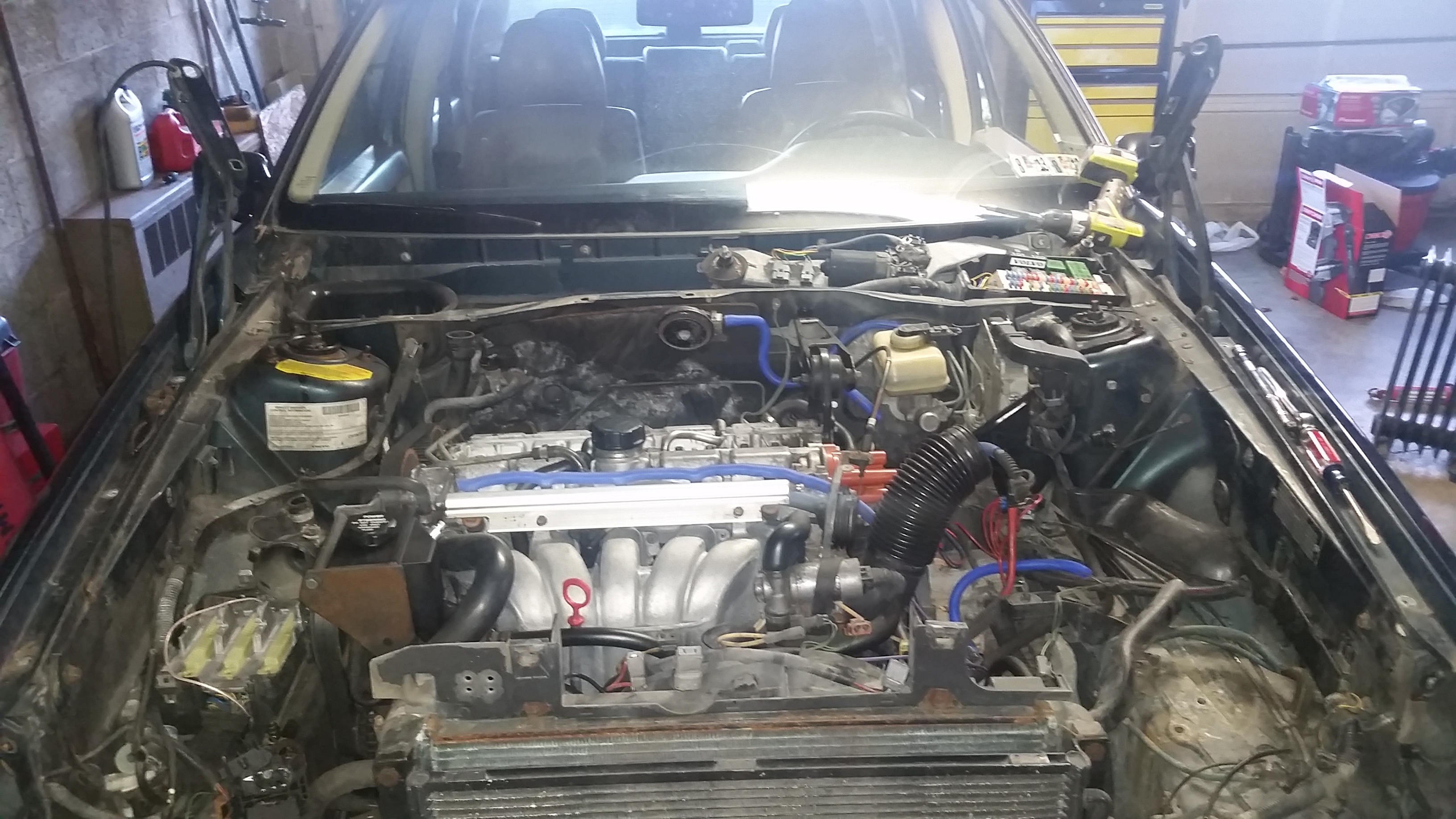

Thanks for all the information! I would like to get some clarification on the engine harness and ECU, is it truly necessary to convert the ECU and harness over? This is a pre-ob2 system, and I was curious if it's needed seeing how I will have it tuned regardless. Also, are lower compression pistons necessary? I haven't heard of that needing done before. Thanks again!

From your pictures you have the Jetronic engine control system and there is no turbo version of that system. You are pretty much on your own with this one. There may be some aftermarket products to provide boost control but it won't be anything stock. The other option is to buy the entire wiring harness and ECU from a turbo car and replace essentially all of the under hood wiring including the ECU box and sockets.
