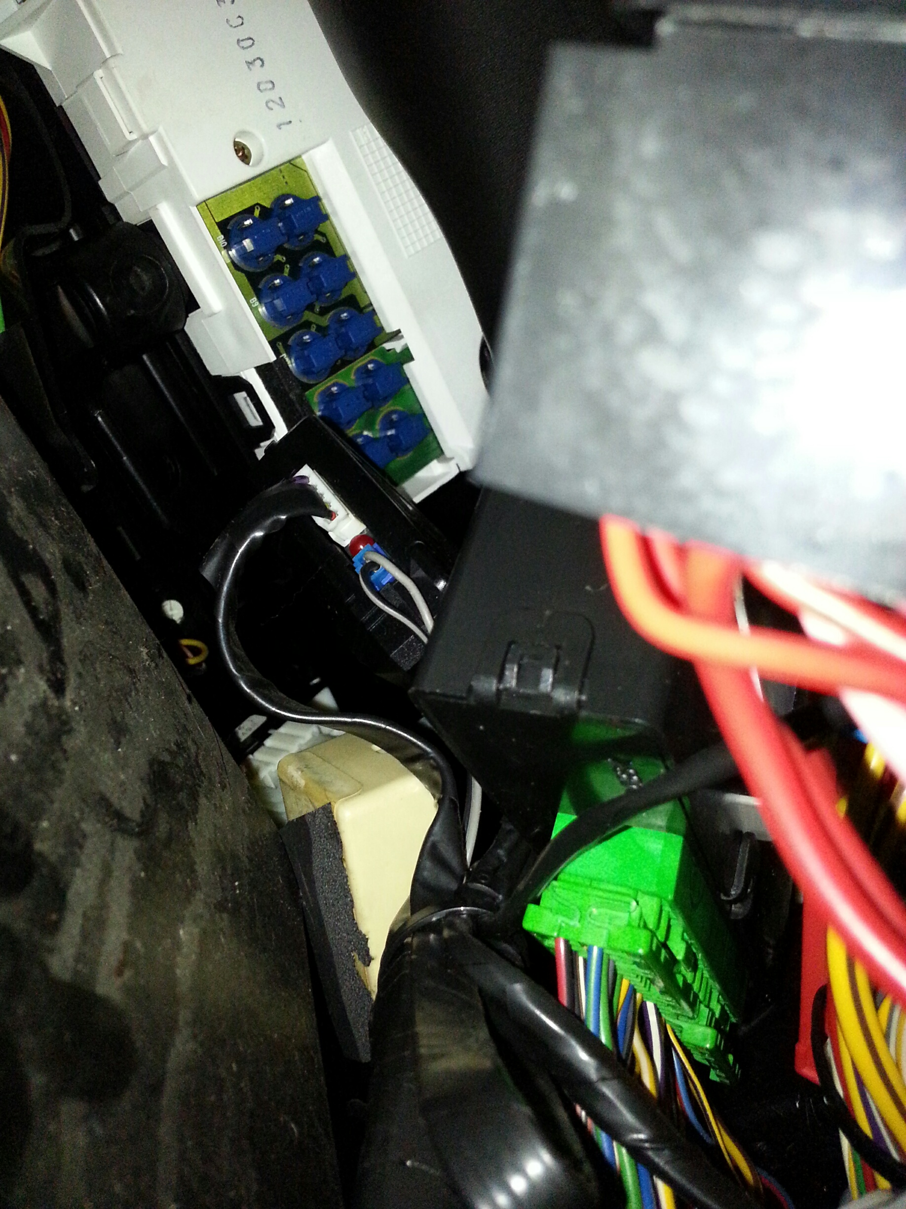

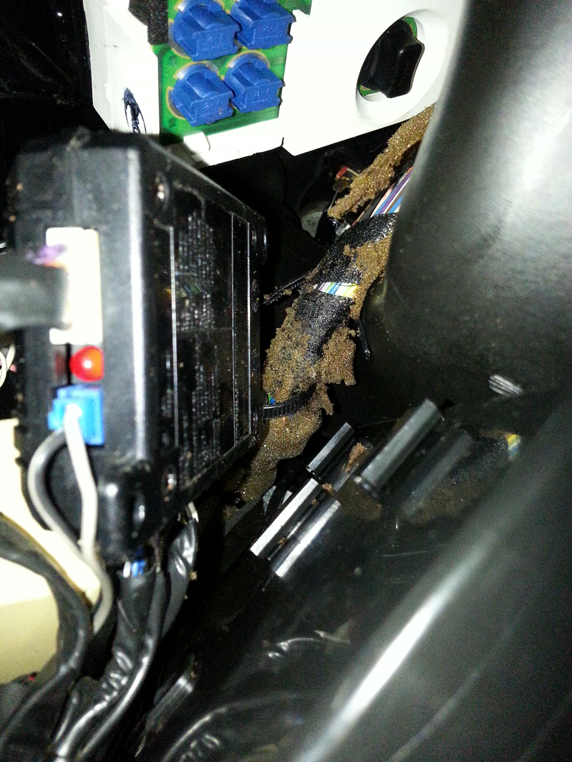

That's what i did with the use suburban i purchased, i actually went to reconnect the battery after working on it, and the truck restarted, i had just changed the oil and transmission fluid, luckily i refilled them before reconnecting the battery haha. I found the unit above the steering colum and ust ordered a new unit with remote already programmed for like $50. I'll check back in with my findings.
shawnmacananny
- Posts: 23
- Joined: 19 Jul 2014, 14:27
- Year and Model: 1998 V70 T5
- Location: Felton, DE

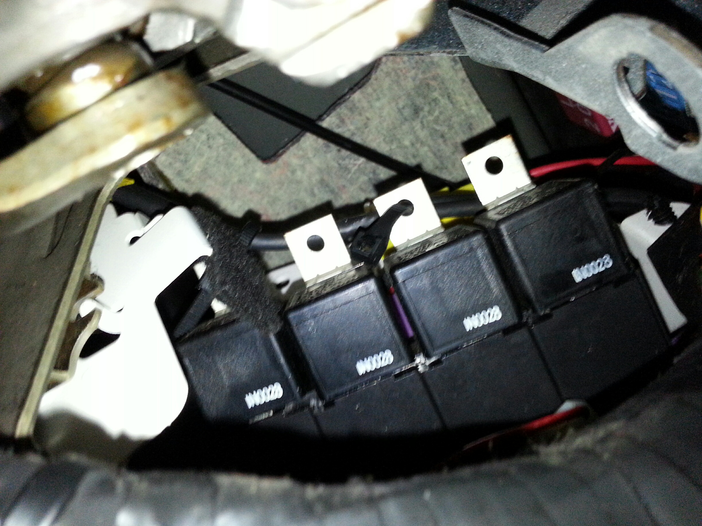

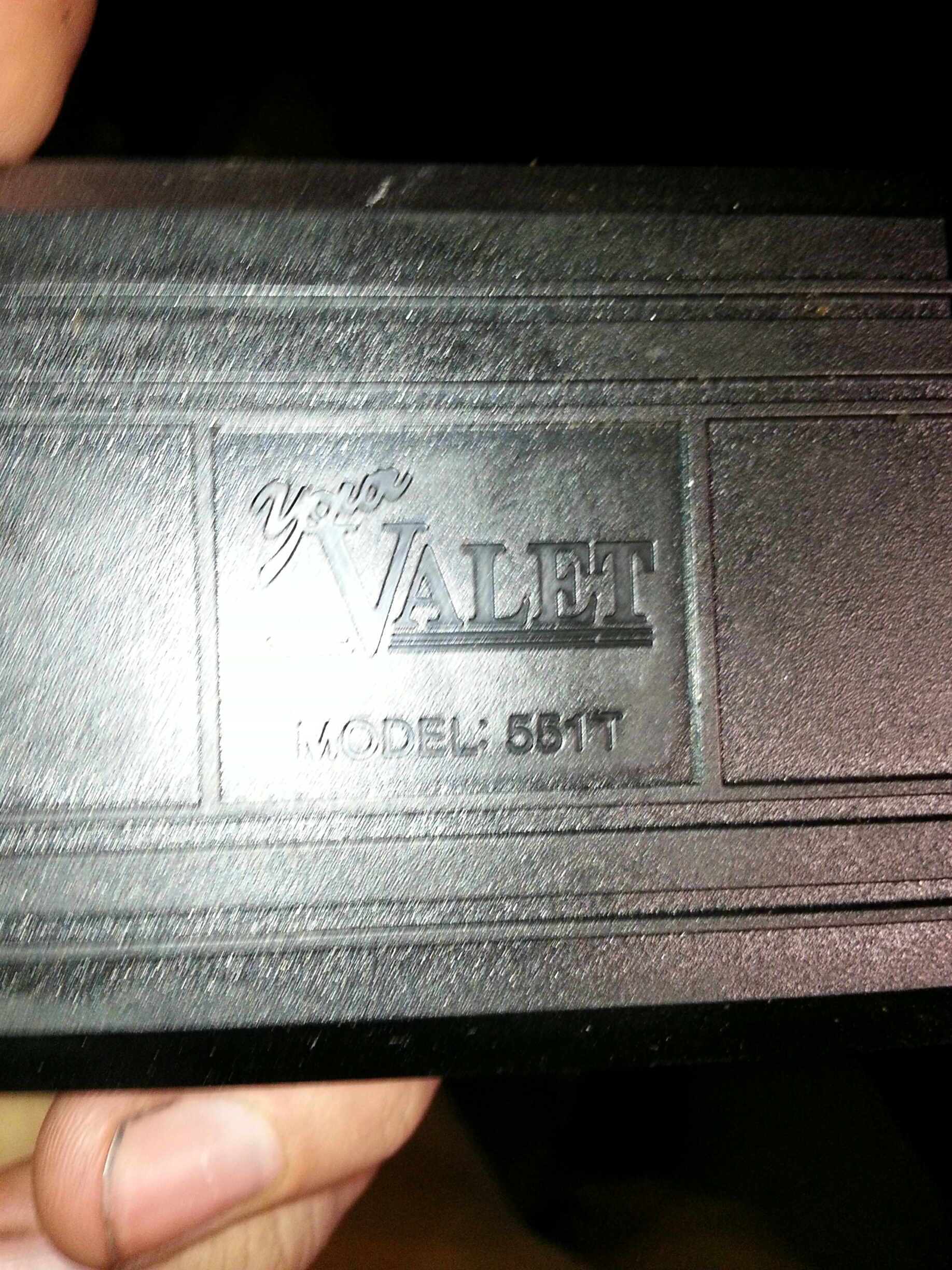

Well you were right, there was a remote start, i saw the aftermarkey relays right away, but man they hid the actual box very far up behind the gauge cluster and even zip tied it to the harness! It was pretty difficult to get off, i really didnt want to take the top of the dash off, i got it though. There was a white box on the steering column too, i wonder if that has something to do with disabling the antitheft? I've located the manual for it but cant seem to find info on programming a new remote to it. I guess ill just have to look to buy an identical unit and plug the box in place.
shawnmacananny
- Posts: 23
well after some research it looks like this is a piggay back type system, i doesnt use a separate fob but rather the door locking action activated by the manufacturers key fob to start the vehicle. I guess ill have to bite the bullet and buy a key fob from volvo and get it programmed. is there any software that will allow me to do this myself? It's a 1998 i am reading its not as bad as 1999+ but cant be done by the user like the 1997s. I do have the dash security light, but i read that it cant be done with my year.
