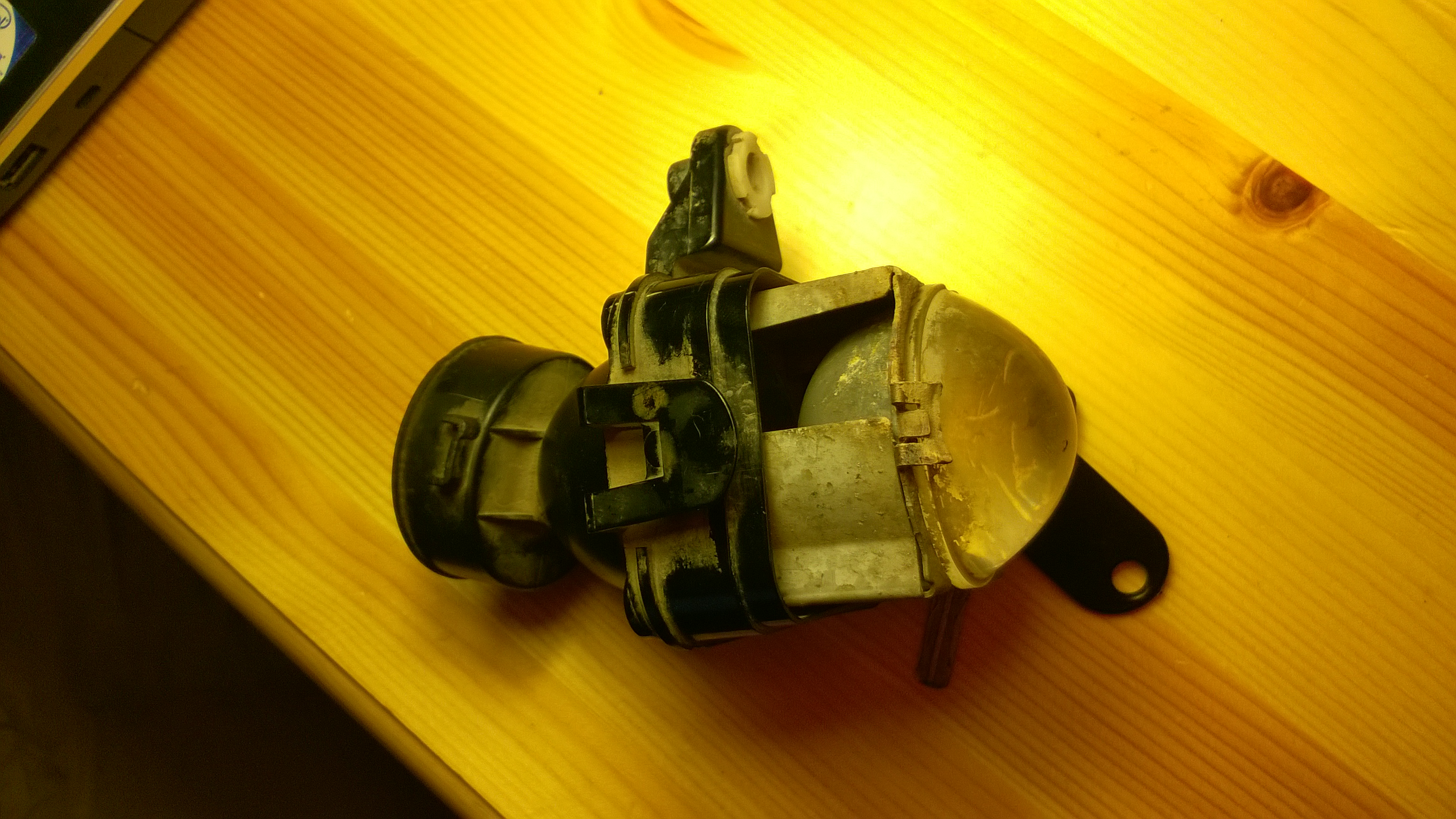

This started with a simple task of replacing a light bulb. Specifically the front passenger fog lamp bulb using the H3-55w from autozone. Ideally this light is disassembled by rotating the plastic housing about an 1/8 turn to reveal the backside of the bulb held in place by a metal clip. The bulb change out is fairly straight forward. This is the first time I have ever had to replace a fog lamp bulb. When I reached to grab the plastic housing, the metal casing that holds the bulb came with it. I have a attached a crude drawing depicting roughly what happened. From what I see underneath, it appears that there are three metal tabs that align to inserts on the metal casing but no matter how hard I push it wont connect. So I'm kind of stuck. Any suggestion would be greatly appreciated.

It practically fell out on its own. I was hoping there was a way to reattach it to the back of the reflector.

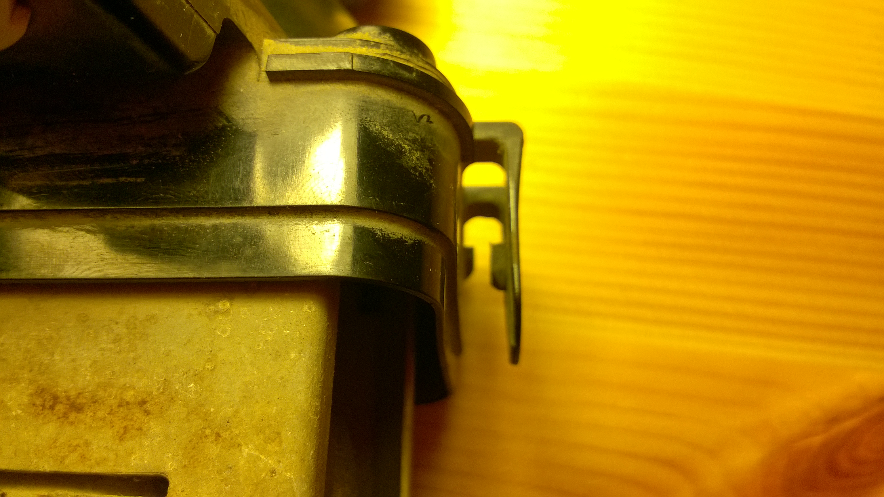

First of all you should try this: place back the weather seal, then the metal casing for the bulb. Note that the metal tabs are not under the casing, and it is aligned that the tabs go to the right place. Now using a small screwdriver you should press on the tabs, so that they fold over the metal casing. I used some superglue there to make sure it holds strong. It should look something like this: If its not strong enough or there is not enough space to do it, you can try to disassemble the whole assembly so there is more space, but first try to do it without pulling it apart. (I had to disassemble the whole thing, but that doesn't mean you can't do it without that

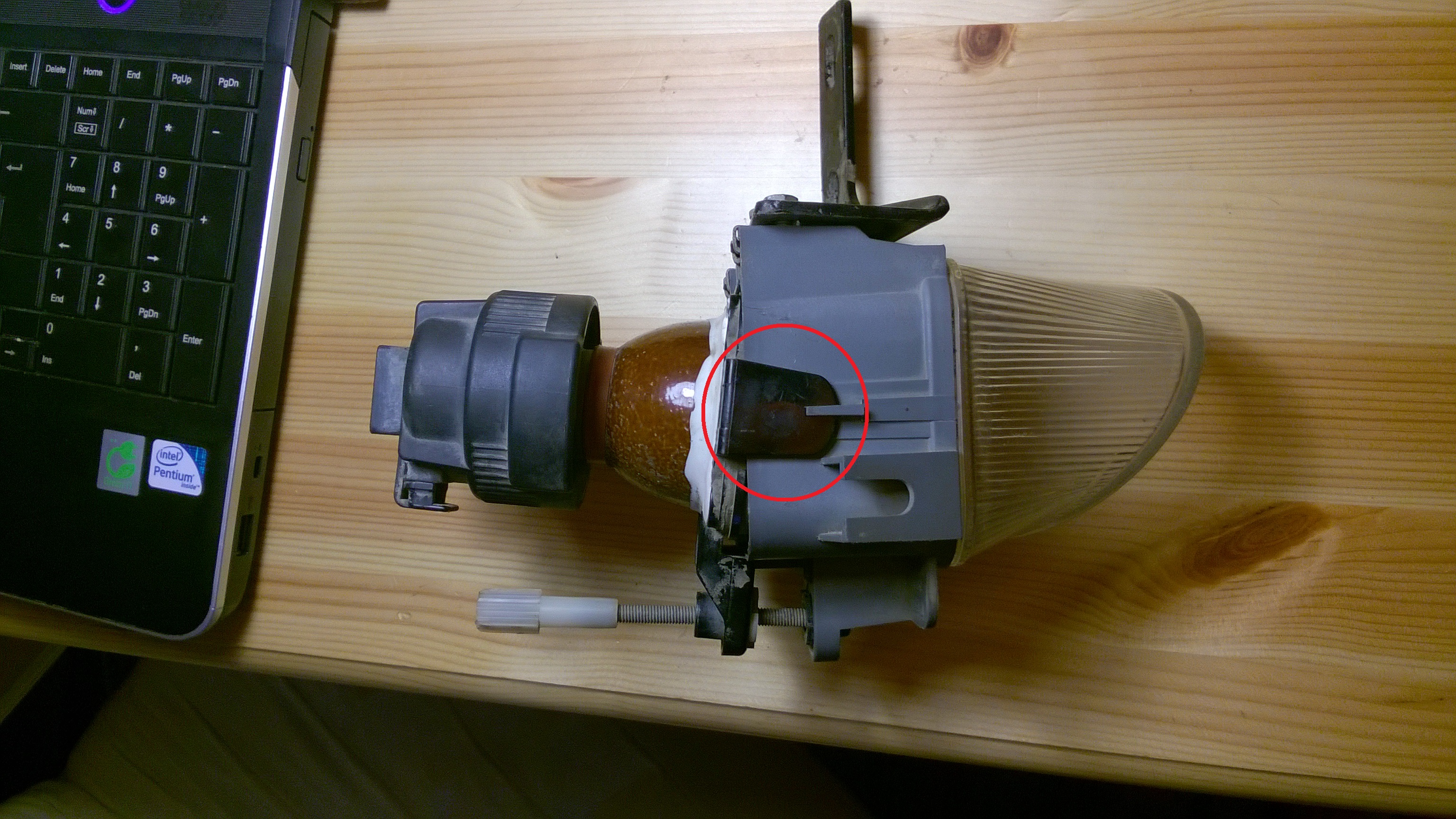

First I used the adjuster screw to tilt down the inner part of the foglight, as far as it let me do it. Then very carefully pried up the black tabs on the side of the light assembly, so the inner part can pop out from the housing. Be very careful because the tabs can break easily.

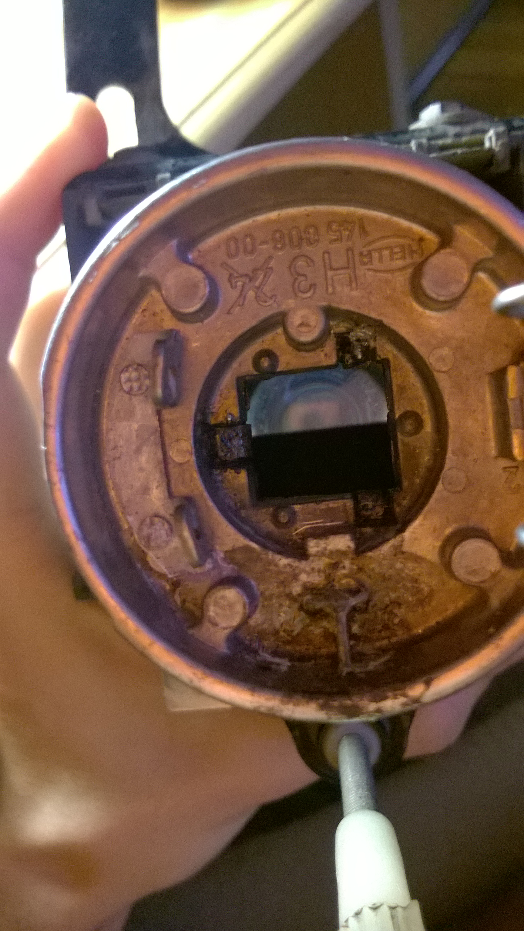

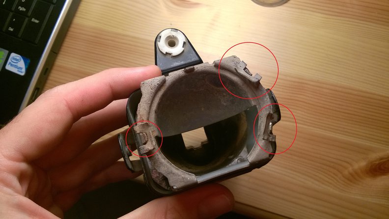

Now using a screwdriver and pliers you can remove the white plastic part from the end of the adjuster screw. You should just hold it with the pliers while turning the adjuster with the screwdriver. As you are turning the adjuster the assembly comes out of the housing. When it is out pry up the three metal tabs holding the lens ( careful to not break the glass or the metal tabs). After the lens is out you can see the three metal tabs that hold the metal casing. Now you can try to fold them back from here. When it is done, you can put it back together, everything is the same as removal just in reverse
Make sure that the lens is clean, there is no grease on it.

Ok, I was able to repair the fog lamp by bending the pins and of it came apart again right away. I then used the super glue and that seems to be holding well. I have however run into a new problem. The electrical connector for the fog lamp is no longer working. I looked inside the plug and the copper terminal for the negative is pushed back and whatever rubber silicone stuff that was holding it in place had disintegrated. I tried pushing the terminal from the back with a screwdriver but it just refuses to stay put and make a connection. I guess i will have to splice a new connector in but I cant seem to find the right replacement. Any thoughts?
