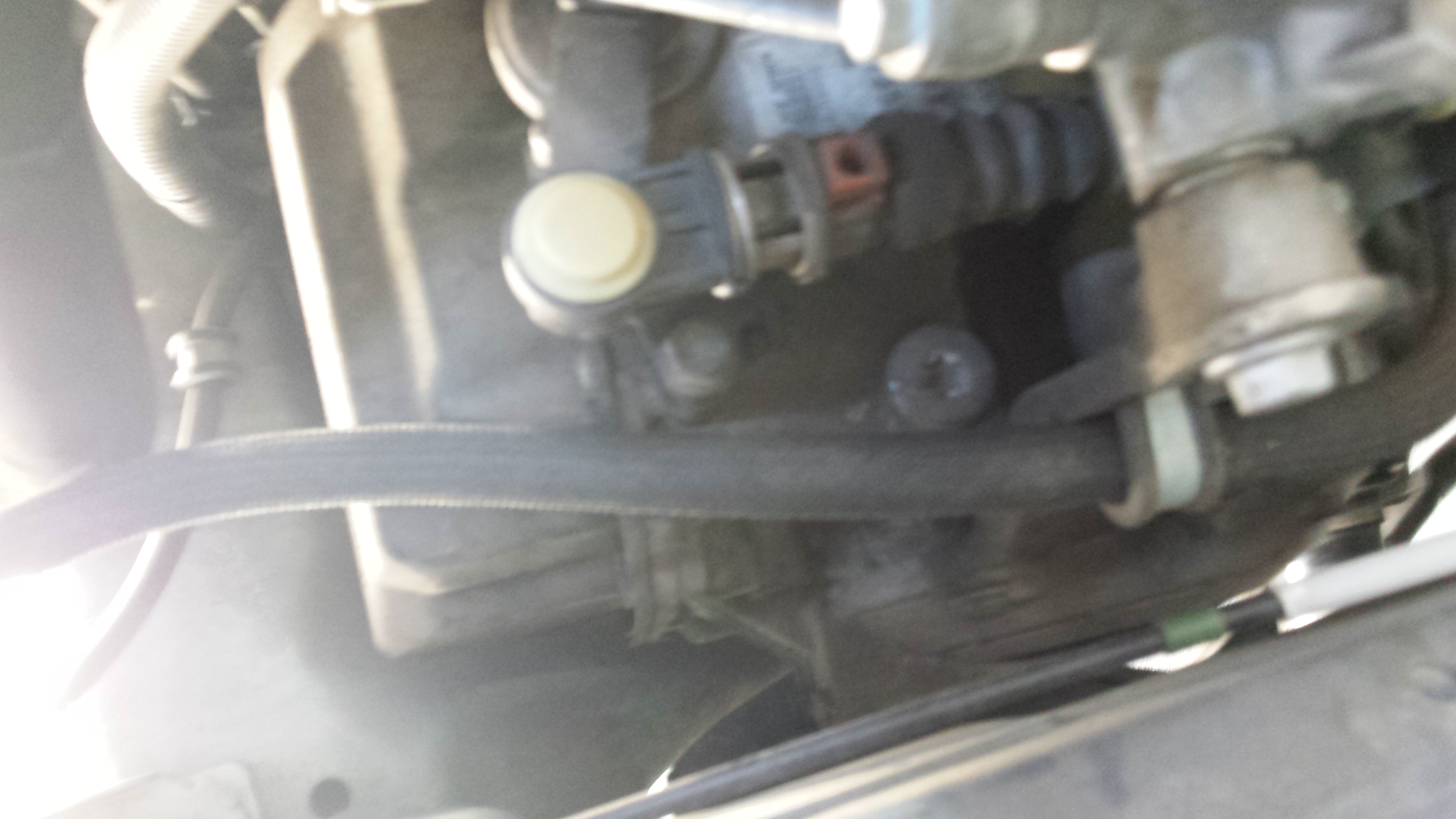

6. Remove the Integrated Level Plug (Torx 40).
Integrated Level Plug.jpg (29.42 KiB) Viewed 22801 times

9. Install Integrated Level Plug, tighten to 8 Nm, reuse o ring, lubricate it with ATF oil.

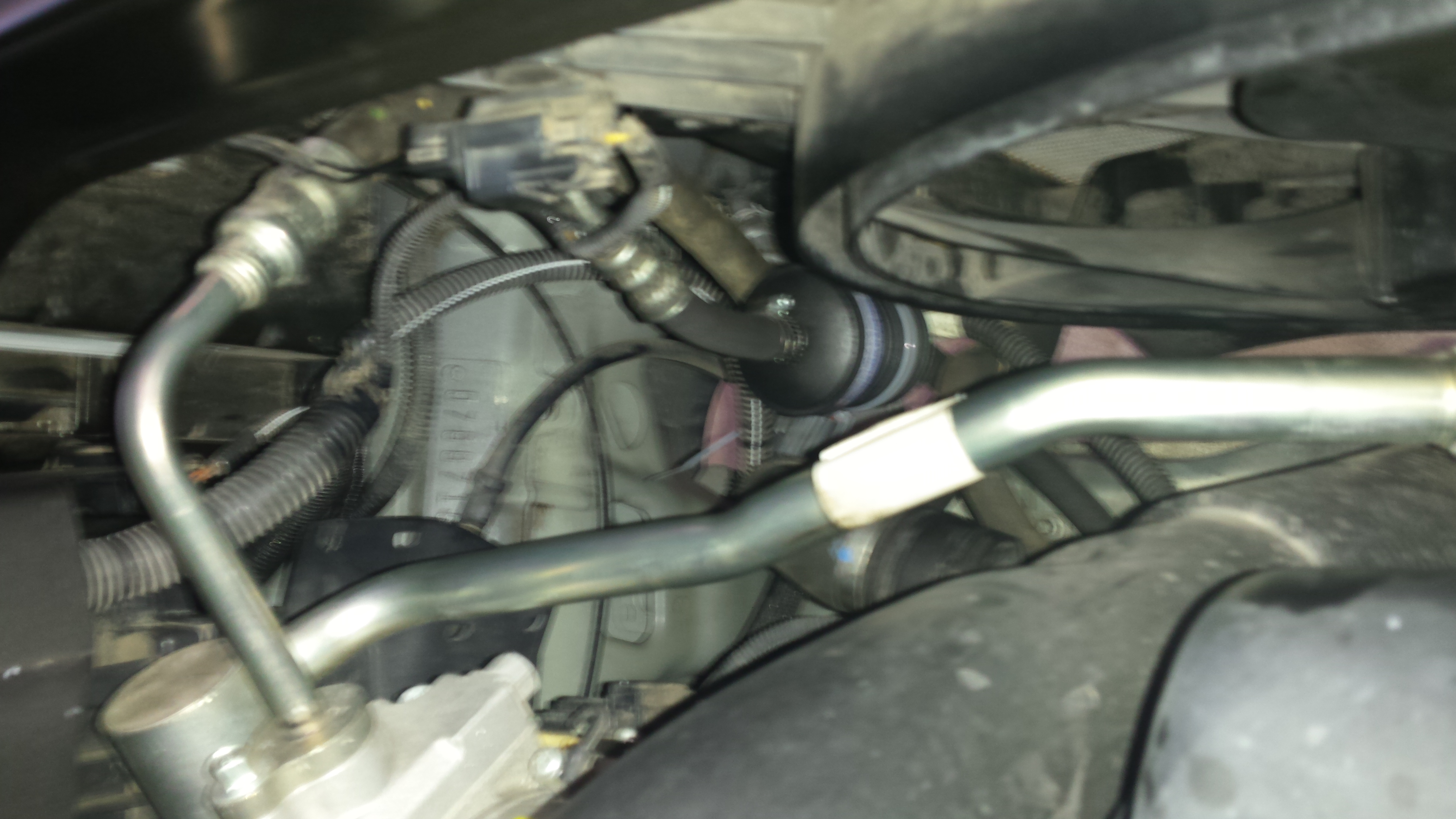

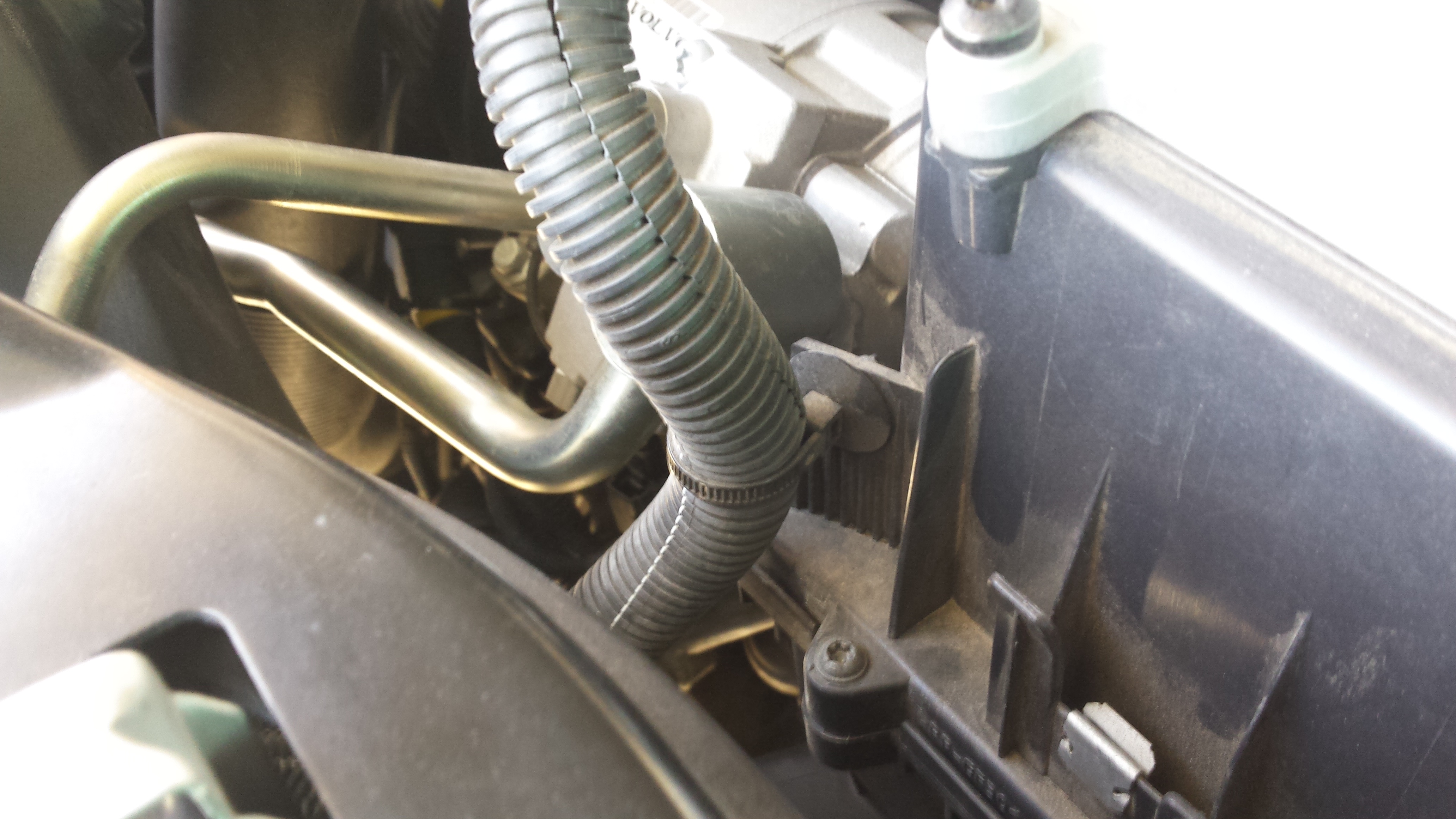

10. Remove the oil cooler's return line from the transmission.
Return Line from Transmission.jpg (15.24 KiB) Viewed 22801 times
11. Remove the oil cooler's return line from the oil cooler.
Return Line from Oil Cooler.jpg (17.63 KiB) Viewed 22801 times
12. Install the return line on the oil cooler as shown.
Install Return Line.jpg (17.17 KiB) Viewed 22801 times
13. Install hose on the return line with a hose clamp.
Hose w Clip.jpg (11.09 KiB) Viewed 22801 times

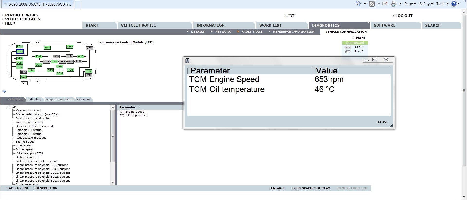

22. Check the oil level. Connect Vida/Dice to monitor fluid temp.
Checking the oil level Connect the diagnostic equipment and read the transmission fluid temperature continuously.
23. Connect positive and negative terminals of the battery. Start the engine. Note! Leave the engine running during the entire check. Note! The following measure must be carried out quickly to avoid overheating the fluid. Run through all the positions between P and D on the gear selector. Stop at each position for at least 2 seconds. Perform this process twice
24. Allow the transmission fluid to heat up to 50° C. Note! The fluid will not heat up faster by stalling.
25. Place a lower drip shield on the floor under the vehicle. While the engine is running, remove the integrated level plug (TORX 40). Allow the excess fluid to run out.

Btw. There is a way to check the level of the fluid. You must have a diagnostic tool (Vida ) to monitor the oil temperature.
oil level check.pdf
(172.62 KiB) Downloaded 771 times
