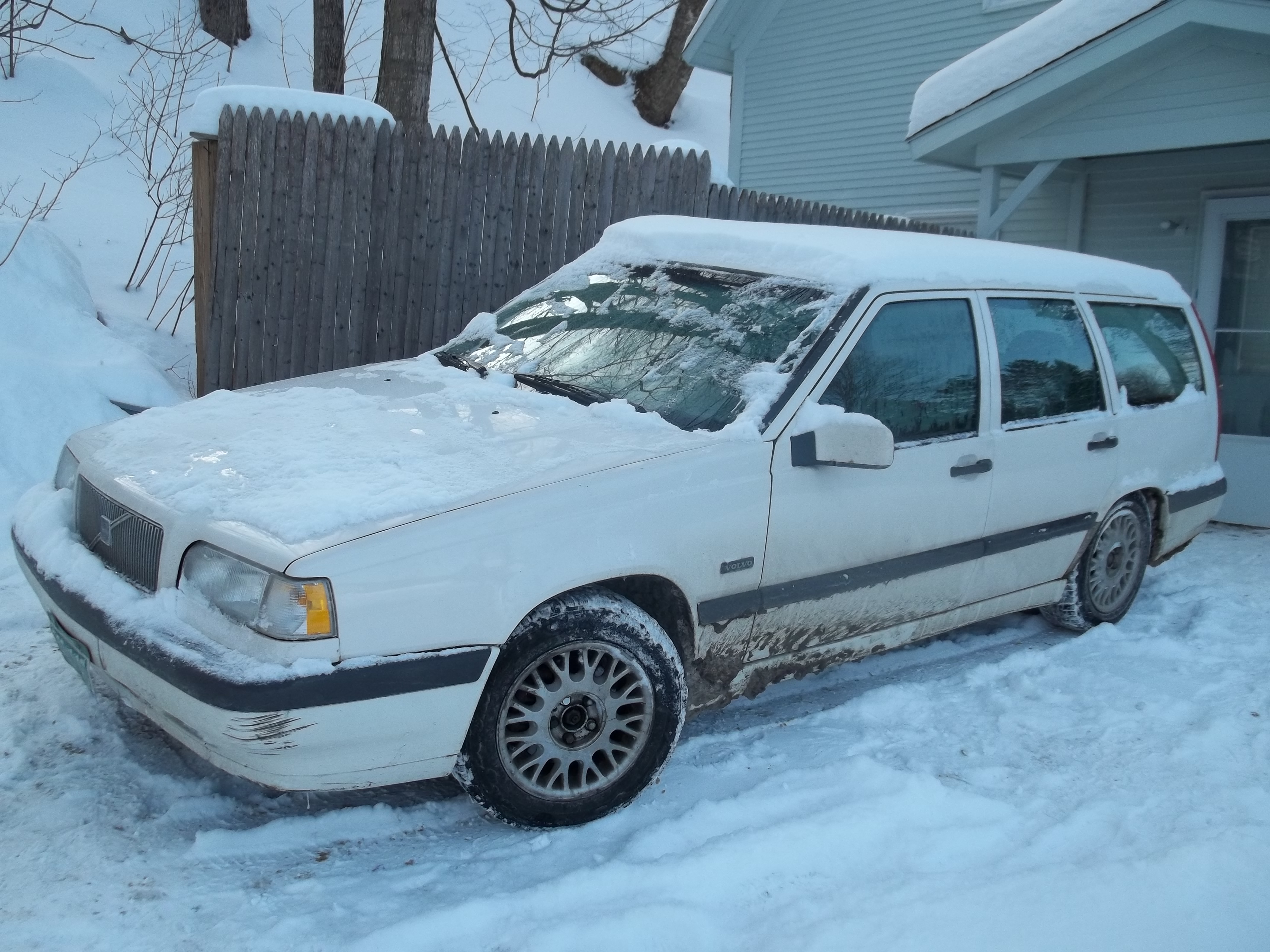

Here's my Baby you all deserve to see her...
