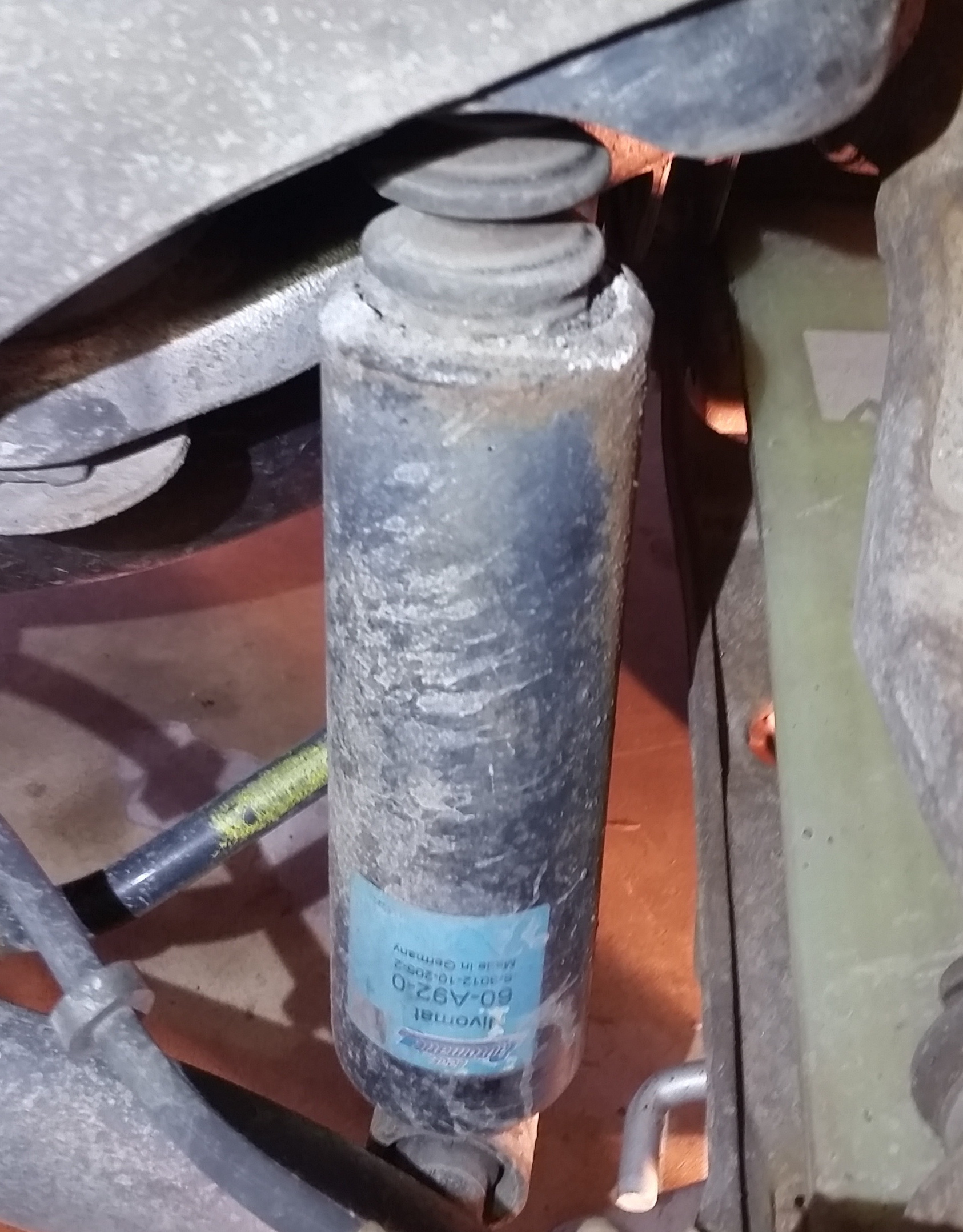

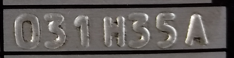

And this is the nivomat, on my car. And the "H" on my product plate.

schoolhousejulie wrote:And this is the nivomat, on my car. And the "H" on my product plate.
Your picture shows Boge 60-A92-0 Automatic Nivomat Shock Absorber. I'm still researching the product plate.
Boge 60-A92-0 Direct interchange:
Havam KS4092
Sachs 444 092
Sachs 89 4104 444 092
Volvo 271897
Volvo 271898
Volvo 272209
Volvo 9173202
Fits Volvo 94-96 960 wagon, 97-98 Volvo V90.
No luck with the product plate info for 960, S90, V90.
1988 Volvo 760 Turbo Wagon

Bit of Info I found on Brickboard stated that 4th digit to the right is shock code. It also stated that H should be "MARKED V" if it has nivomats.
Examine the shock I posted...one end is different.
From your pic, it appears one end has the round hole, and the other end with a vertical "stud."
But, websites do post generic pics sometimes.

lummert wrote: Boge 60-A92-0 Direct interchange:

Great! So I'm good. Thank you! I haven't had to do too much in depth parts searching before, so I don't really know all the nooks and crannies to search in for something like this.
lummert wrote:It also stated that H should be "MARKED V" if it has nivomats.
Ah! okay, so it sounds like it's a bit of a glitch then? That's what has been so confusing! I mean, I seriously had one guy tell me that "H" just doesn't exist, and that it had to be a "K" and I just wasn't reading it right. But that's definitely an "H."
93Regina wrote:From your pic, it appears one end has the round hole, and the other end with a vertical "stud."
I made sure to get a good look up in there with a flashlight, it has the round mount on the other end too.
