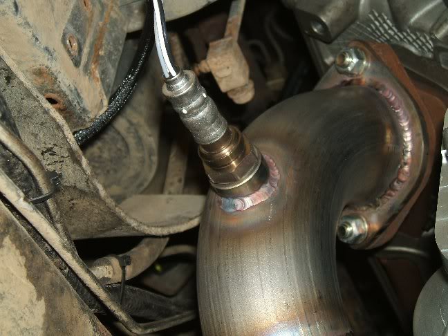

Thanks for the advice. I have no welding tools. I could try the map gas to heat up the "bung". What is this "bung", BTW ?
Thanks.

Bung is the piece of metal that has the threads for the O2 sensor to screw into. The bung is welded to the pipe so you can insert the O2 sensor into it.
welded in bung.jpg (55.94 KiB) Viewed 770 times

JDS60R wrote:Bung is the piece of metal that has the threads for the O2 sensor to screw into. The bung is welded to the pipe so you can insert the O2 sensor into it.
Great picture and explanation. Thanks :D
