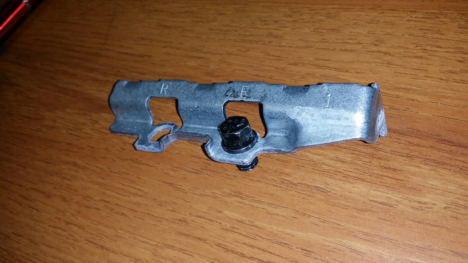

Had a good look at the cable on top of gearbox under the battery box found this metal piece (source unknown) not allowing the cable to move freely. Reached in pulled it out, and things are back to how they should be.
anyone know where this came from?? looks like a battery bracket.

Yep, it's the battery hold down.
Here is a photos of the same in new condition.
