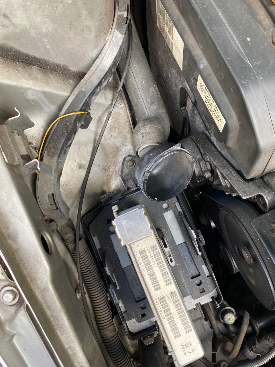

Taking off the ECU cover and loosening or removing the bolt under the coolant tank is worth the extra time. The welded nut on mine broke so I couldn't remove, but it was loose enough to give me extra room to access the tensioner.
