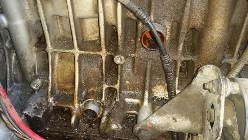

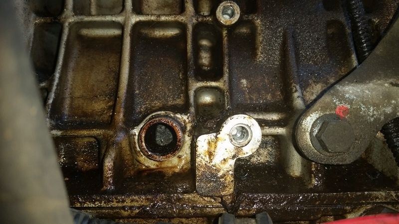

Have been taking apart things slowly and closely inspecting to try to find clues of what all is leaking. As you'll see in the following pictures everything is covered in oil so it's not always completely obvious what is coming from where.

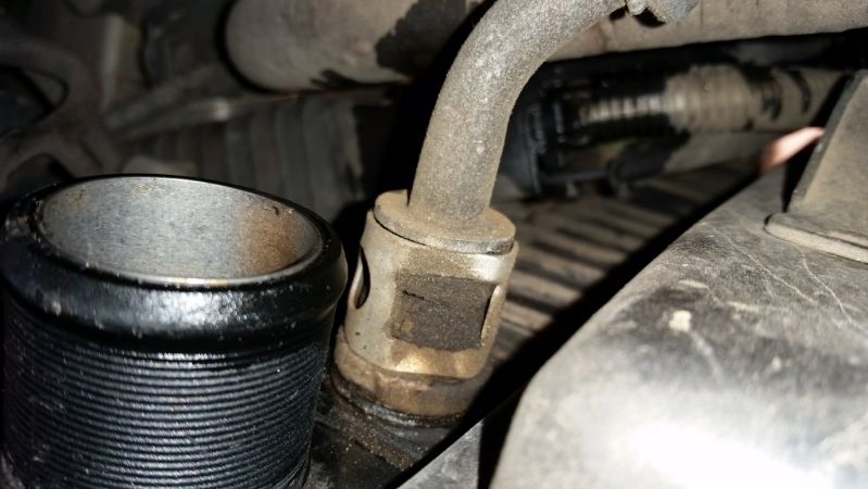

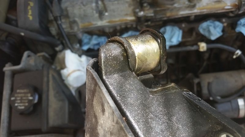

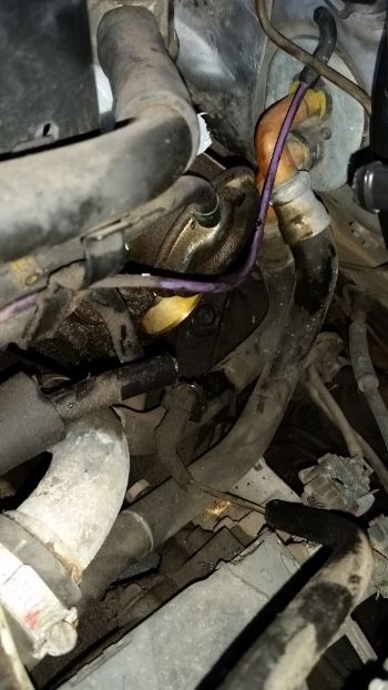

I've drained the coolant in preparation to possibly replace the radiator. Upon closer inspection where I thought the upper radiator hose was leaking, it looks more like the oil cooler line just below was leaking. Any opinions based on the pictures are encouraged.

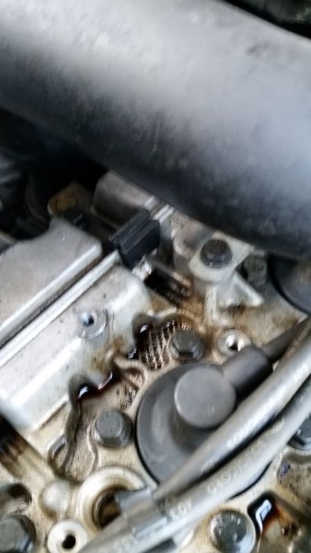

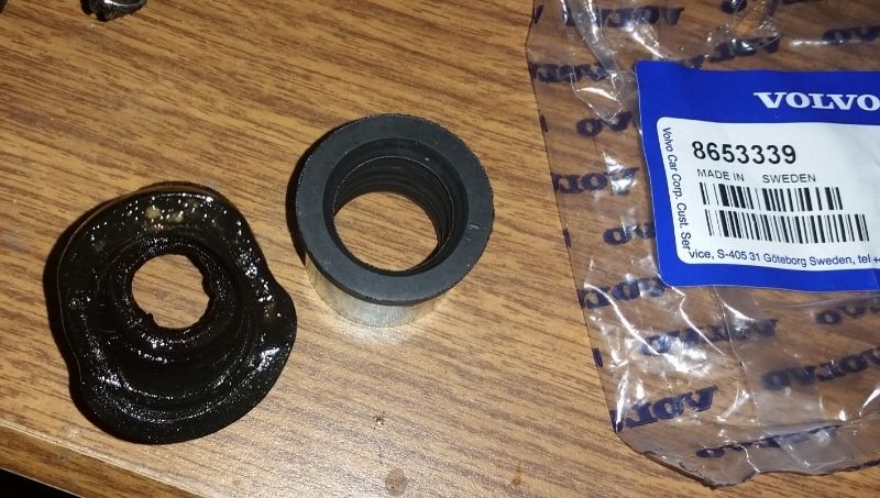

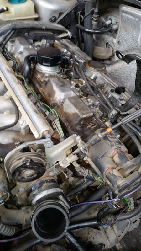

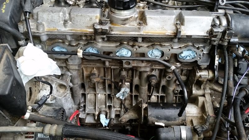

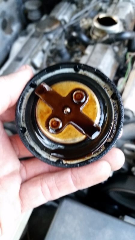

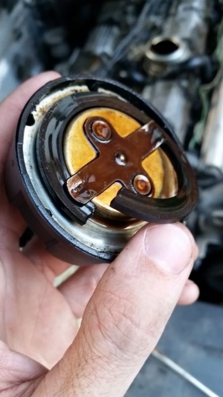

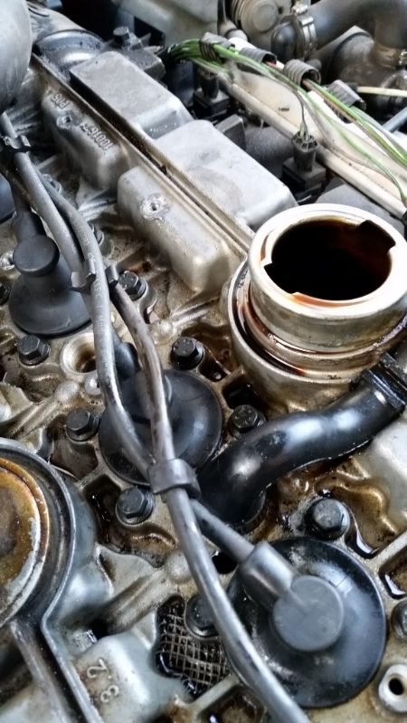

evidence of massive oil loss from oil filler cap. >.< the cam cover had sooooo much oil pooling on top and flowing off to the back of the engine above the turbo... pictures do not reflect how much oil was up there when I first took the spark plug cover off.

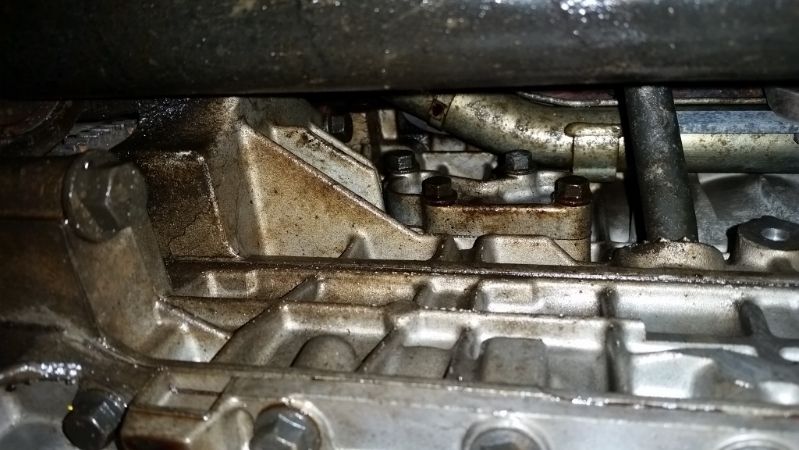

the path the oil was taking down the back of the engine:

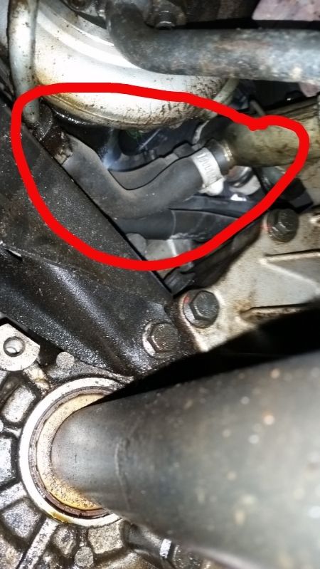

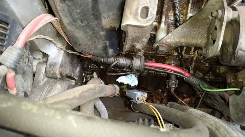

**Do the two hoses shown here look like they are close to failure? I am trying to find these hoses on IPD and FCP and cannot seem to find a place to buy replacements**

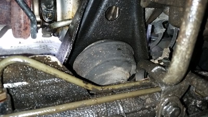

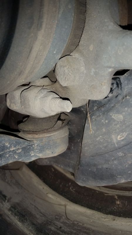

Bonus bad ball joint shot:

The oil cap gasket is obviously a problem and you have a handle on that. The lines to and from the intercooler look typical. The coolant line to the turbo looks iffy and that is a line that has a tendency to blow at an inopportune time. I think the part number is 9471700 but check that for fit on your year and engine. That is from my '99 and it may be different on your '98.
The oil return line on your turbo is leaking pretty badly and the oil below the engine is due to that. I can't tell much from the radiator pictures but new orings and clamps for the oil lines are fairly inexpensive. You should be able to get them through any CarQuest auto parts via the World Pac line.
The ball joint, if it isn't already bad is going to be bad fairly soon so budget for a replacement control arm. I use either Lemforder or Meyle HD arms and I avoid the real cheap control arms since I don't really enjoy changing them. The cheap arms tend to last under a year even with good boots whereas a good quality replacement will last 100k miles or so.

I would replace that coolant supply to the turbo. The part info is in the video.

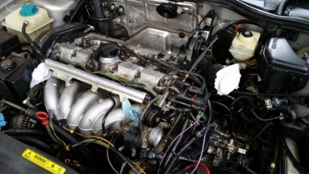

A bit more progress and a few more questions for the experts:
Have been slowly taking things apart, cleaning and taking lots of pictures to help me remember how everything goes together..

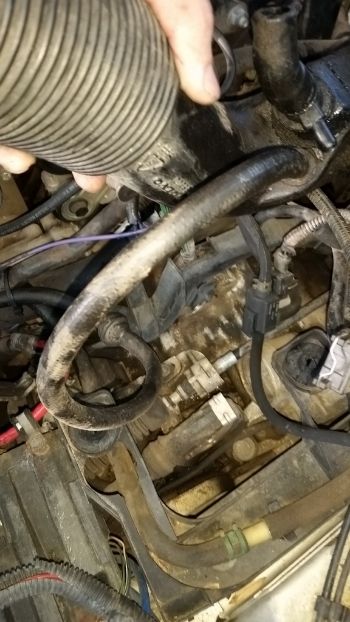

The turbo intake pipe was such a pain to get out...along with everything else back there

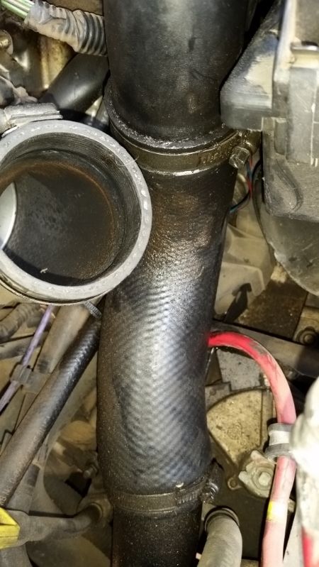

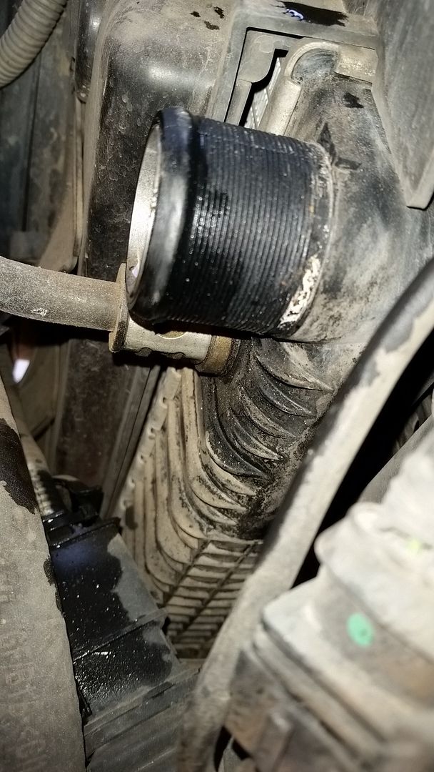

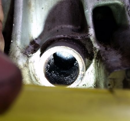

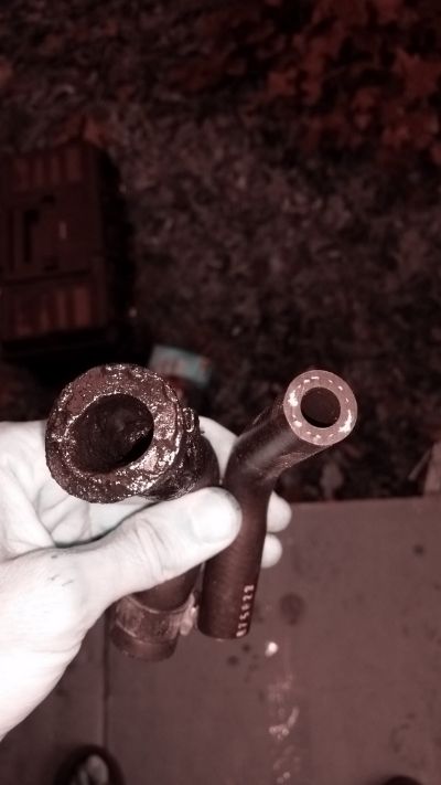

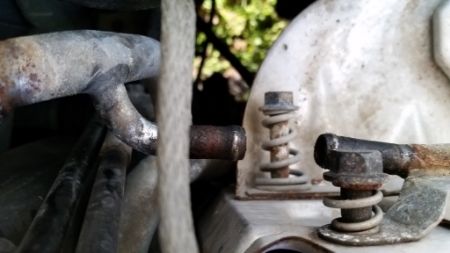

check out the crud inside the lower rad hose inlet to the block! this stuff looked like it could be wiped out but in fact is kind of caked..

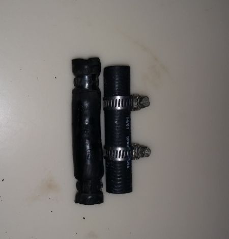

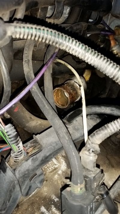

the little coolant connector hose off:

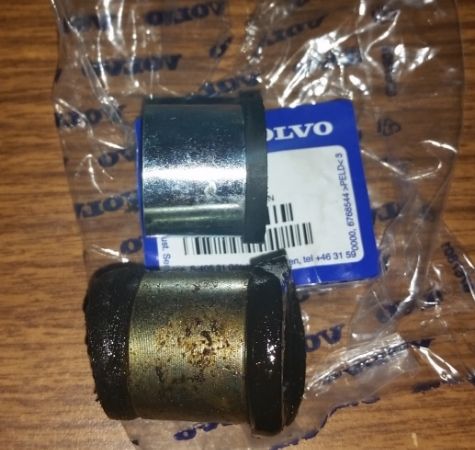

the sunuvab*tch turbo coolant hose off. I can reuse this right? lol this thing felt like silly puddy almost

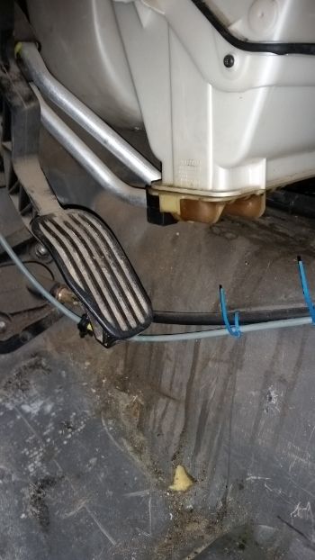

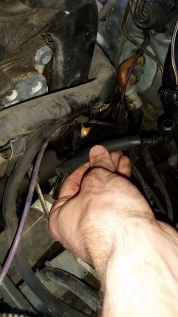

Lastly, I'm thinking about getting a new heater core and doing the heater hose coupler bypass mod. I have had the "sweet" smell whenever my heat comes on for some time now. Any opinions? From what I have read this system is overly complicated and the elimination of the firewall coupler thing doesn't look that difficult and is much cheaper to maintain.
To me this picture shows evidence of some leakage from some component in there
Like I said in the beginning, when I start this sort of thing I like to be thorough, so I'm thinking of doing all coolant hoses while I'm at this. Hoping a coolant flush can take care of the nasty nasty that's caked/corroded onto all the metal coolant lines.

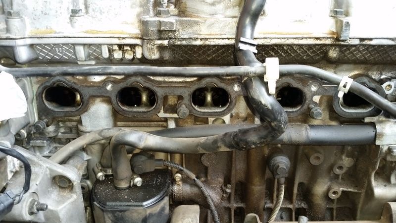

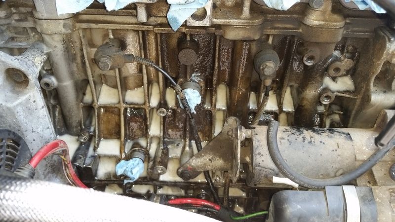

Got into the PCV system last weekend:
applied the degreaser stuff taking care to avoid spraying already tired electrical bits
ahhh. not perfect but gettin there.
as it turns out I do not, in fact, have the rare brown block edition of the white block
next up is the bottom port to oil separator. I'm thinking a seafoam and water solution + medium hard brush-type thing to clean this without knocking the crud back into the engine??

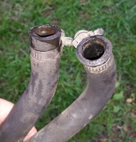

these are the engine side heater core hoses. I'm thinking I'll replace these. Not failed yet but while I'm back there...
In my previous post I showed a picture of what looks like remnants of coolant leakage from either the firewall junction for the heater hoses or the heater core assembly box thing...Any opinions on this?

Reminder on the heater core to wash thoroughly before installation. Many have an oil coating from the factory. Warm soapy water, or several passes through the dishwasher until smell is gone, otherwise you will long for the day when it only smelled like maple syrup.
This is high on the list of mistakes I tell other people not to make.

Don't sweat Getting a little crud into the engine Neal. From the sump the strainer will get the big bits, and the oil filter the rest. It's not exactly a surgical suite in there. I'm used to air cooled VW where you get metal sludge in the sump every 3000 miles!
No URO hoses please. Bite the bullet, pay for the best and cry once.
