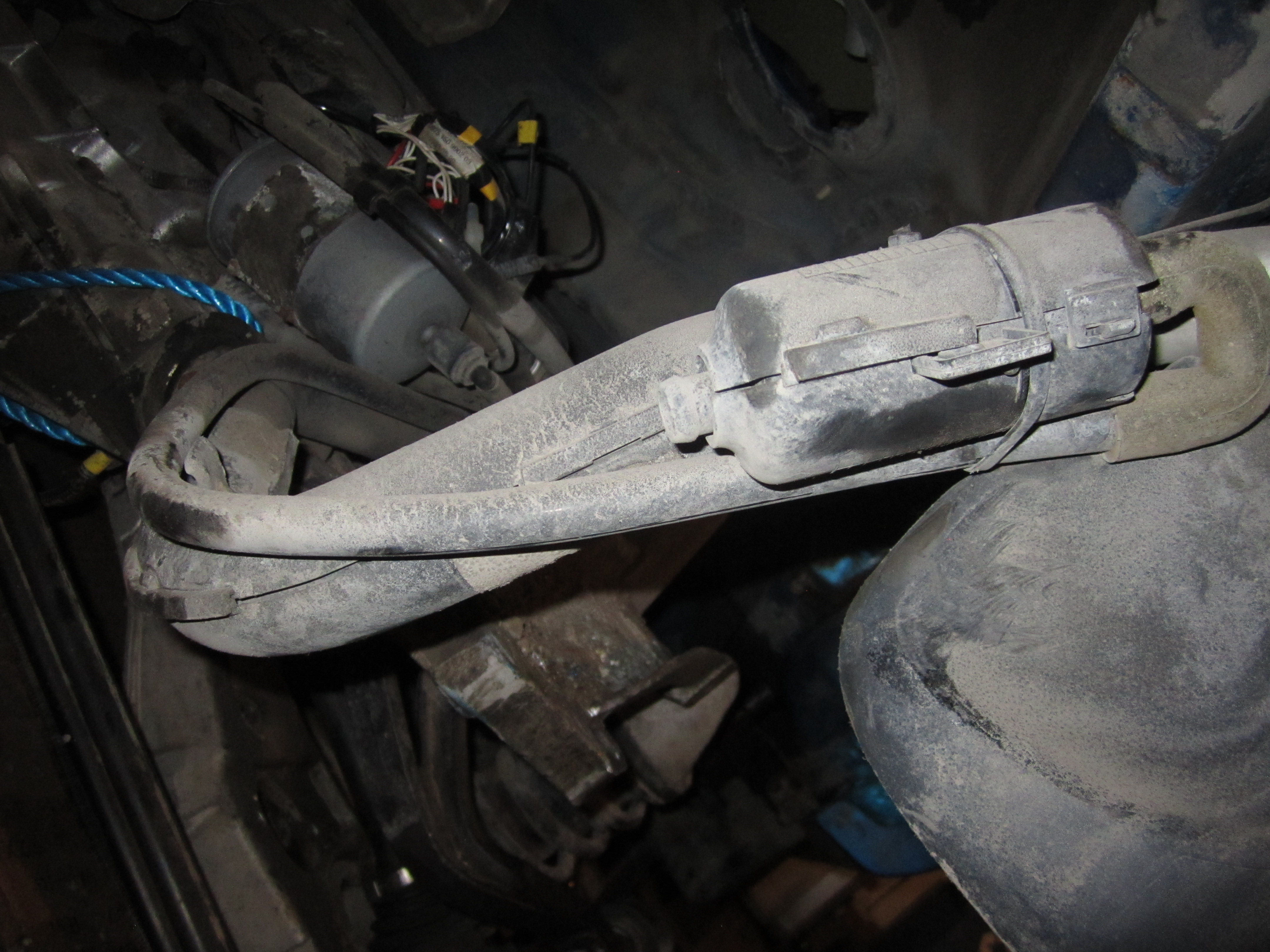

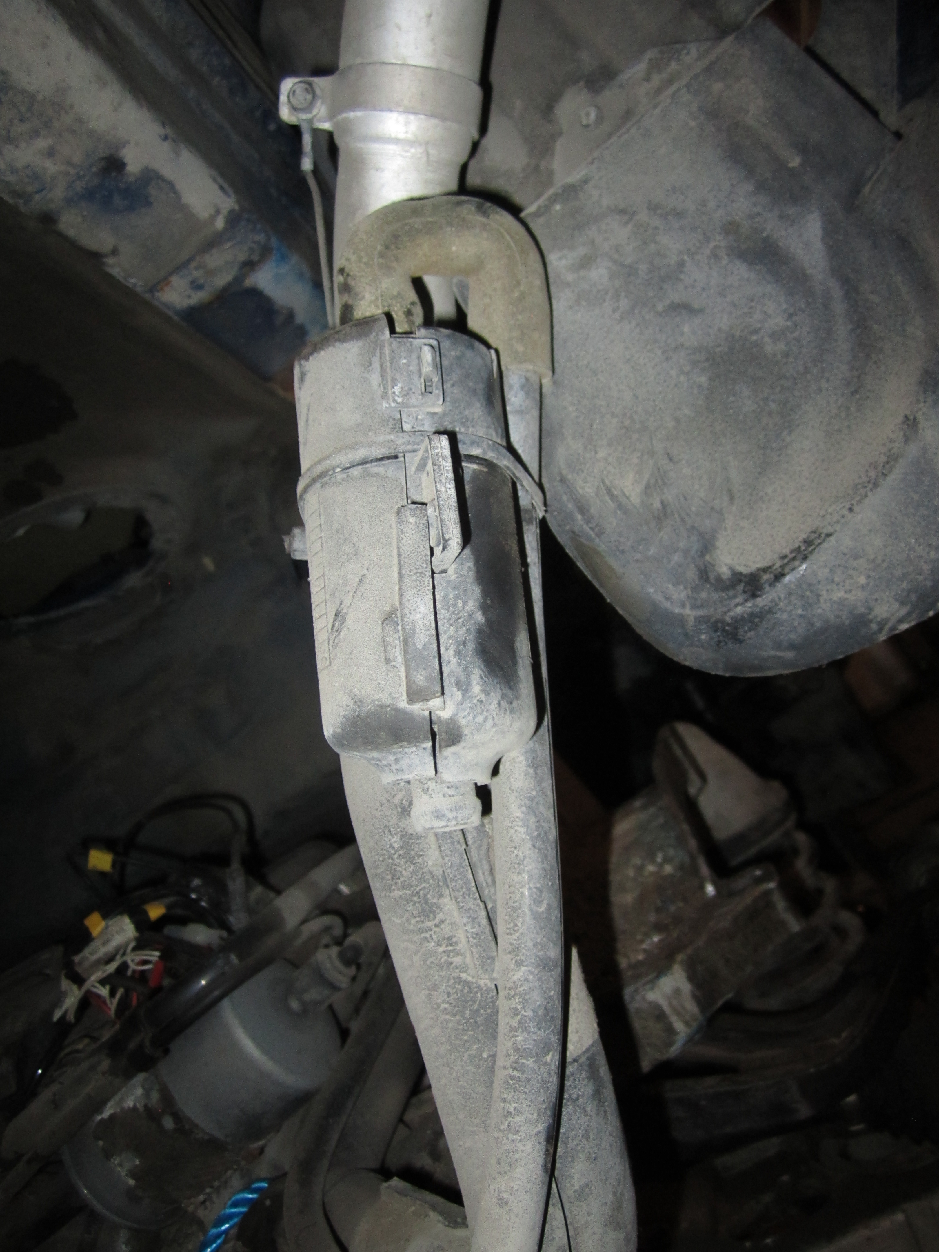

This is your lucky day! This area sounded familiar and as I have just dropped the rear sub-frame and fuel tank/filler on my 2000 R, it was easy for me to go take a quick few photos for you both to discuss.
The can is I believe the shut-off valve. Pipe from filler neck can is the one entering from the lower right of the picture.

Thank you Neil, the pics are perfect. The 2nd and 3rd pic are great shots of the canister I am talking about. The nipple on the bottom is where the air blows out of when I pressurize the tank. Car runs great and fuel mileage is 28-30 mpg. No issues refueling either.

I'm not sure on the operation of this part, but I believe it may be vented to atmosphere so that as you fill the car, it does not over-flow. There is no pipe attached to the bottom of it and it is called an air filter. So I suspect the part is operating as it should, but perhaps someone else can advise if there is a one way valve in there so when the evap system checks for leaks, it is not holding a vacuum. But then this could be true of any part of the system.
Sorry, can't help more as I'm not experienced enough on how all the parts of the system work.

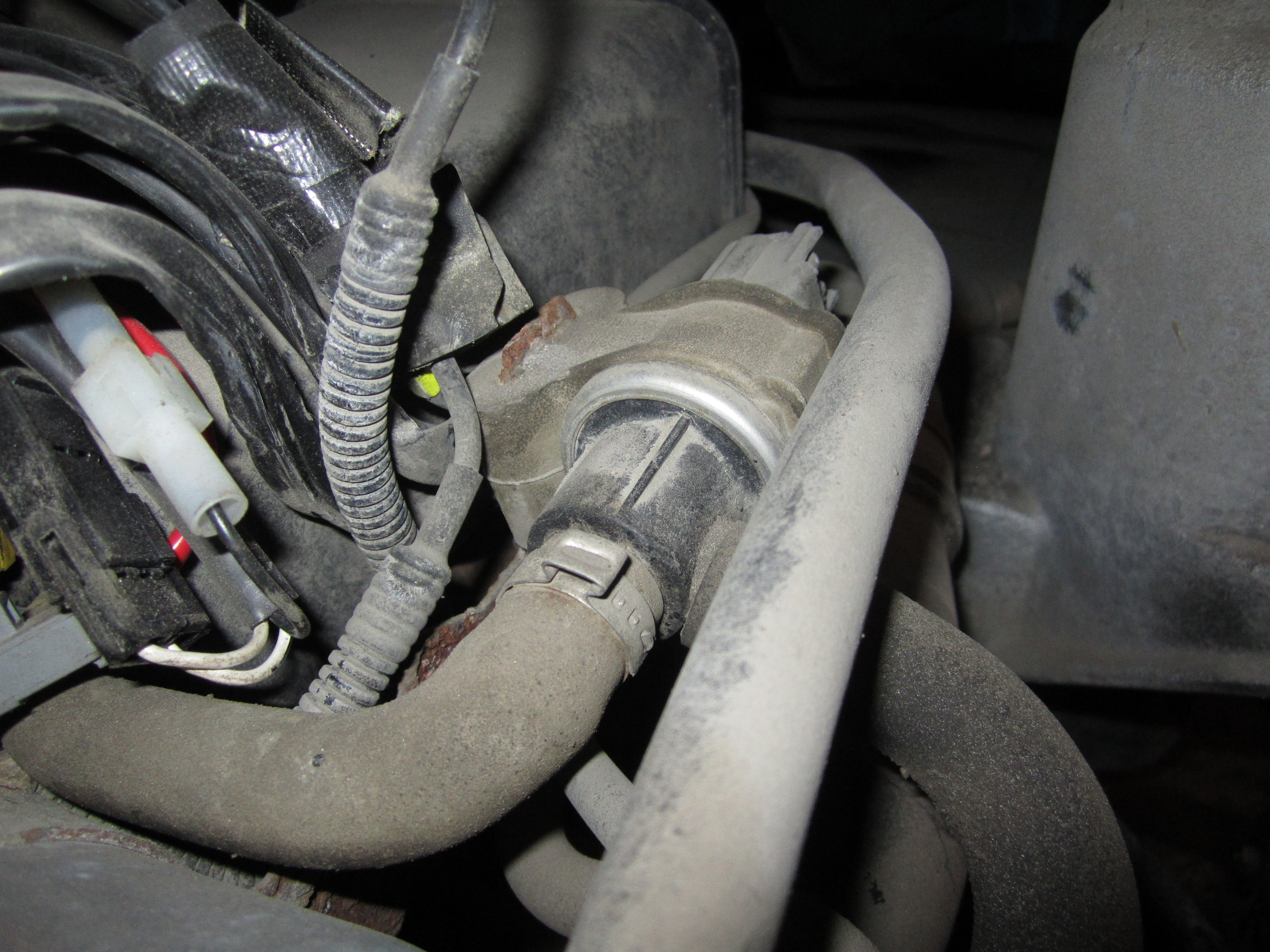

I also tested the evap control valve and with an external 12v, it opened and closed perfectly, but with engine running and the cars connector attached, the valve doesnt close. Checking the pins for voltage showed 8.5v. I havn't traced the wires back yet, I thought the valve needed 12v and got it when the engine is running. Can anyone shed some light on that? Thanks.

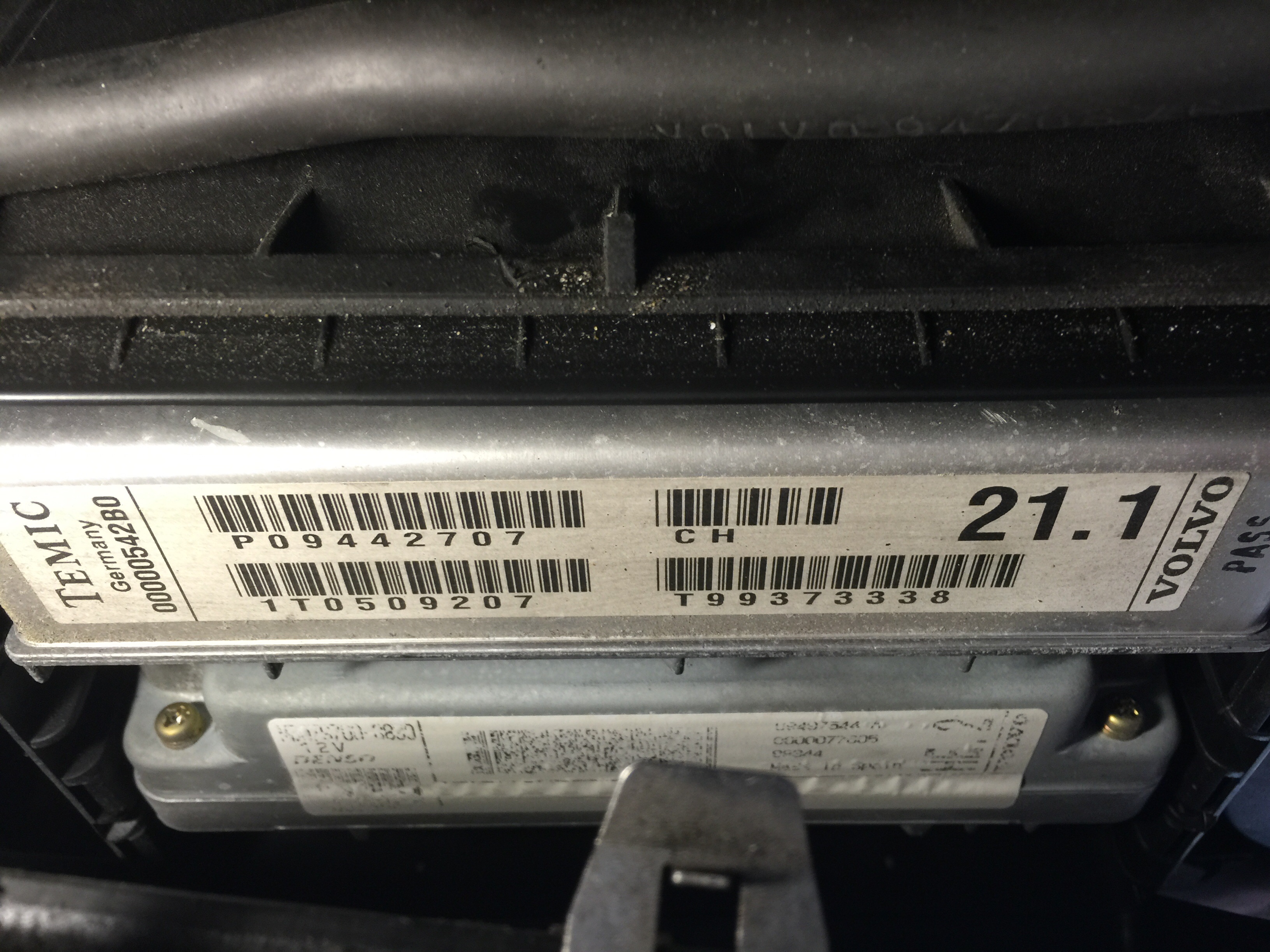

Is this a turbo or a N/A car? Do you have any idea which ECU you have?
Typically the ECU controls the purge valve but I don't know if it supplies the voltage or goes to ground to complete the circuit to activate it. Most of the time it is the latter but knowing which ECU you have will get me to the correct schematic.
