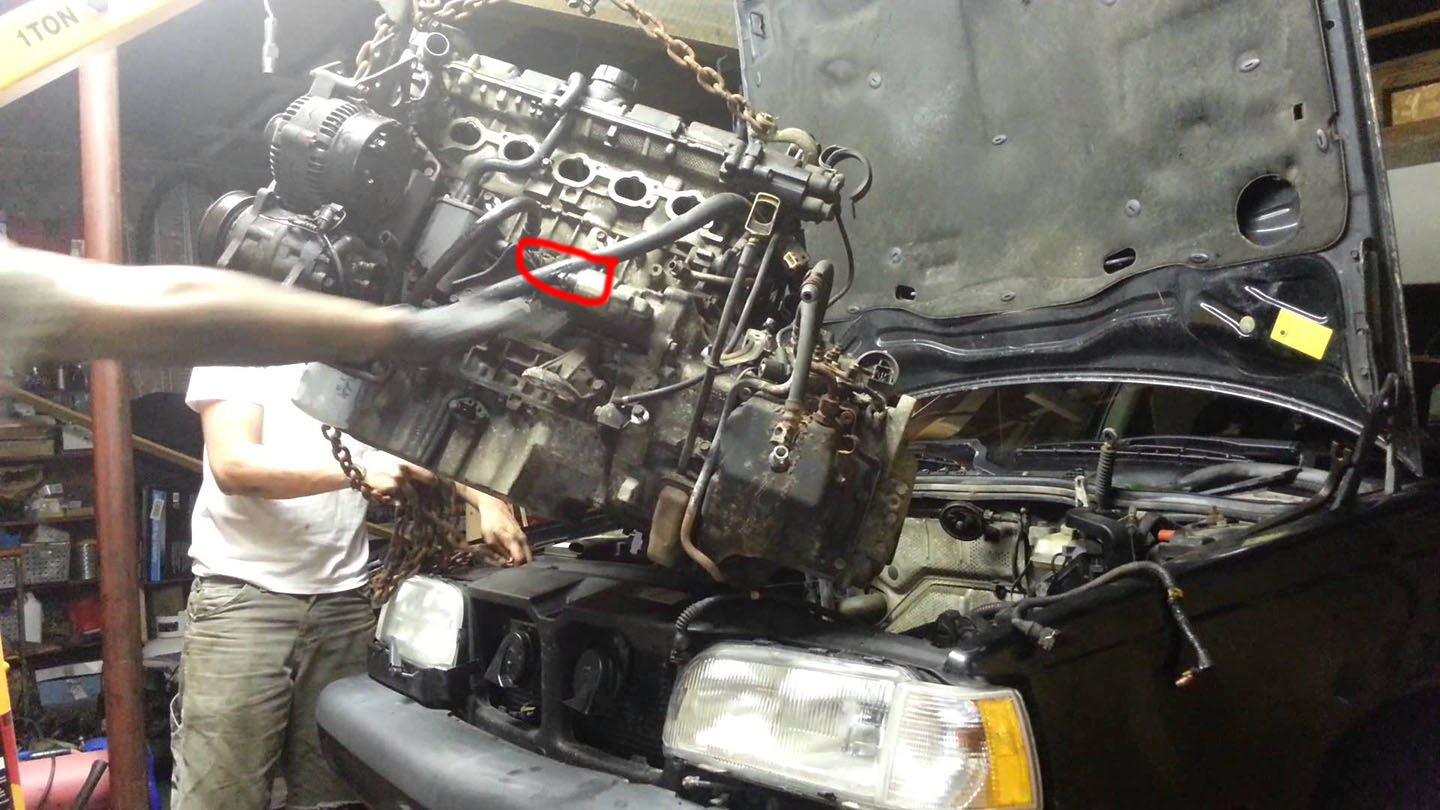

After getting lunch and coming back home (~15-20 minute round trip), I looked at the leak again and found new oil all over the bottom of the block, intermediate section, and pan. It's on both sides now, but still appears to be concentrated in the area between cylinders 3/4 and cylinder 4. In the daylight I was able to get a look at the bottom of the head/top of the block through the intake manifold and that section is dry. It appears to be coming from the middle block in an area that is hidden by the lower part of the manifold. Is this possible?
I found a photo through Google of an 850 engine and circled in red the area it appears to be coming from. Not sure if there's anything in this area that could leak though.
