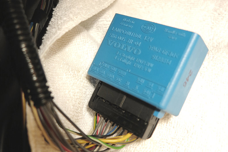

My search points to PN 9128814 Lamp Control Failure Sensor.
Ozark Lee points to the blue box located under the trunk carpet, behind the driver's rear light.
Item #2 in this diagram http://volvopartslisle.com/assembly/25529899/Other-Relays

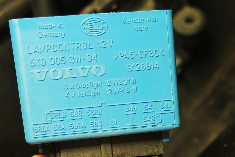

Can his controller be tested with multimeter?

Pin numbers printed on relay housing.
3 x Stoplight is likely 54H (high-mounted) R for right and L for left, is it?
