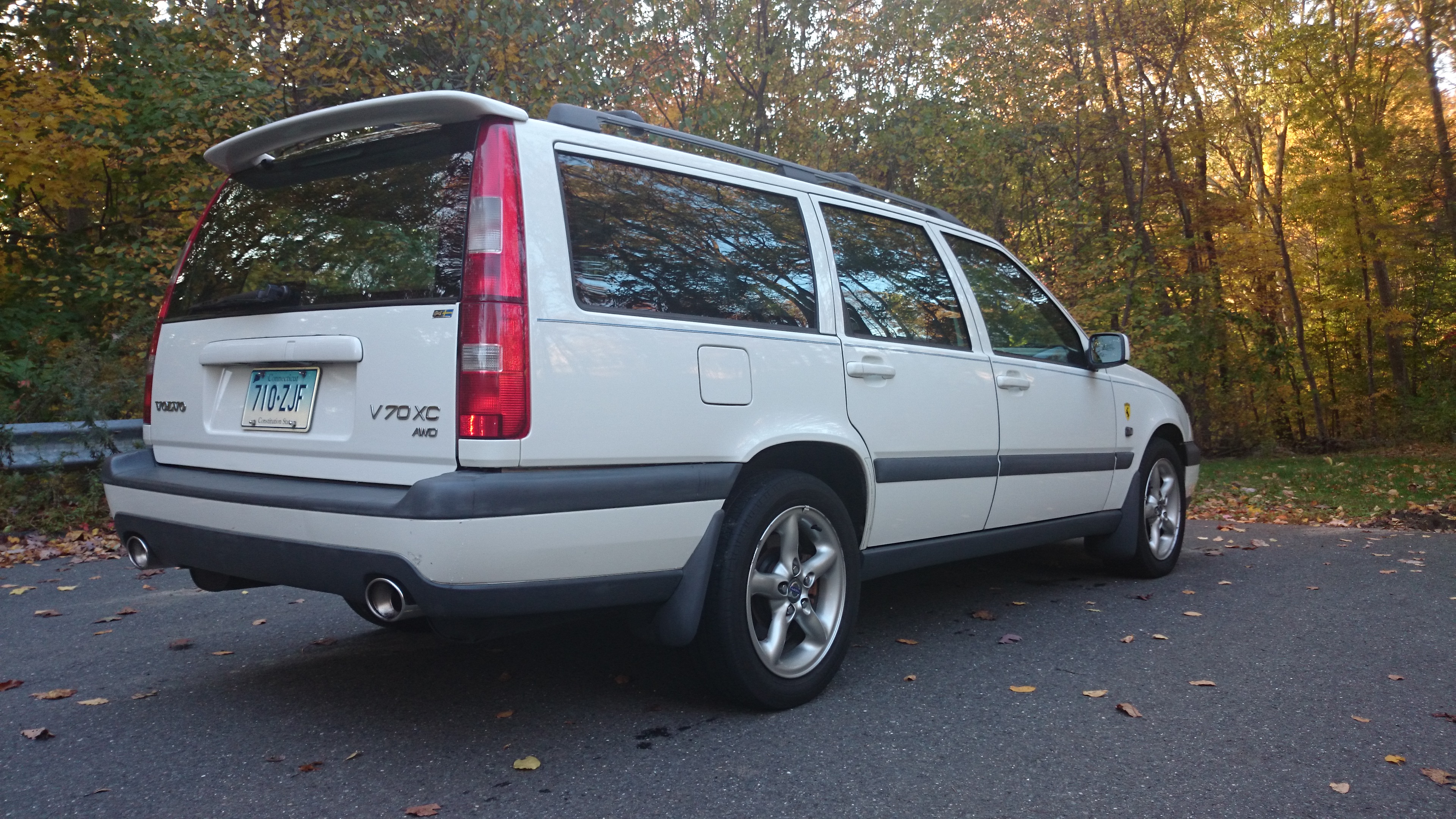

This is the Eurosport system on my XC:
Comments:
I like the looks and the sound. There is no drone but it sounds better than the OE system.
After 2 years of service (including winter in the NYC area) the pipes and hangers look heavily corroded but are still solid. The mufflers and tail pipes show no corrosion. Can't complain for the price I guess.
I bought mine from Viva and it took forever to get to my house. It appeared to me that it shipped directly from Sweden.
