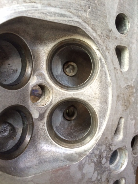

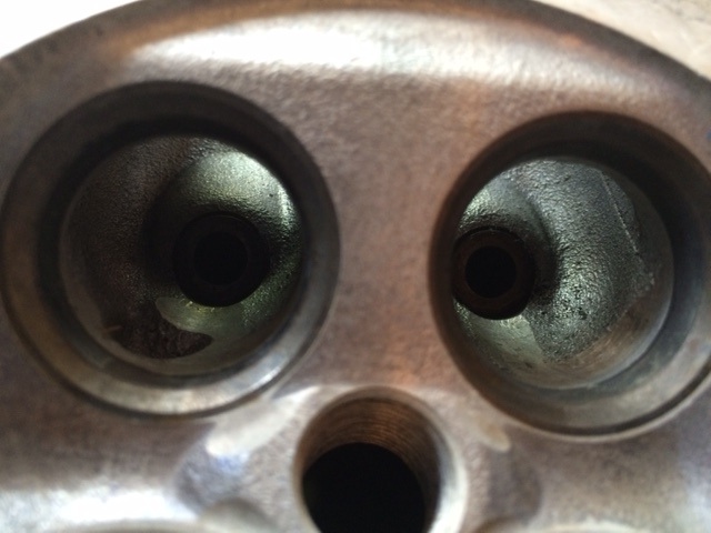

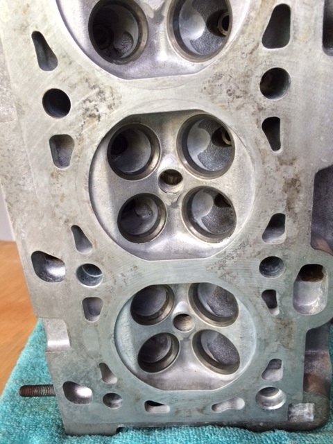

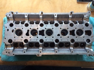

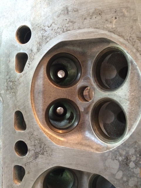

Here are some pics of cylinder head after soaking and brushing, and more soaking and brushing, etc! Its as clean as I could get it with being overly OCD!!

Nice pics, 5rivers. Since you have the head off and in your hands, would you mind taking a look at the exhaust stud closest to the back of the engine? (ie driver's side, possibly the one that can be seen in your 2nd photo.) Can you tell if it penetrates into an oil passage or anything like that? I've been dealing with a leak in this area, and it would be good to know what is in there. Thanks!

Oil leak on driver side near the exhaust stud: I can bet it comes from the Front Cam Seals.
See my DIY on TB SB WP overhaul, I specifically talked about tools (PVC coupler) and Corteco seals.

This stud oil leak is well documented in the other thread. Sealing the stud with permeated stopped it for a few months
