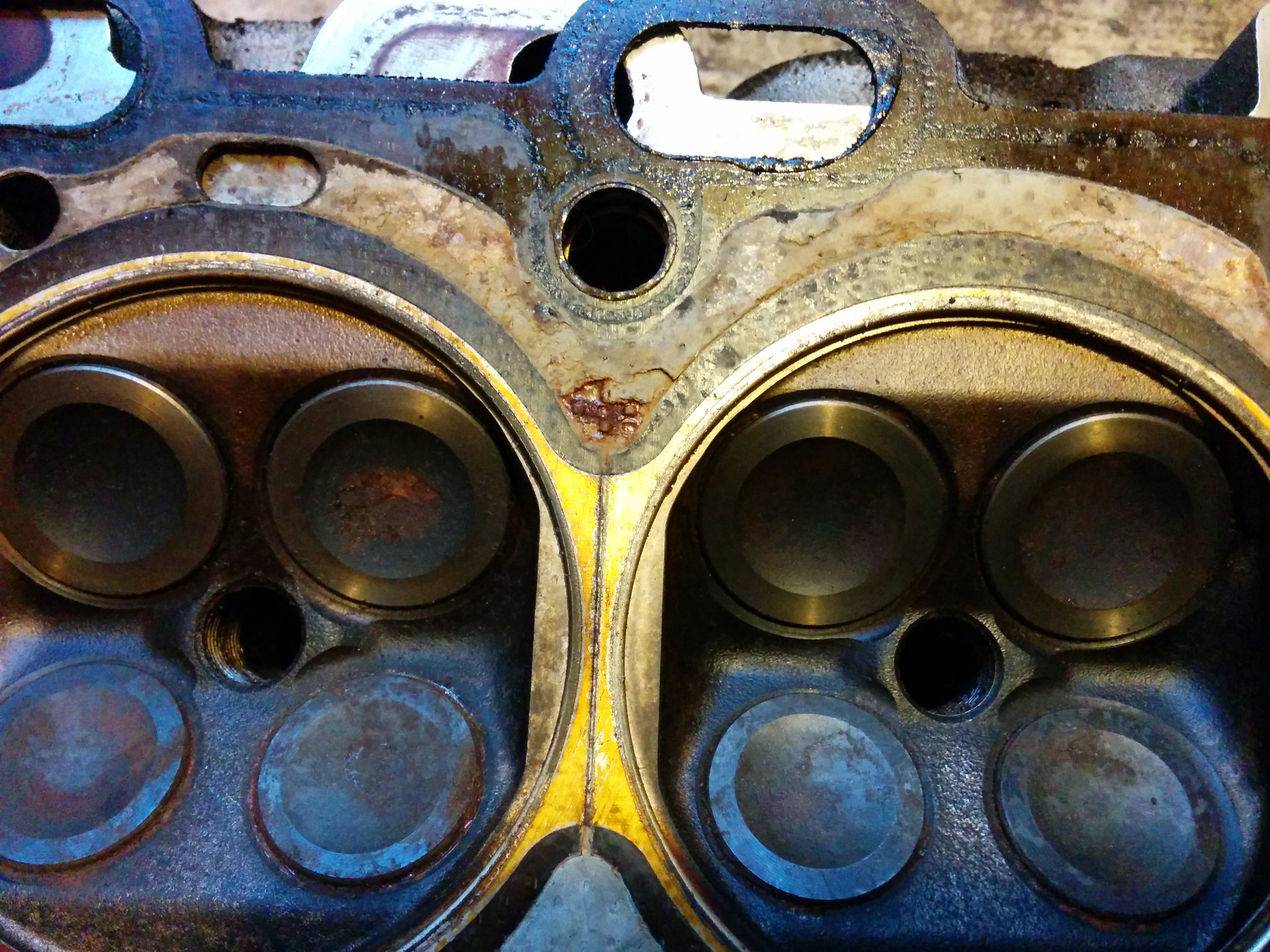

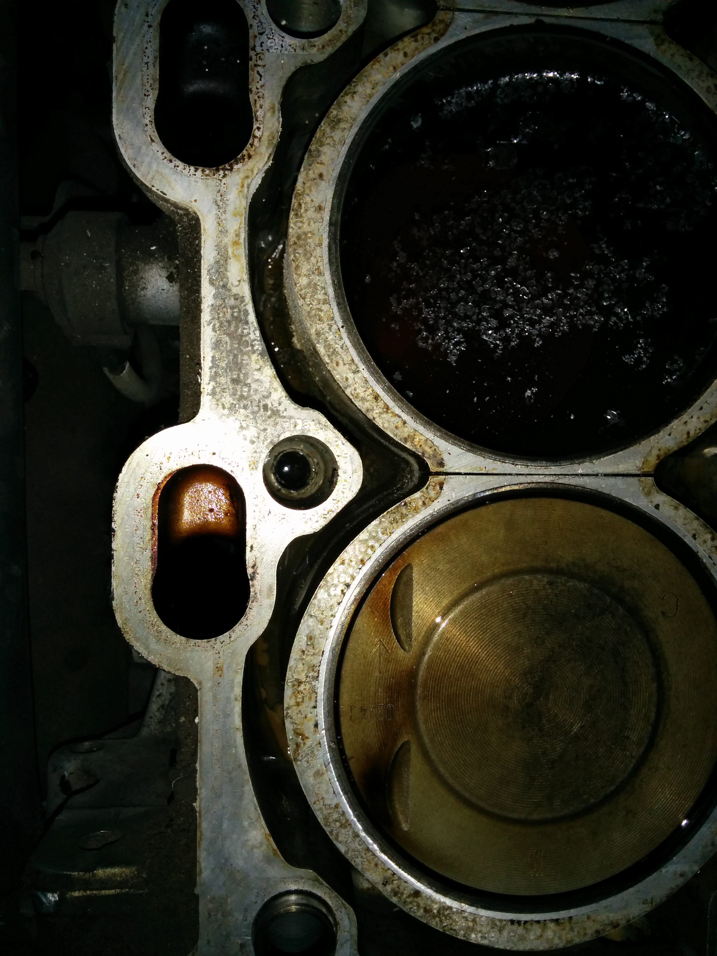

The engine in my 98 V70 2.5L 20-valve, N/A,160K was diagnosed as having a blown head gasket. Now that I have it apart the gasket doesn't look that bad (as shown in photos below). Could this gasket really be the source of a non-running engine?

And, well, that's the problem. There's nothing obviously wrong to my untrained eye (see views of upper engine block, both sides of the gasket and cylinder head mating surfaces). There aren't any obvious cracks in the block, cylinder walls or the head/valve assembly. Other than some rust and scale, the valves and cylinder walls seem to be in pretty good shape. The rust I believe was due to the presence of coolant in the cylinders for two weeks. In the photos you'll see that I wiped everything down with a rust remover and poured oil into the cylinders to stop the rust returning to the cast iron sleeves. A quick check with a straight edge shows no warping of the head or block (the machine shop will check the head more carefully).
head and block with detail
The head gasket seems to be almost entirely intact with no "blown" segments that would allow a lot of gases or fluids to flow between the cylinders, water jacket or oil paths. If you look at the close-up photos of the gasket you can see some degradation of the surface of the gasket but I have no idea if it's enough to cause a major coolant leak into the exhaust.

So that's my question really. Could the gasket in its current condition really be the source of the problem I had or is there something more serious going on here? What additional tests do I need to perform?

It looks like the surface between cylinders 2&3 and 3&4 have a little cleaner area, but could just be my view. And in the pics the top of piston #5 looks pretty clean. How do the others look with just sopping the water out, not scrubbing?Did the shop verify the timing was still correct, or just that the belt hadn't jumped or broken?

That number 5 cylinder looks like it has been nicely steam cleaned by coolant though.
Number one looks heavy on carbon and or oil..that all has to come off before reassembly.
The steam in exhaust and loss of coolant tells the tail of blown head gasket, though. The time to do compression testing is before you remove the head

But I agree with "Abscate" no 5 looks shiny clean compared to no 4 and the rest. And that it doesn't take a large breach to pressurize the coolant system.
Get the coolant out of the cylinders, and then turn the motor by hand. Does it turn smoothly? Are there any different wear marks or signs of damage in any of the cylinders?

The engine is OK I think. The cylinders are pretty much free of rust, scale and scoring. I had filled cyl 1-4 with light oil, so they they look nasty in the photos. But with the cylinder head off, the engine seems to spin just fine when I put a wrench on the crank. It would be nice if there was some objective way to measure this.
