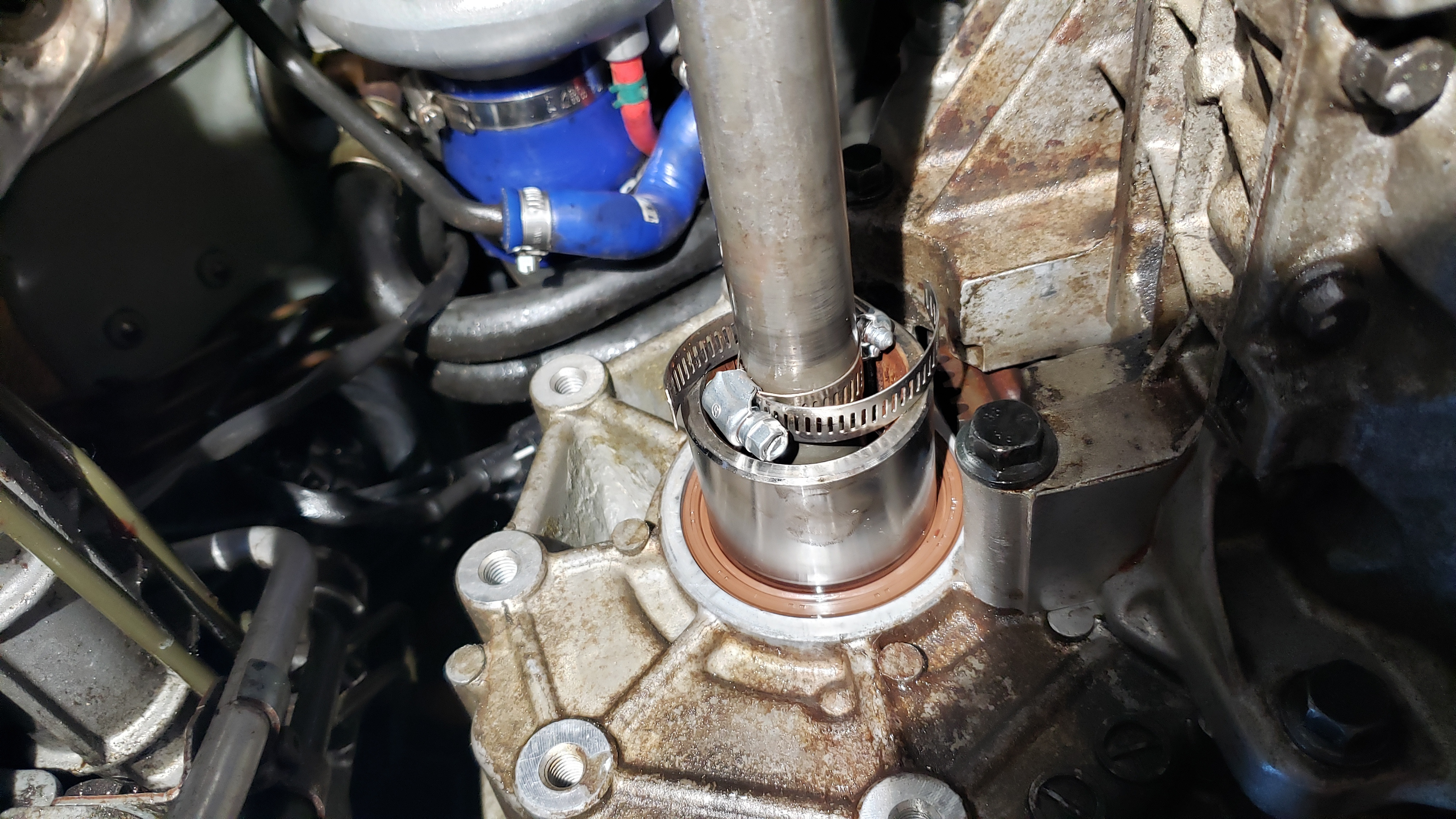

At this age and presumable miles, most AWD systems from the 97-00 range are fried. I took my drive shaft and angle gear out almost 10 years ago and haven't looked back. Only downside is the occasional small dribble of ATF I get from my jury-rigged angle gear spline holder. I will say, having the gear out makes working on this car way easier around the turbo and whatnot.
