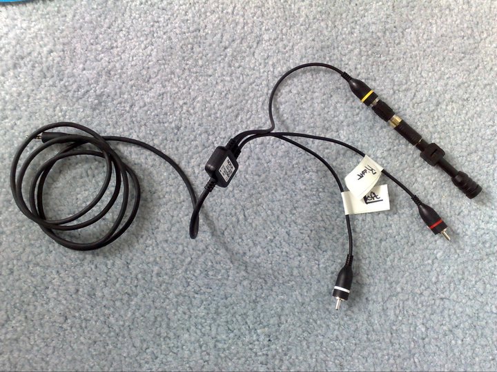

Ah, found some pictures.
The connector on the left plugs into the phone and carries four terminals, from tip to base:
- Audio left +
- Audio right +
- Microphone +
- Ground
(NOTE: This was for an old Nokia. Apple swaps the mic+ and ground so that you need iPhone-specific headsets and earbuds, so check the pinout for your phone before embarking on your soldering iron journey).

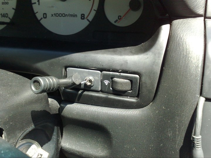

There's a buttload of couplers on the mic, though you could probably do that with a few strategic solder joints. The L and R cables went to the stereo - in your case, they would go to the tape deck adapter.

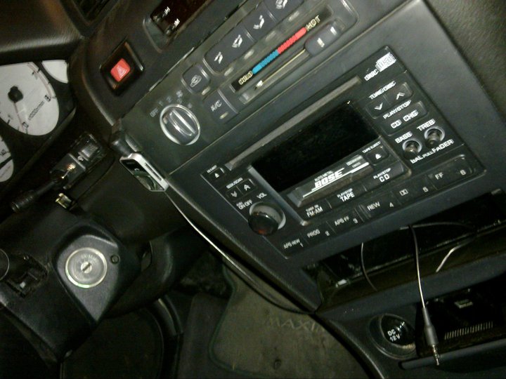

The way the Maxima radio aux-input hack was configured, you needed a switch wired into it to "turn on" the aux input. The mic was just a tiny mic from Fry's made to plug into laptops, and I pressed it into a hole drilled into a blank-off panel on the dash where some option my car didn't have would have had a switch.
I attached a remote control that came with the Nokia so that I could answer the phone or change the audio track without needing to handle the phone itself. The headset cable came out through a hole drilled in the back of the little cubby with the open door seen on the right in this picture. My phone fit perfectly into the ashtray, and I could plug the headset cable into it there. When I wasn't using this setup, I could tuck the cable back into the cubby and close the door and it would be hidden.
