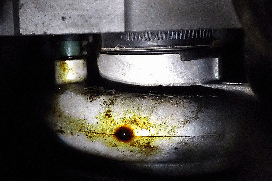

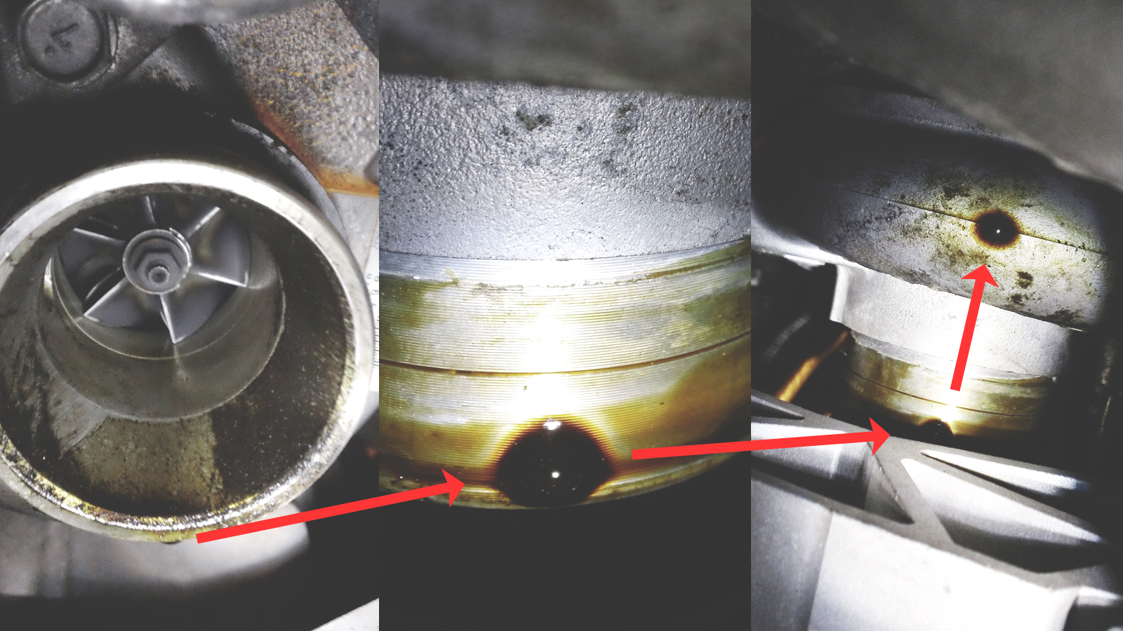

I am chasing the source of this drip for a while now.
After several readings of MVS threads, I looked at the PTC for any clog where air intake tube connects to turbo. I have detailed the task at this thread https://www.matthewsvolvosite.com/forums/viewtopic.php?f=1&t=36184...
and here https://www.matthewsvolvosite.com/forums/viewtopic.php?f=1&t=55306&start=14
The next step was to look at the turbo connection at the charged-air pipe.

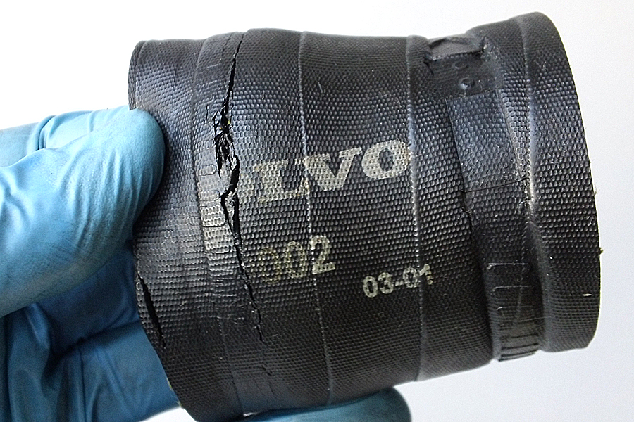

I have a CEL P0422 that come and goes. After the duct-tape use, proper cleaning and tightening of clamps, and restoring the charged-air tube connection yesterday I am free of P0422. There is an extra boost. Here are some photos which brings me closer to ordering correct parts.
Anyone using IPD's blue silicon coupler http://www.ipdusa.com/products/5430/114959-silicone-boost-tubing-coupler? The Volvo is rubber which I prefer over IPD's for this application.

...one more thing - why is turbo pushing fluid -- PCV clog, turbine seal, return oil line clog?

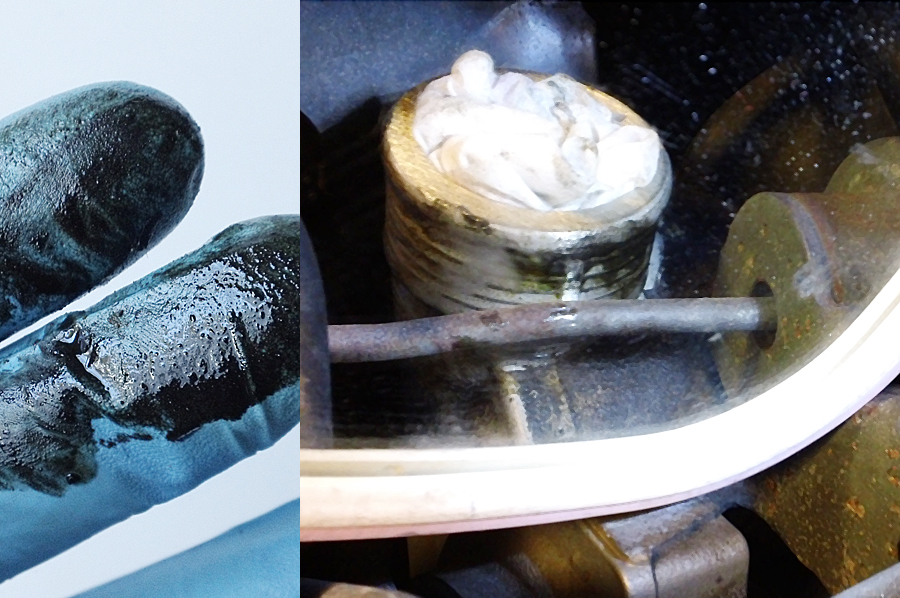

The inside is sticky as is with the Turbo tubing which indicates there is no more seepage from the Turbo and of course no more oil under the Turbo.
_
How many miles on the car, how much oil consumption between changes and are you using Synthetic? The reason I ask is because my turbo was soaked when I purchase it. After the PCV it would still have a drip just like yours (under the Turbo) and the inside still had oil and the Turbo piping would be damp. Forward 2 years it is completely dry, no drip and this with a smoking dipstick that was never remedied. The oil gushing dipstick tube after the PCV became a smoldering volcano. I know it is not the PTC that was causing the residual oil dripage and dampness in the tubes as it is all gone now.xHeart wrote:

My 03 xc has 256k miles and i'm chasing this similar oil drip after clearing up and replacing the rear cam seal. I'm curious as to what is causing this. whenever I pull off the immediate charge piping from the turbo compressor housing to the intercooler, I notice some oil around the outside lip of the turbo compressor housing pressure side and then some residual oil in the plastic charge piping as well on both ends. The oil coming through has definitely ate away at the rubber coupler going to the passenger side of the intercooler. I can literally take my fingernail and scrape off rubber from the inside of the coupler. before going with an IPD "Boostability" kit, I want to figure this problem out. Any more insight on the reasoning behind the oil drippage. Mine is concluding its leak at the same exact spot as the first picture posted.

I ordered the IPD part http://www.ipdusa.com/products/5430/114959-silicone-boost-tubing-coupler.
The Volvo's coupler lasted some 13 years/147000 miles. I doubt IPD would go more than a few years. It is silicon/nylon, may deform with heat and age.
Giving it a try.
Giving it a try.

I took another photo before replacing the coupler with ipd's silicon/nylon made replacement.
Previous cleanup, re-using the deteriorating coupler, and tightening the clamps have reduced the accumulation. The photo is 10 days after the cleanup.

Out of curiosity, what type of turbo is it?
my turbo like this ..i cleaned it up an put uv dye in to trace but this looks exact same problem im having but its running down the back and across me whole block up to the trap .. not that the oil loss is much ... just pestering me as ive done a throttle etm clean as was stuttering after doing vvt timing by hand ...

In my case, it is an accumulation of vapors coming from the PCV nipple at fresh air pipe where it clamps over the turbo.
It appears the nipple seal itself is showing age. The replacement pipe is this item http://www.ipdusa.com/products/9736/120407-turbo-air-intake-hose-p2-5-cylinder-turbo
I have oil and filter change due, I will take a look again.
