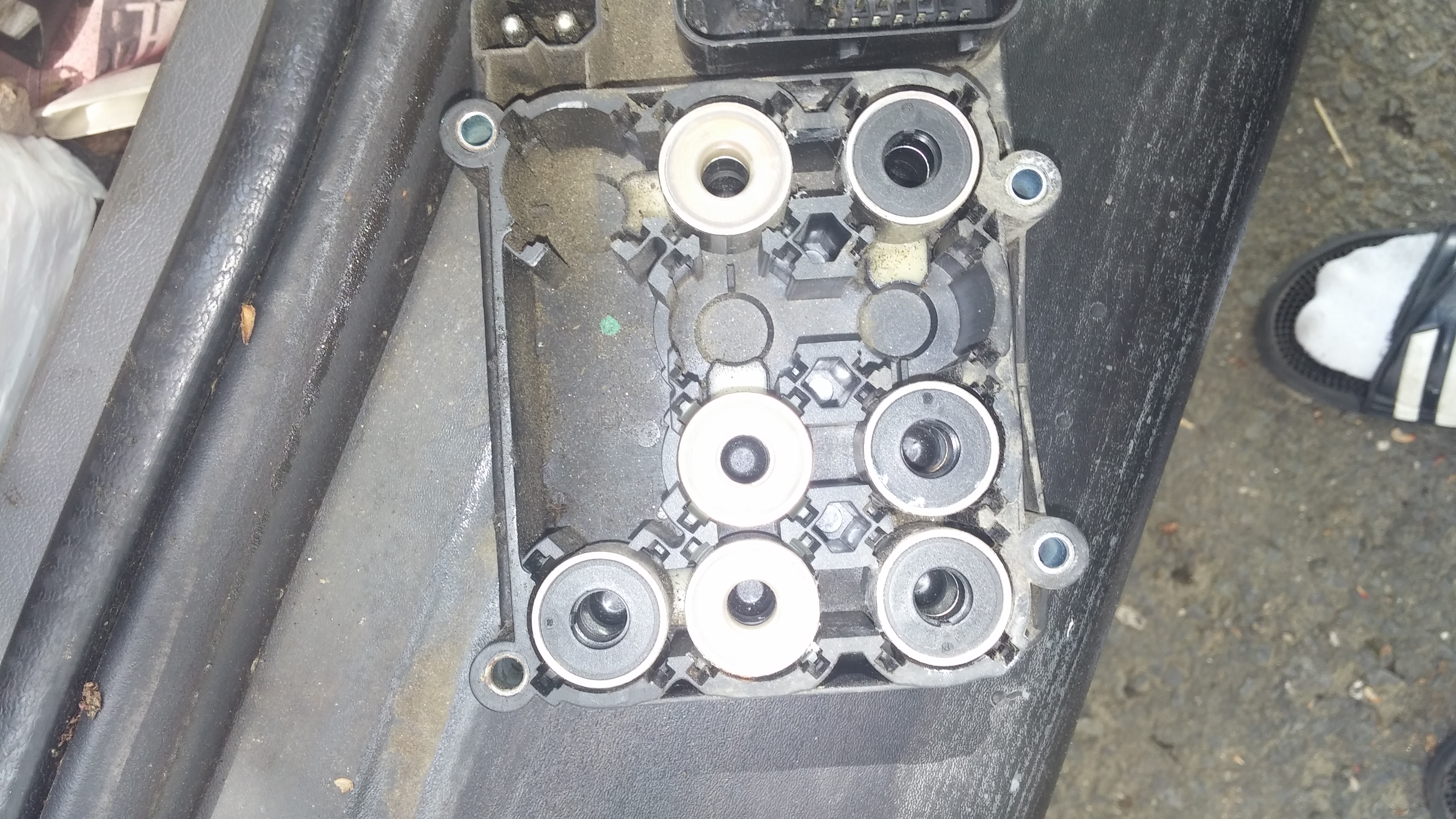

As long as both modules are from a 96-98 850 or V70, and as long as both cars had TRACS or both cars did not, they can be swapped.
Post side by side pics that show the part numbers on the front and people can answer more definitely.
