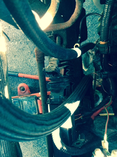

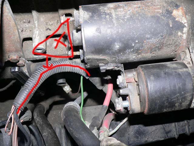

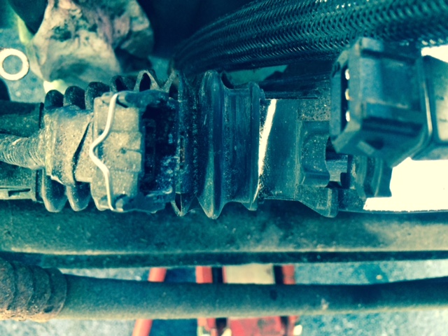

Here are some pics that might help distinguish location of the black ground wire and knock senor clip:
knock sensor location
Ground wire location.jpg (94.29 KiB) Viewed 1184 times
Knock sensor location?
Knock sensor location.jpg (133.8 KiB) Viewed 1184 times
Knock sensor connection location
Knock sensor location1.jpg (139.2 KiB) Viewed 1184 times
I think the black ground wire is visible in one of the above pics. I have the two smaller clips attached - one to the alternator, another to the starter solenoid - and the red (positive) cable situated between the alternator and starter.

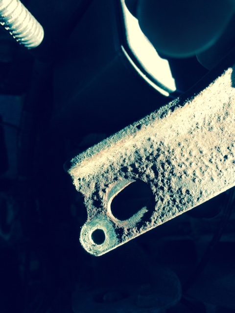

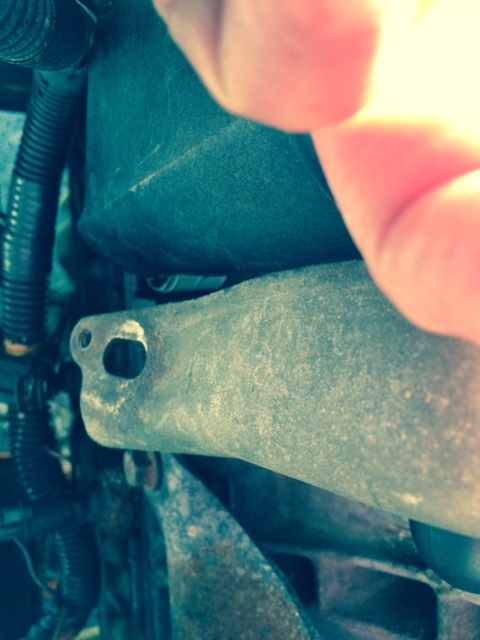

Sorry for the double pics; here is a wider view of general location of where the intake manifold stabilizer is bolted to the motor.
Ground wire location1.jpg (96.35 KiB) Viewed 1184 times

Thanks Lee for your reply! The black ground wire is visible in the second pic above this message, the round metal connector is up against one of the power steering hoses. I don't have a Haynes manual to determine the clip/connector location for the knock sensors, but I do have to go the salvage yard today. Maybe I can figure out the connections on a '98 V/S 70 that hasn't had its motor torn apart!
ErikV11, thank you! There is a bolt in the location you refer to to the left of the oil pressure sender. On the harness of wires between the starter and alternator there is a clamp to hold up the group of wires, I suspect it attaches to the smaller of the two holes on the lower part of the intake manifold stabilizer that attaches to the motor - that might account for the bare (non-rusted) section around the backside of the smaller hole. Good luck with all your transfers!!

Just a note for clarification - the first 2 pics above are of the backside of the intake manifold stabilizer that attaches to the bottom of the intake manifold and the bottom part (pictured) that is bolted to the motor between the PCV oil breather and the starter. The pics are mis-labelled. The smaller of the two holes has had something attached to it - like maybe the clamp (I am guessing) that holds up the group of wires (harness) between the starter and alternator.

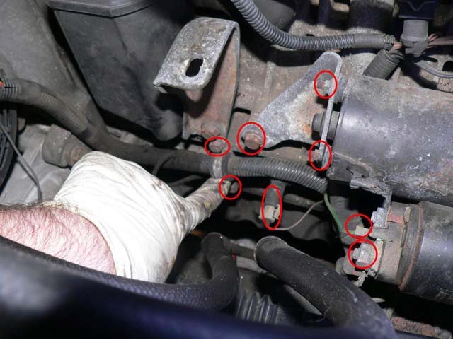

I don't know if these pictures will help or not. They are from wheelsup's engine removal write up which can be found here: https://www.matthewsvolvosite.com/forums ... =1&t=28973

Thank you polskamafia mjl, erikv11 and Lee!! My visit to the salvage yard confirmed the location of the connections (for the ground wire, wiring harness clamp, and knock sensor clip) as well. On my volvo, the knock sensor clip is attached to the black plastic covering (has an accordion look to it) to the large wiring harness just above the cross section of the front frame, which is different than pictured above (where the knock sensors are grounded to motor).
