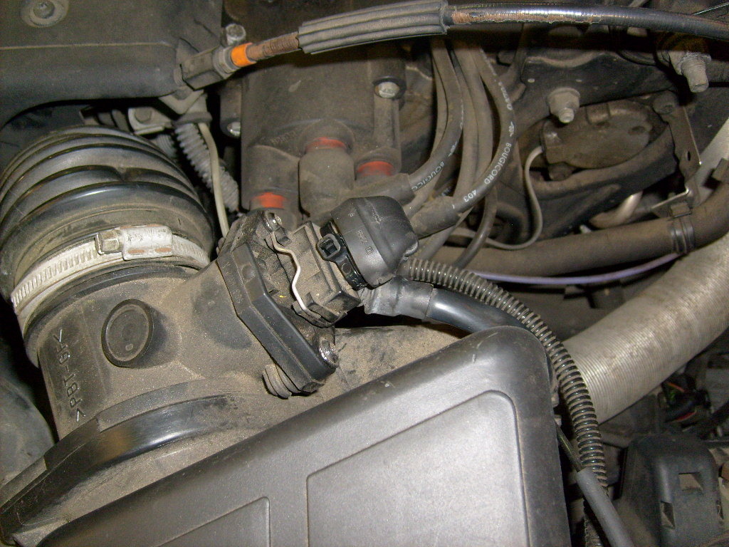

I know some people use a zip tie on the connector to make it work. Perhaps you're suffering from the same problem. I would plug it in and, with the engine running, move the wiring for the connector around a bit and see if anything improves.

The first thing to try is to go into the MAF connector with a fine point screwdriver and attempt to close up or tighten up the gap on each of the female connectors. Then plug it back in. You aren't going to kill the MAF by using it, see abscate's remarks.

Thanks for all the input. I think (but I'm not sure) that my mechanic was concerned with the expense of diagnosing bad wiring that connects to the main engine harness, and so offered to have me do some basic continuity testing. As for plugging in the MAF, he may have thought it a bad idea since it was clearly causing the engine to run so terribly. But I will try your suggestions and see if they make a difference. Again, thanks for all the useful advice, and in such a short time!
