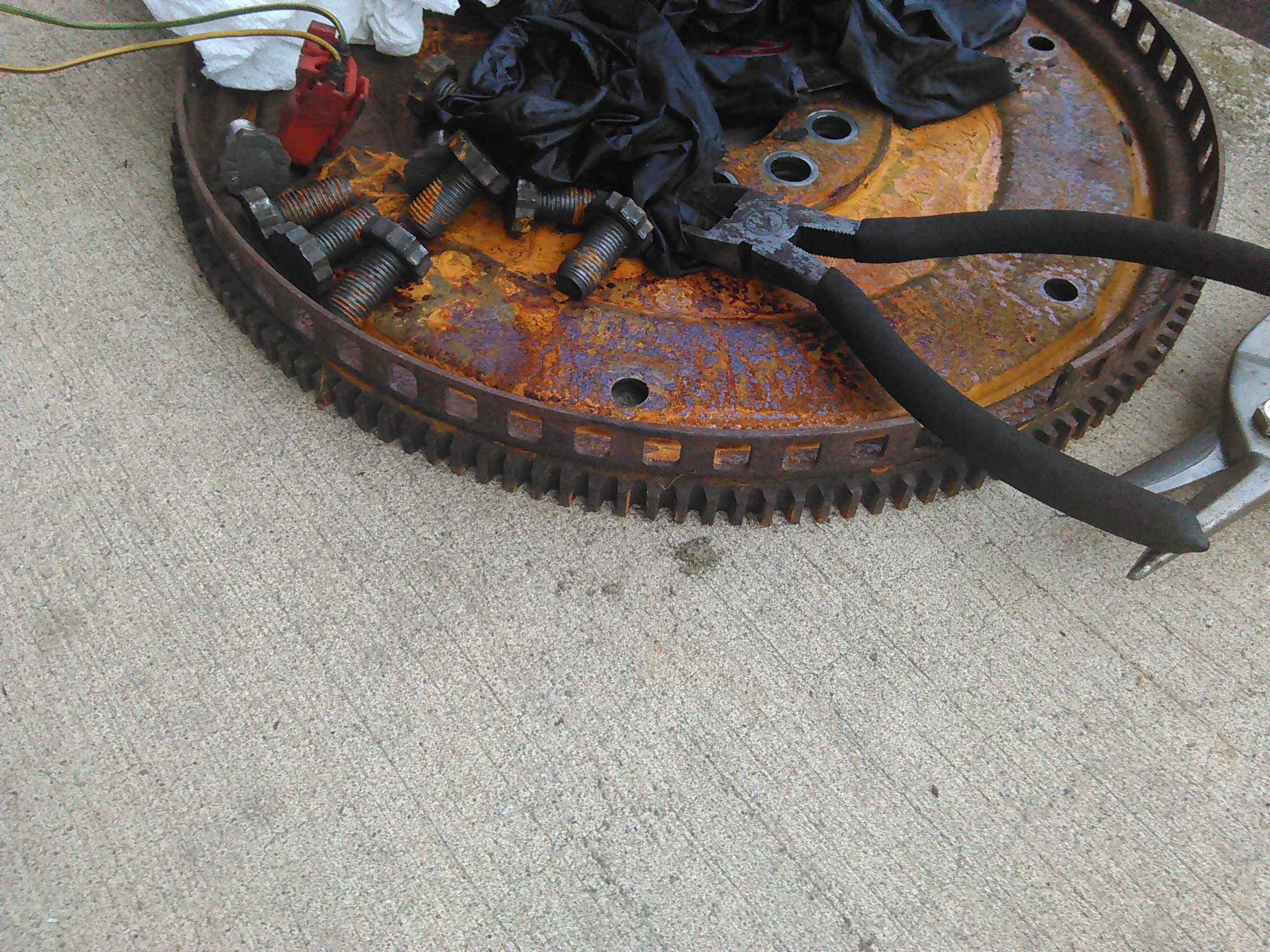

Using whatever method you prefer rotate the crank until the six flex plate bolts come into view. You can access them through the starter opening or the opening near the differential. These should be T50. Next remove the bell housing bolts that connect the transmission to the engine and pay attention where each bolt goes. There are 2 different lengths and you’ll want to make sure they all go back where they belong. Finally, separate the engine and transmission.
With the engine separated remove the flex plate to crank bolts. These were 12 sided 12mm bolts on my car. With the bolts removed, remove the flex plate and set it aside. Use a shop vac to vacuum out any left over thread locker that remained on the threads.
If you’re going to replace the rear main seal now is the time to do it. Using a small drill bit drill a pilot hole through the seal. Find a small screw and a drill bit with a diameter close to but just smaller than the diameter of the screw. Using the second drill bit drill a larger hole through your pilot hole. Start the screw in your drill hole and watch the RMS walk right off. Be very careful not to the mar the crank surface as even small defects here can cause an RMS leak. I drilled at least half a dozen holes before getting this technique to work.
Using motor oil I lubricated the new RMS and installed it onto the crank. I used the old seal and lightly tapped the new one into place.
With the RMS installed and the crank bolt holes cleaned, install your resurfaced flywheel. I have read that some people install a new pilot bearing in the flywheel. As far as I know it isn’t necessary and in no way supports the input shaft of the transmission. This thread convinced me not to worry about it:

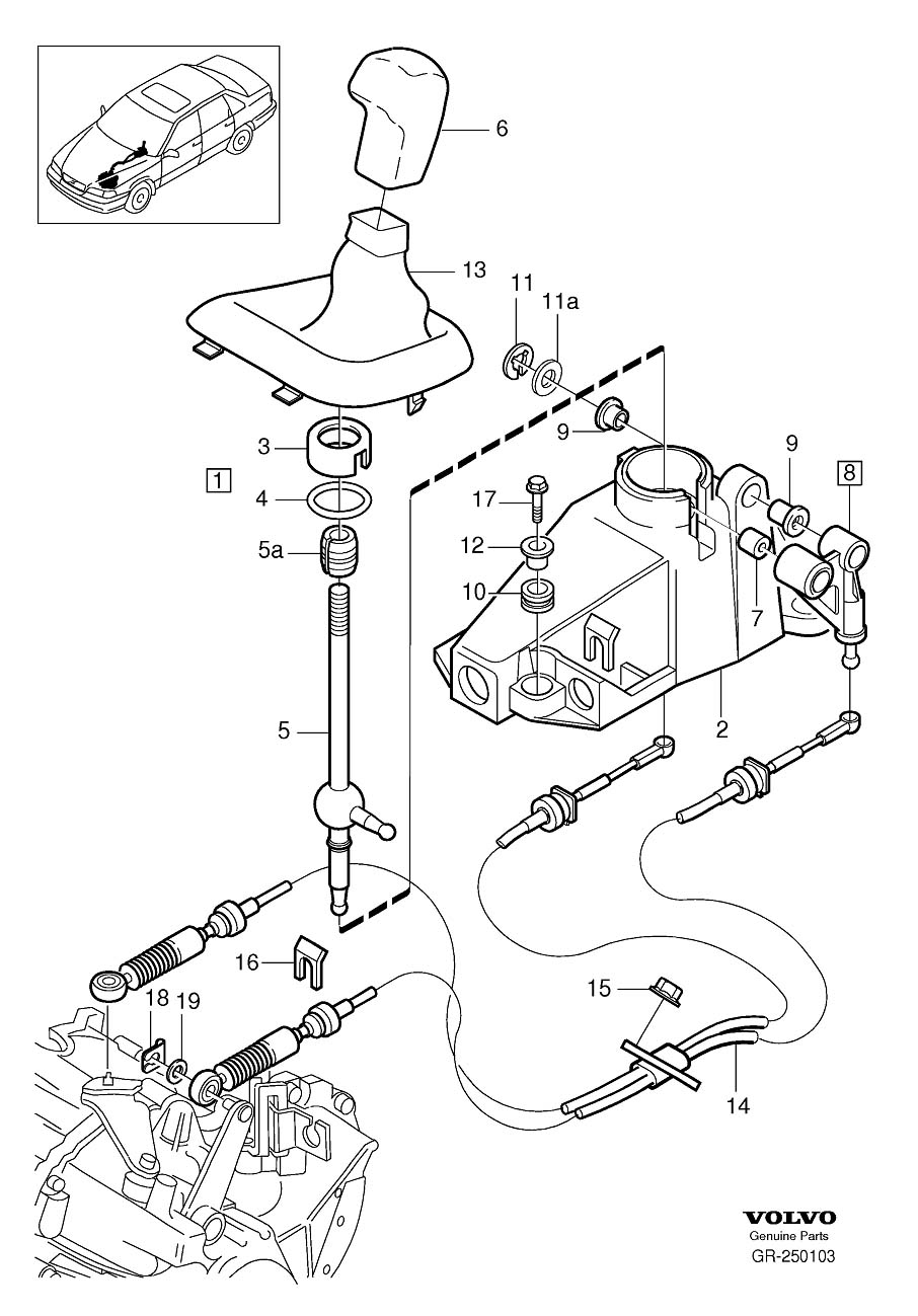

Once the cables are through the center console and lined up correctly attach the cables to the shifter. This can be challenging and I wish there had been more documentation on this before I attempted it. I wasted an incredible amount of time trying to get the two cable ends situated on the shifter. The cables and shifter use a ball and socket set up. Place the ball of the shifter at a fairly large angle to the socket and use a pair of angled needle nose pliers to force the ball into the socket. This should make more sense when you see it in person. I also removed most of the old dried up grease and used new silicone grease to lubricate everything.
With both cables secured to the shifter, install the two collars (3502507) to anchor the cables to the shifter assembly. The collar clip for the left most cable will simply slide in from the top. For the right cable, the clip will slide in from the bottom and sits inside the assembly. I didn’t know about this clip at first and spent 2 weeks driving around with a really sloppy feeling shifter and no reverse. With the cables done, install the 4 shifter bolts that secure it to the car followed by the two bolts and plate at the rear of the shifter. Install the rest of the center console and reattach any disconnected wiring. Install the two nuts that secure the shifter cable grommet to the firewall. At this point the interior should be done for the most part.
