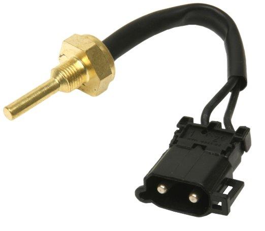

That site is wrong. Look it up in Vida
The earlier cars from 1993-1998 took this type:
Later cars from 99 to 2001 took these:

A-ha....i just checked....mine is 9186486.This one is up to '99.

No, up to 98 (in the US).misha wrote:A-ha....i just checked....mine is 9186486.This one is up to '99.
The first year of the S/V/C70 (98 in the US) has exactly the same sensors as the 850s. Then the 99+ have the electronic throttle body and most of the sensors are different.

S/v/c70 was introduced in '98 in U.S...in Europe in '97.erikv11 wrote:...No, up to 98 (in the US).
Like you said...1st year of s/v/c70 ('98)had exactly the same sensors as late 850.If they are '98...so it means UP TO '99.
From '99 and ON they have different sensors and different engine management.
That's all what i said.

Oh, I see, no worries we are on the same page as far as the facts! To me the phrase "up to" means "as far as" i.e. it means including. Like many idioms it can mean different things to different people/situations. All good.
