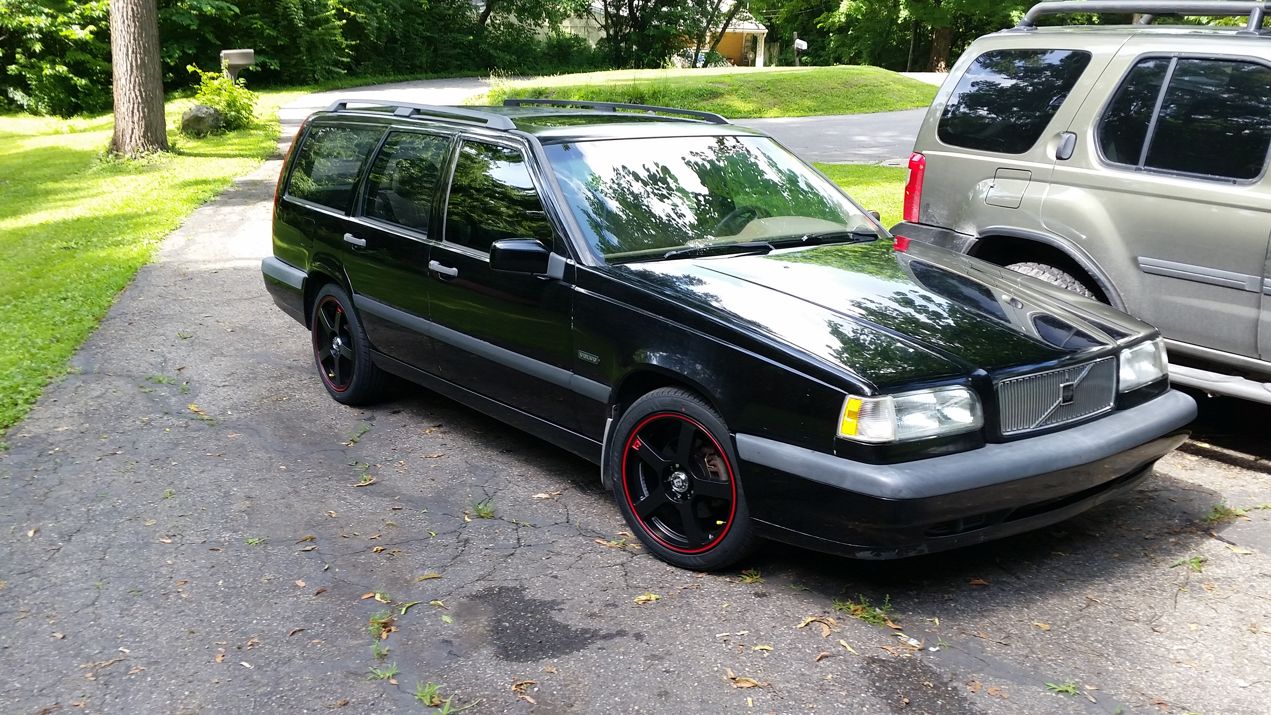

I'll check that thread out, thanks. Here a couple of picture with her new shoes on. I need new shocks and struts so I think I'm going to purchase the lowering kit from IPD. 1.5 in the front and 1.0 in the back.

You and I need to be friends! I also own a 1997 850 GLT Wagon (but mine is red), and I've been debating a turbo swap and the exact rims that you bought...
