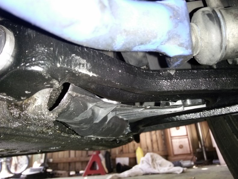

Also today this happened:

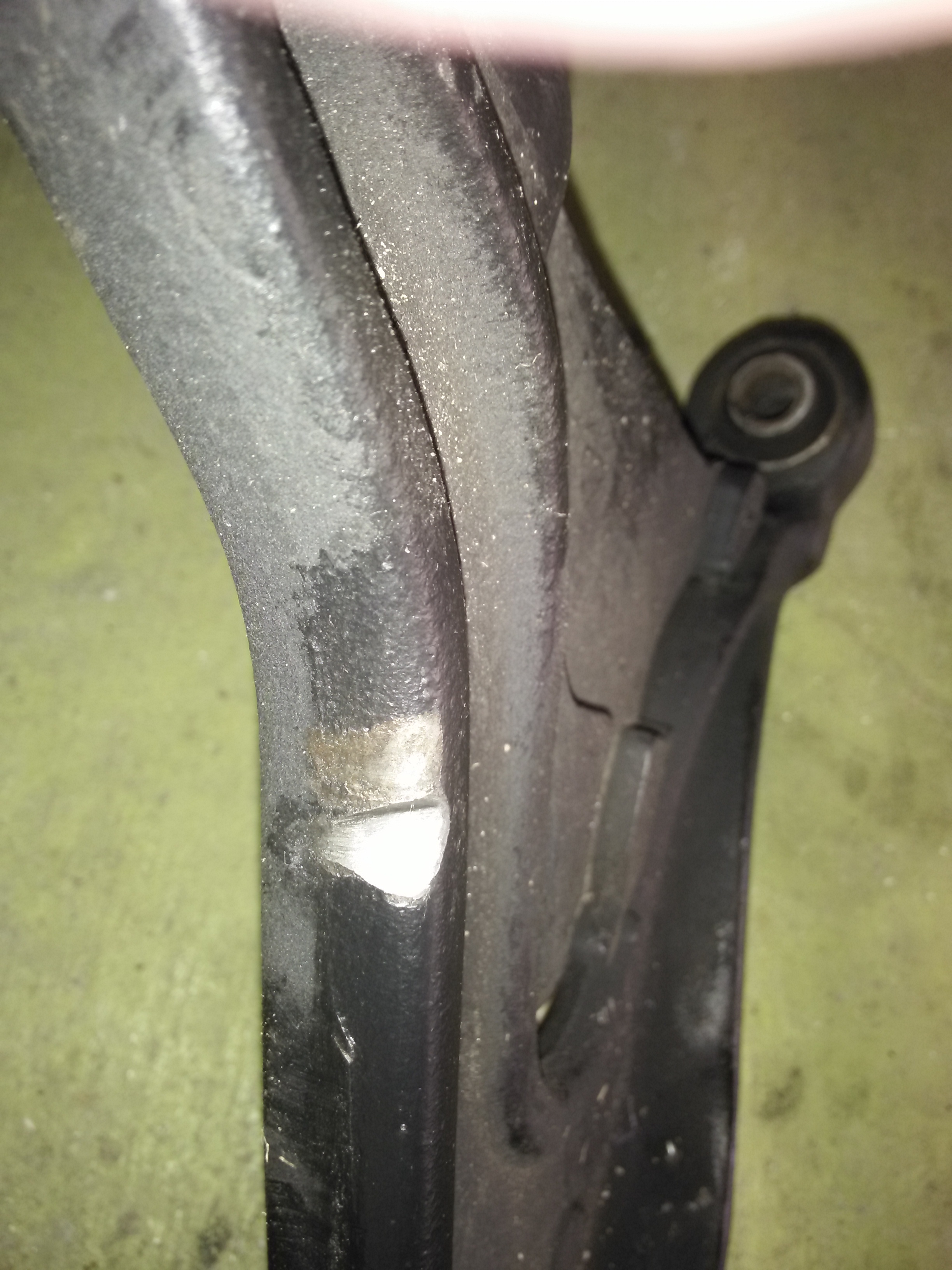

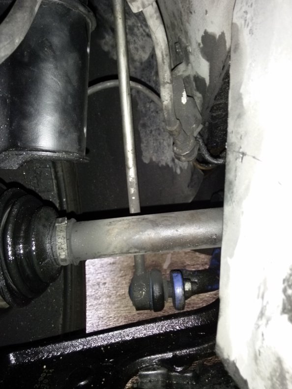

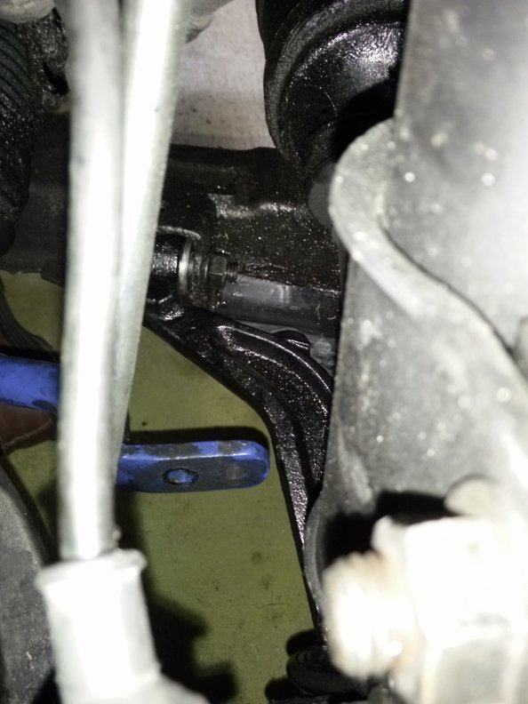

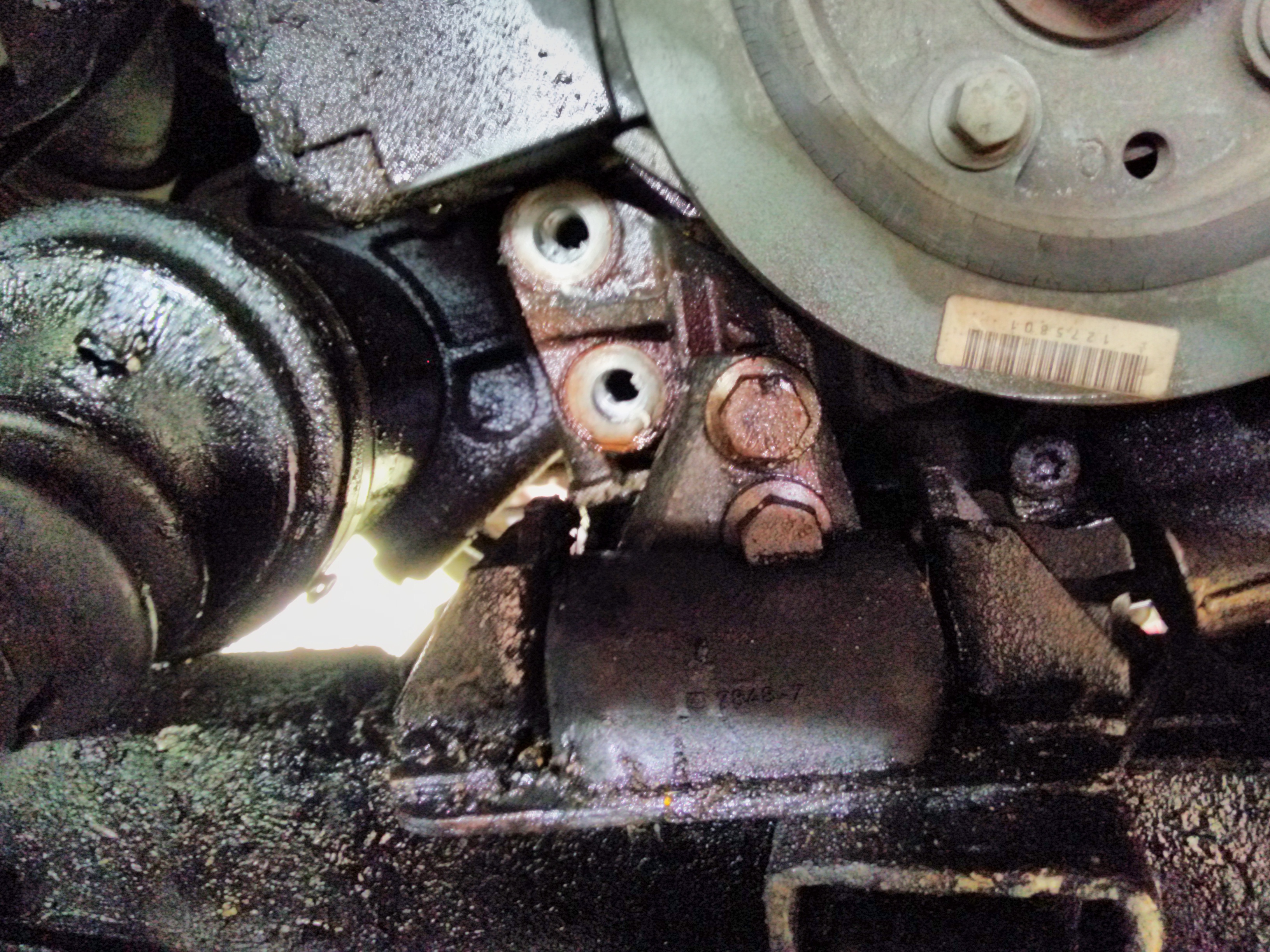

Well, just got done looking a little further today. I have red line readable sway brackets and noticed they were pushed forward a bit, so undid the links and loosened the bracket bolts and pushed it back as far as I could. Buttoned it all back up, I have a little more clearance but still seems awful close. I need to find someone with an 850 or s70 to compare to. I did order a front motor mount to put on at the same time as the control arm but Fox sent me a motor mount bracket instead. Perhaps the cabin vibration is partly that mount which is obviously busted. Here's some pics:
You can see the rub marks on the new control arm.
And the rub marks on the old bar

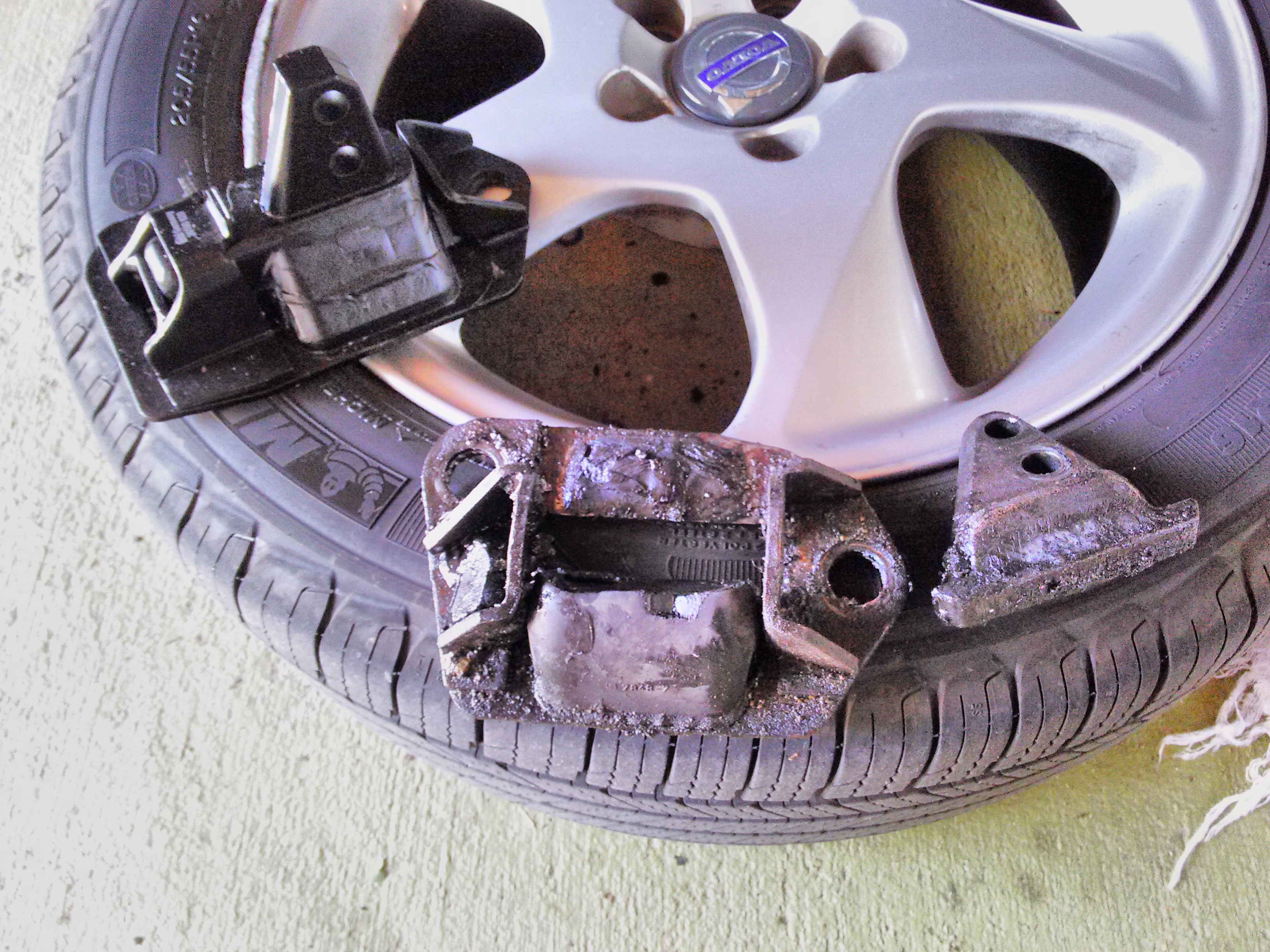

Fixed it. After pulling in next to an 850 at the park and ride, I looked under it to compare clearance. Pretty close like mine. Once I got the right part(front right mount) and installed it, I no longer want to set my car on fire. Proof in pudding that I am not a mechanic. The car is very quiet now. Pretty sure I bent that wheel though...

wow that one was shot! so the impact broke the mount? All squared away now?
