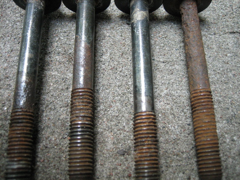

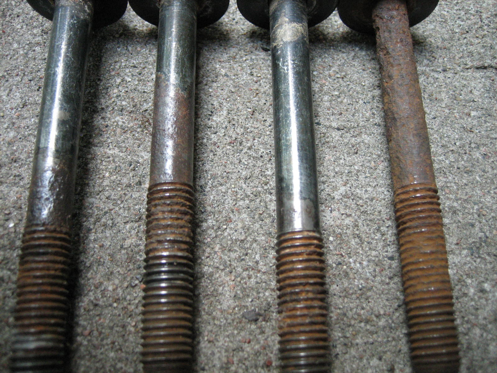

Sometimes the bolts get rusted. Picture bellow is a bolt that has been put back and reused for one year. Also, it is better not to torque them back to the original torque or they may snap while driving. So it's a bit tricky to reuse them

They are stretch type. Interestingly, the ones on drivers side are shorter than the two on the passenger side. The bolts are cheap, about $15 for all four.
