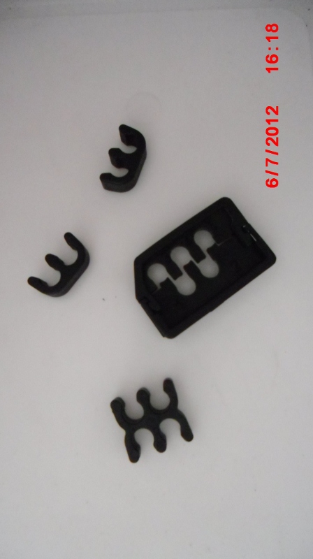

There are plastic spark plug wire guides that come off by hand. This one unsnaps using a small flat-blade screwdriver.
CIMG1786 (800x448).jpg (195.11 KiB) Viewed 2834 times

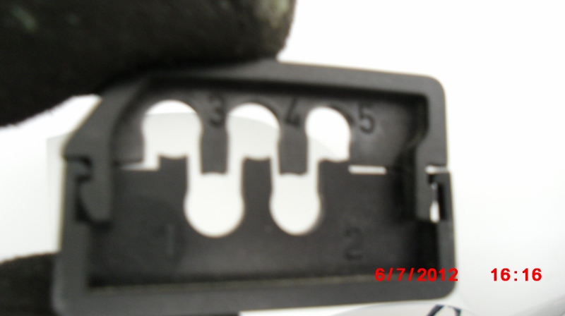

This guide is marked 1-5 to correspond with the spark plug wires and helps keep the wires off the engine block.
CIMG1787 (800x448).jpg (142.68 KiB) Viewed 2834 times
Here are all the plastic guides taken off the spark plug wires.
CIMG1788 (448x800).jpg (150.51 KiB) Viewed 2834 times

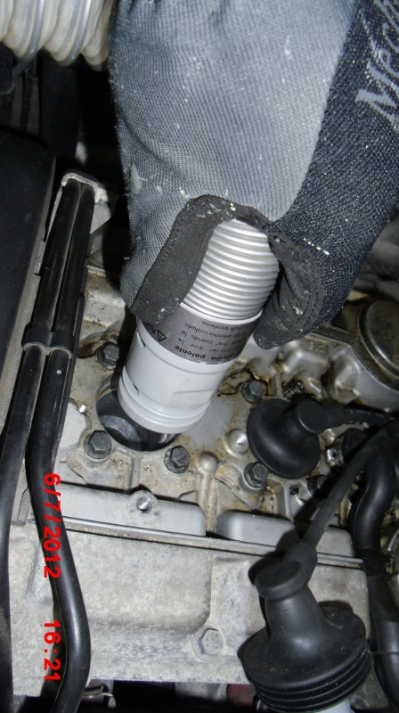

Using the shop vac to suck out debris before removing the old spark plug. I also vacuum after removing the plug as a precaution.
CIMG1789 (448x800).jpg (267.1 KiB) Viewed 2834 times

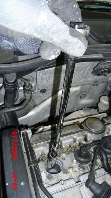

Removing old spark plug at #1 cylinder using ratchet, extension, and flex-joint. Turn the spark plug socket slowly to avoid stripping threads.
CIMG1790 (448x800).jpg (244.05 KiB) Viewed 2834 times

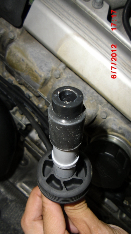

This spark plug socket has a rubber insert that prevents the plug from dropping back into the hole.
CIMG1791 (448x800).jpg (225.02 KiB) Viewed 2834 times

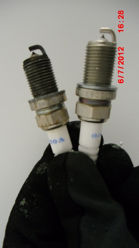

Old and new spark plug side-by-side. This is after 25K miles, should've changed at 20k intervals instead.
CIMG1792 (448x800).jpg (169.49 KiB) Viewed 2834 times

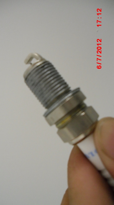

Wipe anti-seize lubricant on threads only. Use a shop towel to wipe lubricant off the electrodes.
CIMG1794 (448x800).jpg (152.54 KiB) Viewed 2834 times

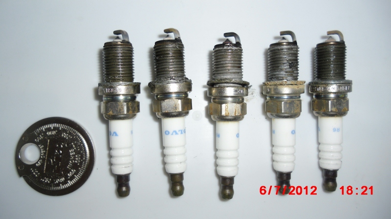

Spark plug gap gauge and old plugs lined up 1-5. The infamous #3 plug has the most carbon, probably because it's in the center and hottest part of engine.
CIMG1797 (800x448).jpg (199.72 KiB) Viewed 2834 times
