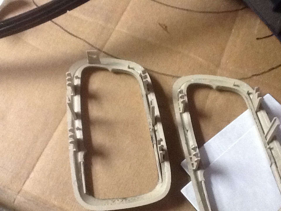

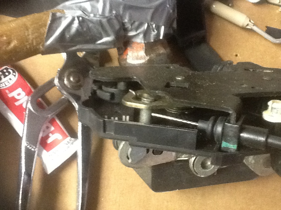

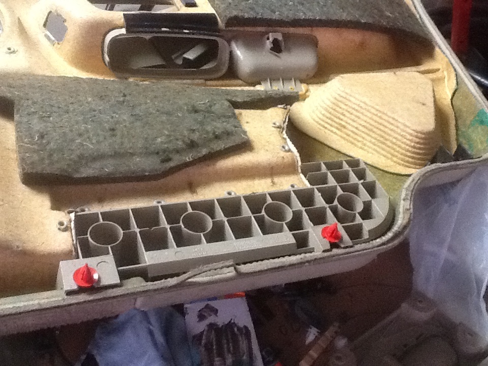

You can see the plastic part from the door handle. One is missing a piece. Either pry from the back and/or push forward as you remove so that little tab doesn't break. Picture of locking part. The wire is either broken or has come loose. The handle end looked a little more technical to get into. The red things are what you are trying to remove to remove door panel. There are more than I am showing.
You may need to visit a PNP and find a latch.
Hope this helps
