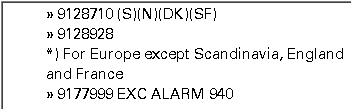

Photo shows various part numbers for control mechanism

I don't think this part is available: 9166157 volvo
Nor is this part: Stock Code 9177999
In the US at a Volvo dealer; these might be located in a US salvage yard

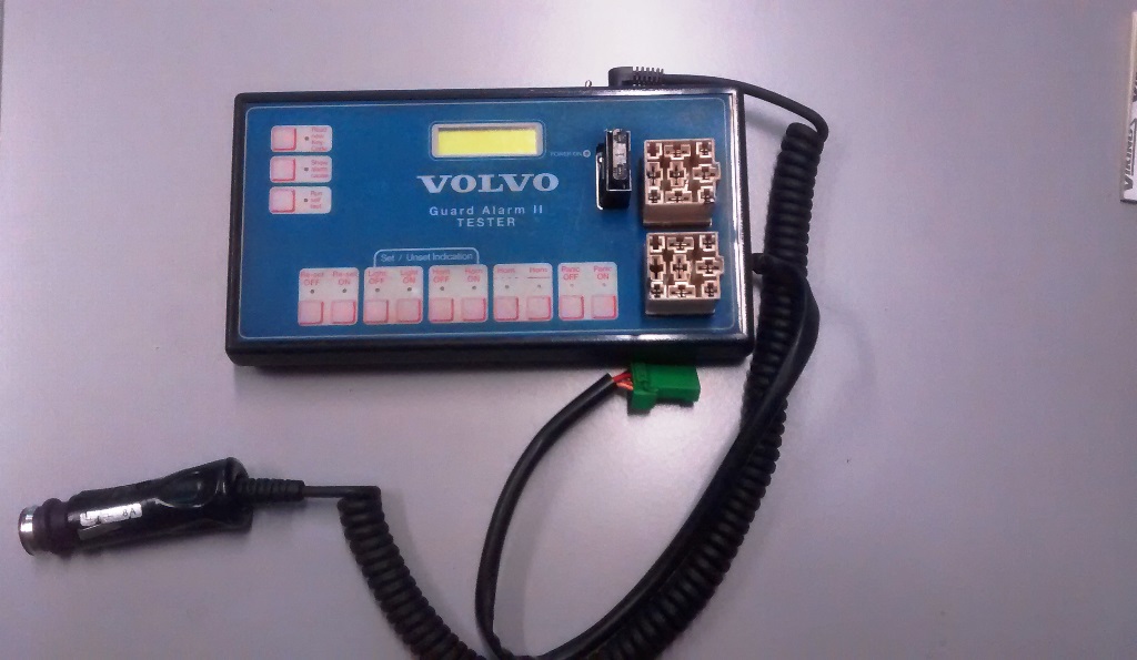

Why don't you join the German forum http://www.volvo-forum.de and ask if someone in your neighbourhood has a Volvo Guard II diagnostic test and programming unit.
Most Volvo dealers have disposed of them and they have been bought by enthousiasts.
Alternatively you can send the relais and the remotes to me and I will gladly test and program them. But I live in Holland so postage will be more expensive
