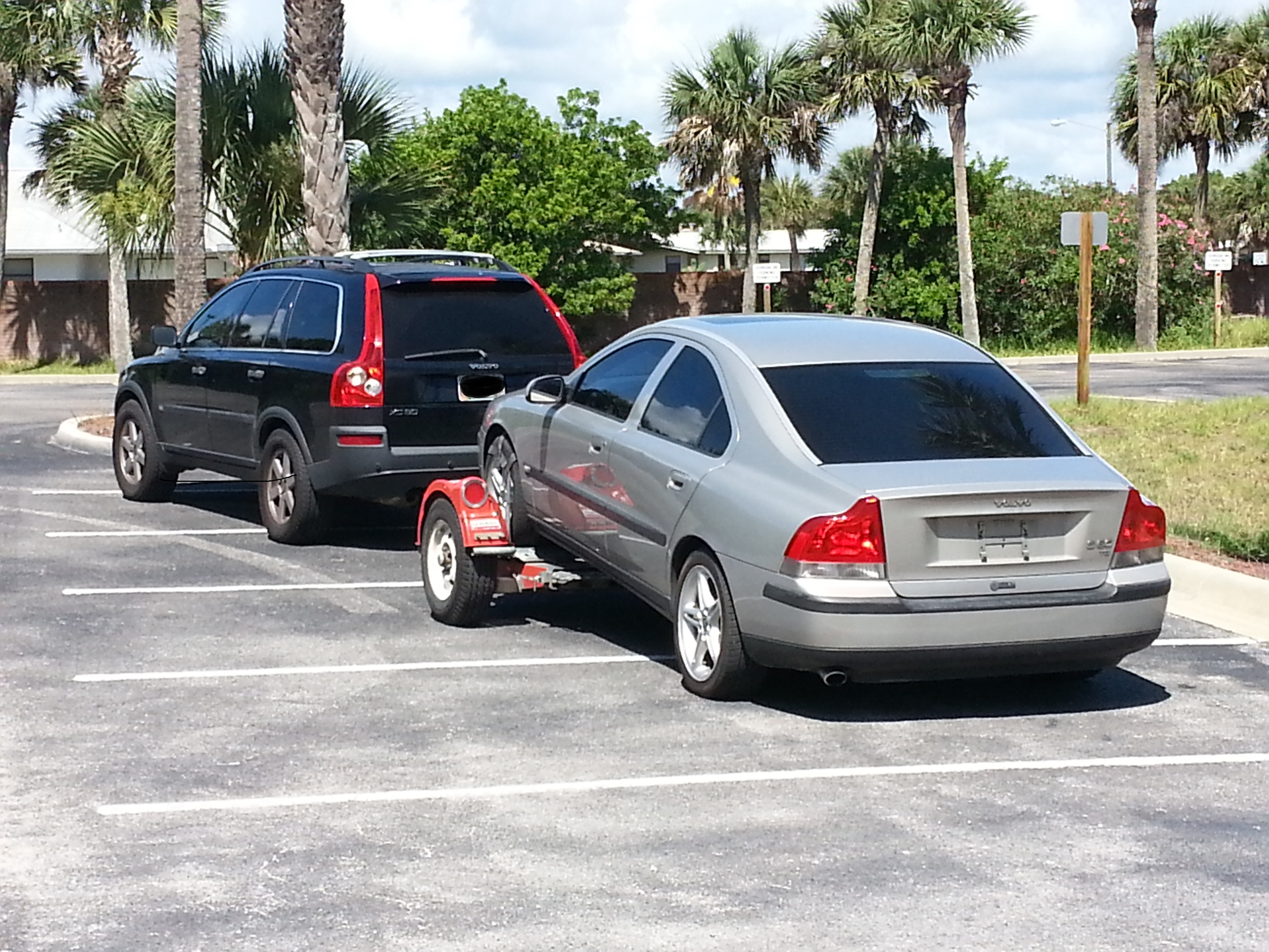

XC90 is FWD or AWD not just rear. I have a 2006 XC90 2.5t FWD I tow cars with it and my wife drives it daily about 60 miles round trip to work . I have not driven a 3.2 but I have seen post saying the 2.5 feels a little peppier and I would say its only down fall to the 3.2 is replacing timing belts on the 2.5. I will say the 2.5 will spin the tires if you hit the gas too hard taking off. Wife averages 18mpg in traffic 22 on interstate trips and towing a S60 behind on a tow dolly from Daytona to Atlanta I averaged pretty decent running 80+. 14-16 mpg
