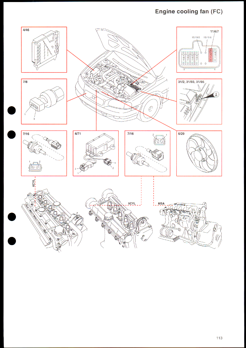

I was checking the cables going to the fan: there are two (black-red) bringing ground and 12V, and a 3rd one (purple, I think) that I suppose is the control (see also attached diagrams).
If I disconnect the black-red, the fan is off (obviously, since there is no power going to the fan). If I measure it, there is 12V on the red always, even after the engine was off for hours. This can easily be measured at the 2 pin connector that is positioned on top of the fan unit, in the middle, right in front of you when opening the hood (4/71 on the 2nd attached image). It seems from the attached wiring diagrams that this is normal, but ... Can someone tell me (or help me by checking) whether it is normal? With motor turned off, should there be 12V?
If I disconnect the purple while the engine is off and the fan is going, nothing changes, the fan keeps blowing air. I was reading 0V on the connector. Is this normal? Should the fan spin if the control signal is removed?
According to specs, this control signal "A7" is supposed to be:
#A7 Engine cooling fan (FC) control signal
Pulse width modulation (PWM) signal, Uhigh=0.7*Ubat, Ulow =1.2V, F=100 Hz, Pulse ratio=10%-95%
I think having 0V there could easily be the cause. I understand that this is how the fan speed is controlled, but I don't know what should be the signal when the fan is off! The 2 pin connector (with only one pin used) is on the passenger side of the fan unit. Can someone check this signal for me when the fan is off? (watch out, the fan might start when this signal is disconnected)

I'm not sure from the diagram, but it looks like the 4/71 is the speed control module for the fan. It sounds like the transistors failed and stays gated all the time. (Can this be replaced without replacing the fan?)
Like all other parts, it probably pricey. I wouldn't change it unless you can beg/borrow it off another Volvo owner for a test drive.

Thanks for the reply! I was checking what that module is, and it the so called FCM (fan control module), manufacured by BOSCH. Mine has the part no. 1 137 328 081 and a quick search gave no results for buying such a thing :(

The control module is mounted on the fan, but it is a separate module. It is a small box with metal cover mounted at the middle of the fan. It can be swapped with a replacement, just some screws and 1-2 connectors (I don't remember exactly). I've found one in a scrapyard, and after changing it, everything worked fine.
