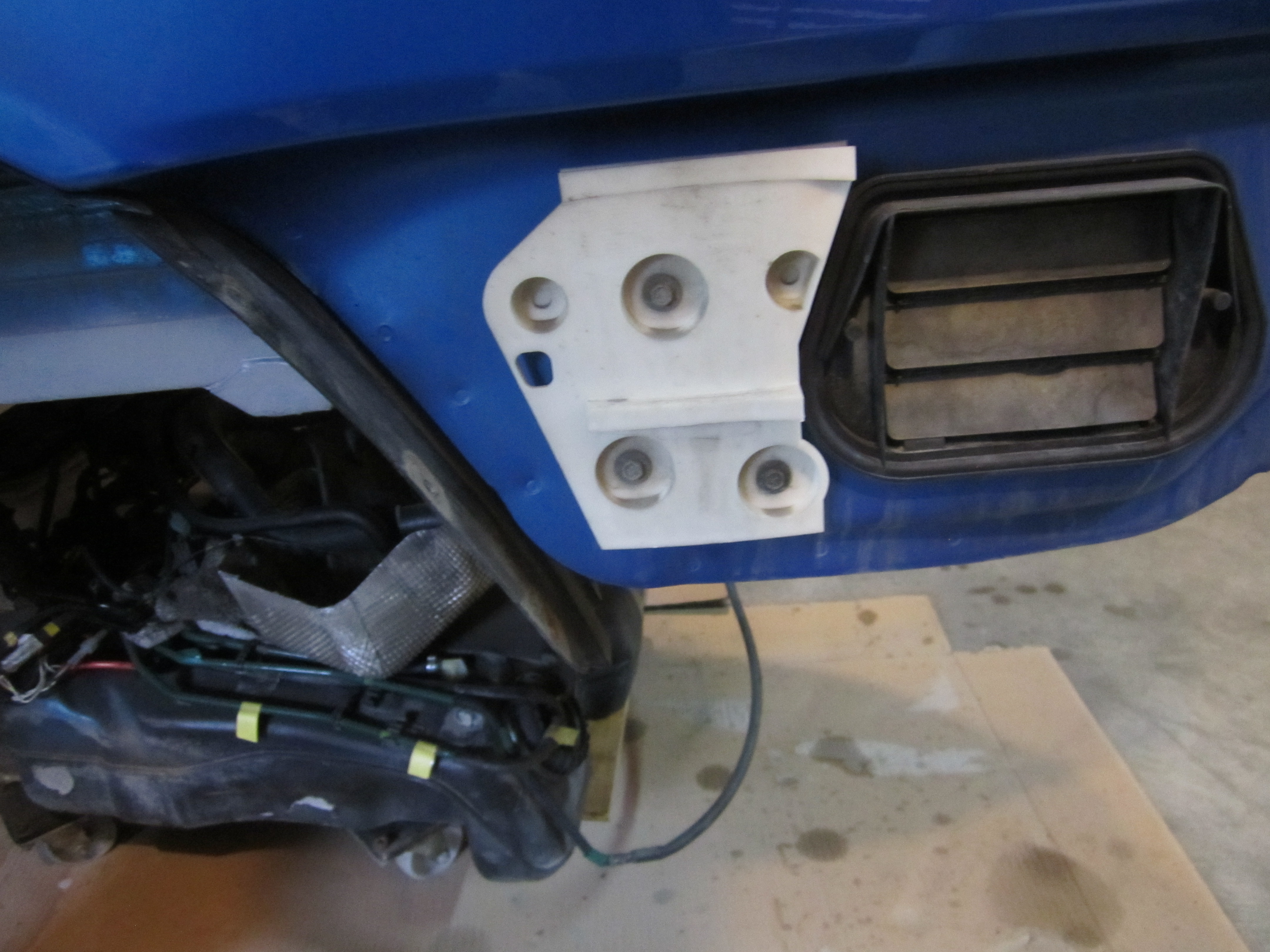

Now I'll show how the brackets actually mount on the car and the bumper:
These are the 2 bracket bolts for each of the brackets to mount to the car. Note the domed ends on them to make easier to align into the captured nuts.
Above picture shows the mounting on the rear of the car. The left side is slightly bent thanks to a hit and run driver in a parking lot.
Above is the bracket loosely mounted. I have put the bolt retaining long bolt so you can see where it locks the bumper top and bottom.
From this picture you can see that the bolt and bracket cannot be accessed from above as the rear hatch has a flange that completely covers it from above. This flange also prevents just pulling the bumper down to clear the broken bolt.

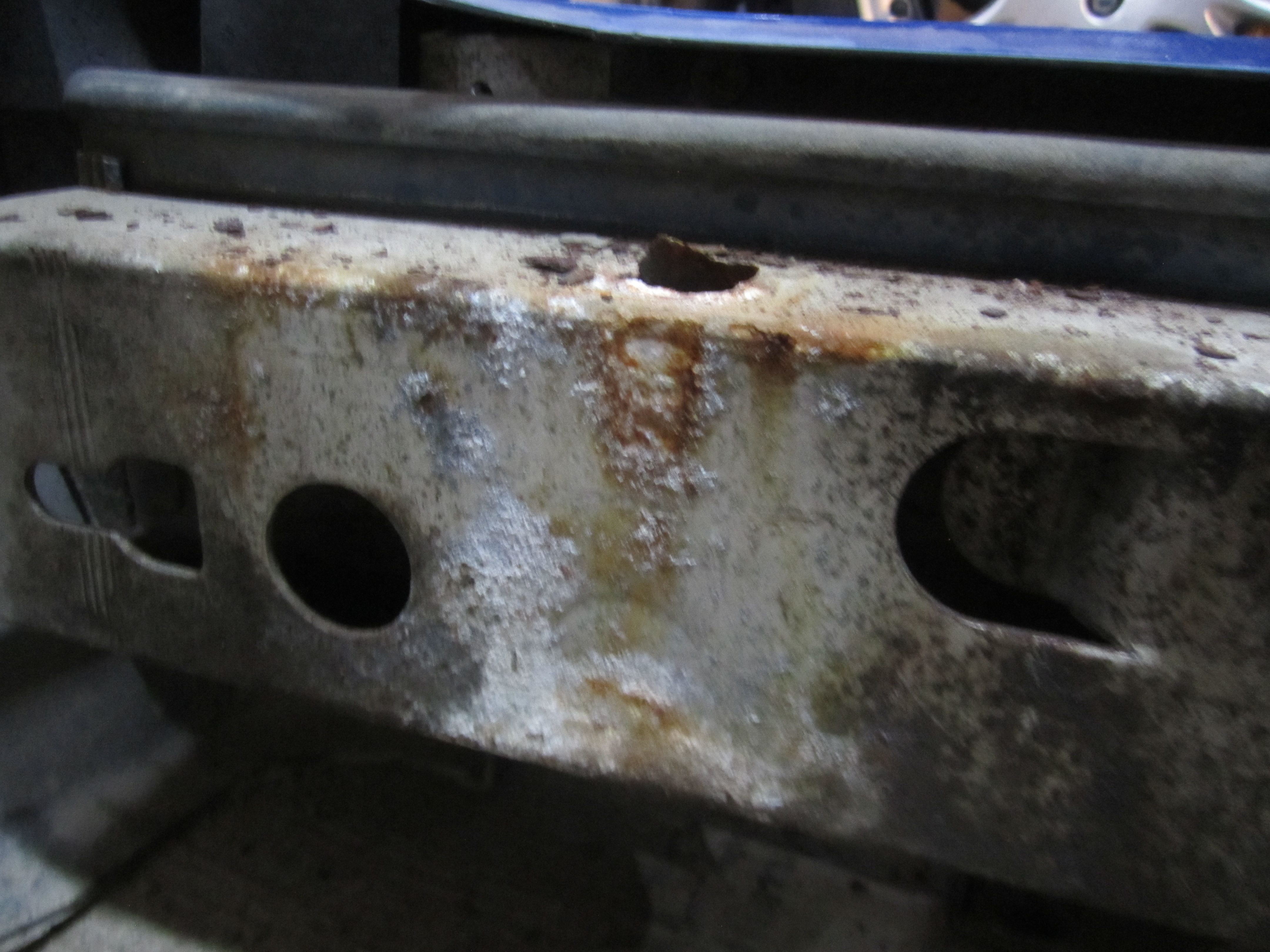

You can see in the picture above, the aluminum bumper stiffener. The single hole to the right face, is the through hole for the long mounting bolt. The 2 lower holes on the left actually are dimples that hide access to the bumper mounting bracket bolts.
This is viewed as looking toward the back of the car.

A point of note is that you will see how corroded the bumper stiffener is in the area where it touches the mounting bracket. I have seen stiffeners that are actually rotten through at this point! If you are brave enough, you may want to consider removing the mounting bolts from time to time, and use anti-seize. I am also planning to use a strip of 3M hood/paint protection as a sleeve between the stiffener and bracket to try to prevent further reaction.
