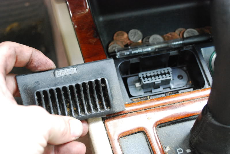

Nope...if you don't have obdII port under coin holder your chasis is older than '95.Like i said before...'95 have them BOTH.From '96,there is no more obdI diagnostic port under the hood.
This is the location of obdII port:

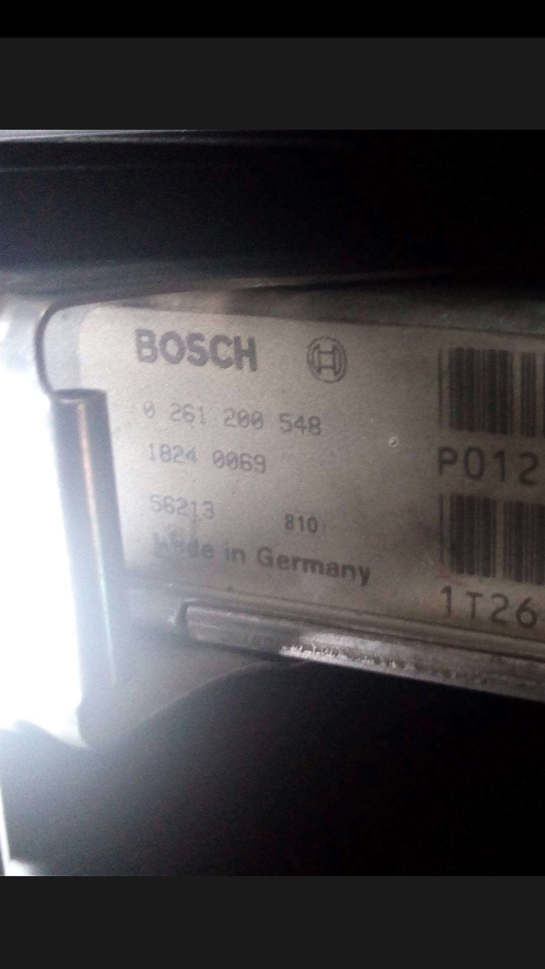

Not that number...the other one(the main one).For example 0 261 xxx xxx.
It would be the best to take a picture of ecu marks,but there can't be anything else than Motronic 4.3 inside that ecu box.

It has T (96)
But we found that it was 2.5 10v for Canada but now its 2.0t for italian market....and now because obds are not interchangeabel between thos two engines, i do not have any obd....
But what about my ECU ? What are those numbers? Is it ok?
