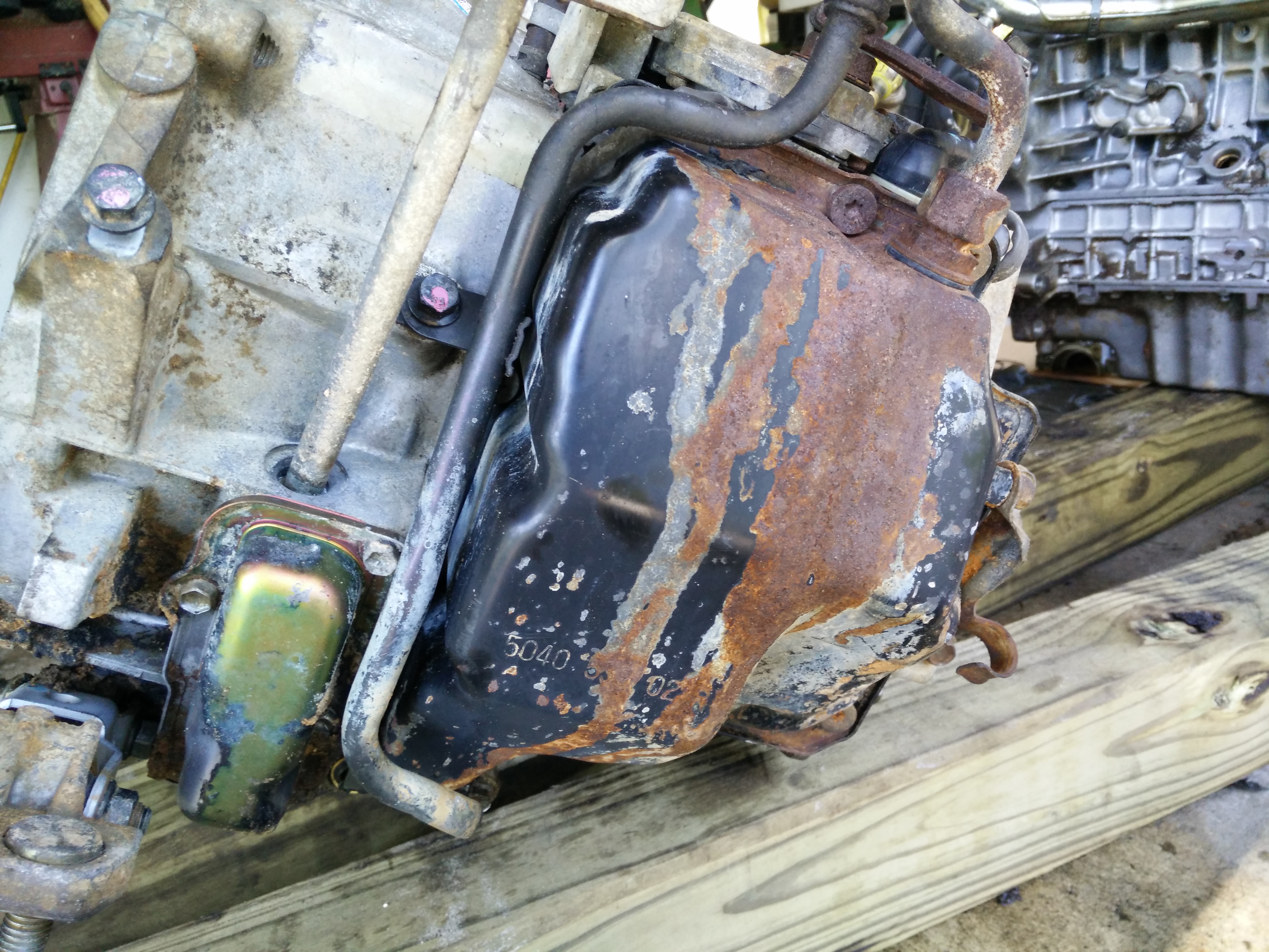

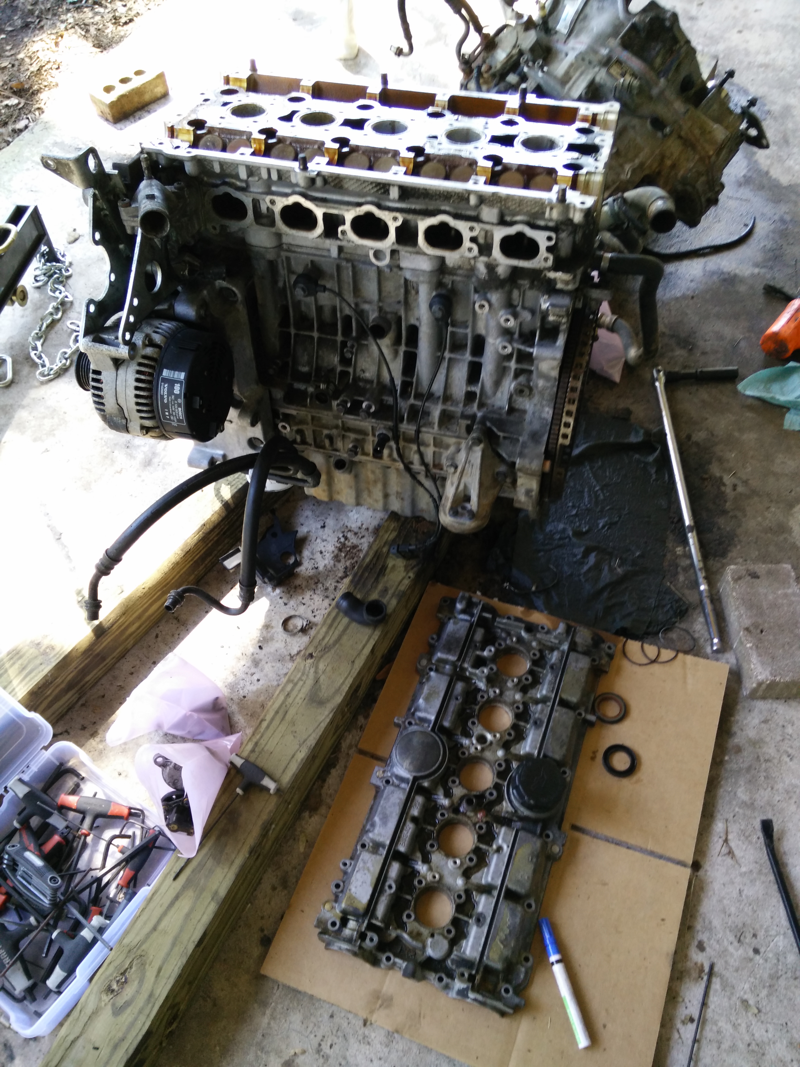

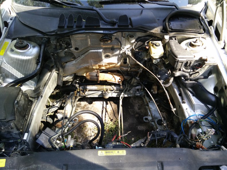

It has taken me a week but finally made it to this stage. Lots of pressure washing and scraping was needed. Car was driven a lot on dusty roads and with leaking oil has turned it all into concrete.

The previous owner had let the battery dump a bunch of acid all over the tray and it ate the paint off of one of the trans covers. Was thinking of pulling it off to sandblast and repaint. Am I going to get myself it trouble if I take this cover off? Looks like i'll have to permatex it back on since no gasket.
