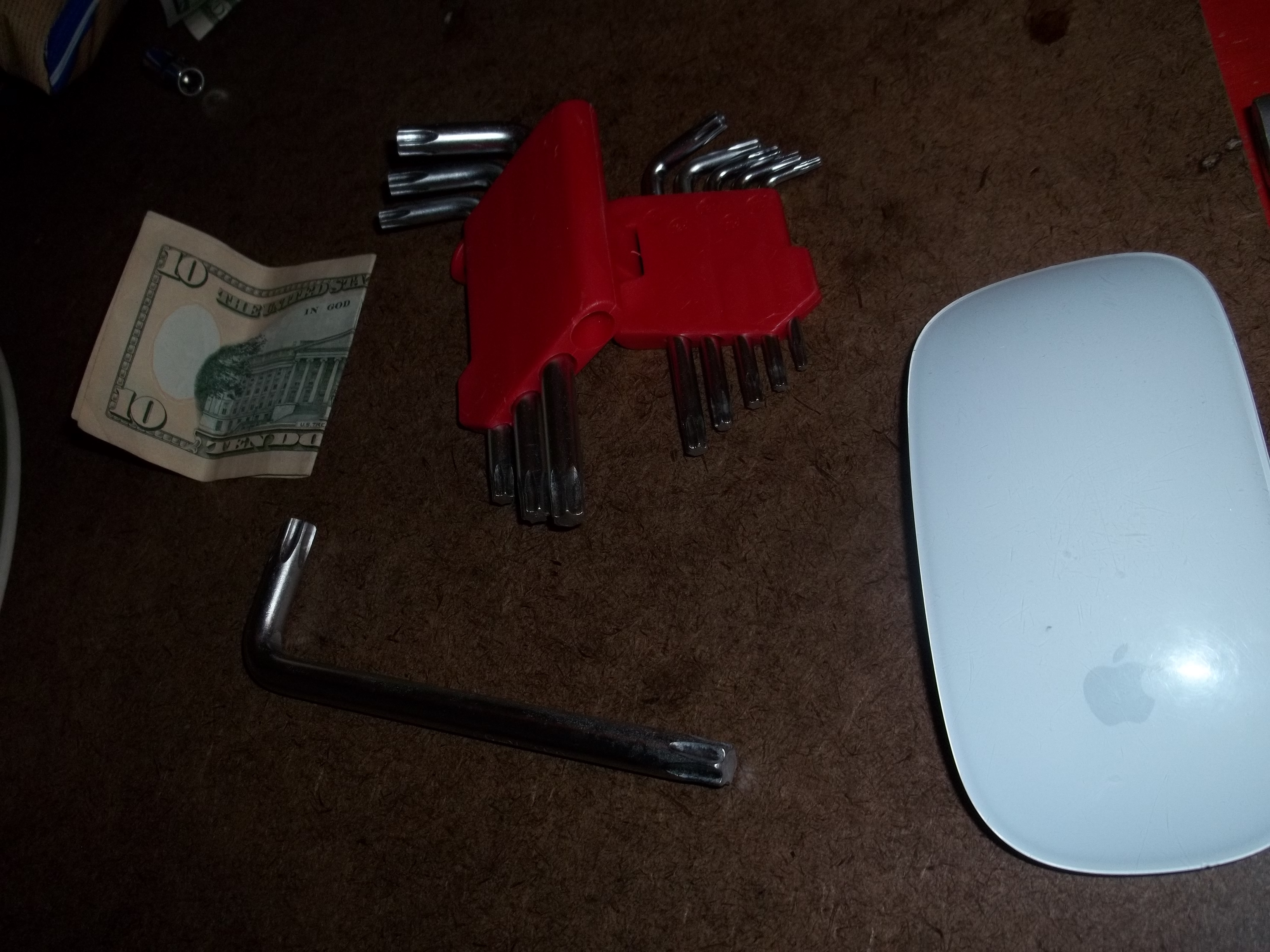

Update: Got my new Toys and tried adjusting my E-brake from the center console all the way until it wouldn't go anymore. I did get some tension back on the parking brake but not enough to stop rolling down my driveway.
But at least now I have this nice new Nine piece set of Torx Keys for under 10 buck including shipping! The good news is my former mechanic, whom I am trying to get a mercy inspection out of, said Parking Brake was not part of an inspection for an automatic. He might be wrong, but it will be sooner I can be back on the road.
Next up in this chapter: First Car Jacking and inspect e-brakes one at a time...
