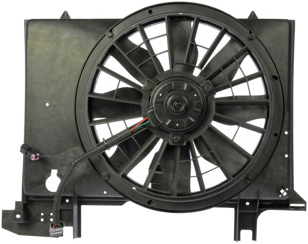

Sorry to bump this ancient thread but I think my fan motor is toast.
I recently replaced my radiator and added the IPD transmission cooler, got everything put back together and had the car idling in my driveway with the heater all the way up to get coolant cycling through the system to bleed out the air bubbles.
I was tidying up some wires that run across the top of the cooling fan shroud and noticed that the black wire coming from the motor was hot.. as in it literally burned my fingers when I grabbed it.
I then noticed smoke and it had a distinct electrical burning scent. I shut off the car and walked away for a few minutes absolutely furious.
When I came back, the fan itself was extremely difficult to spin so I'm assuming the motor is seized up and caused the burning smell?? Not sure why that wire was so hot though? It's this single wire shown in the pic below. I'm actually impressed that the wire coating had not melted. That's how hot it was.

sounds like u said motor is seized but I'd jump it first to see if it will come on.Auburn T5 wrote:Sorry to bump this ancient thread but I think my fan motor is toast.
When I came back, the fan itself was extremely difficult to spin so I'm assuming the motor is seized up and caused the burning smell?? Not sure why that wire was so hot though? It's this single wire shown in the pic below. I'm actually impressed that the wire coating had not melted. That's how hot it was.![]()
