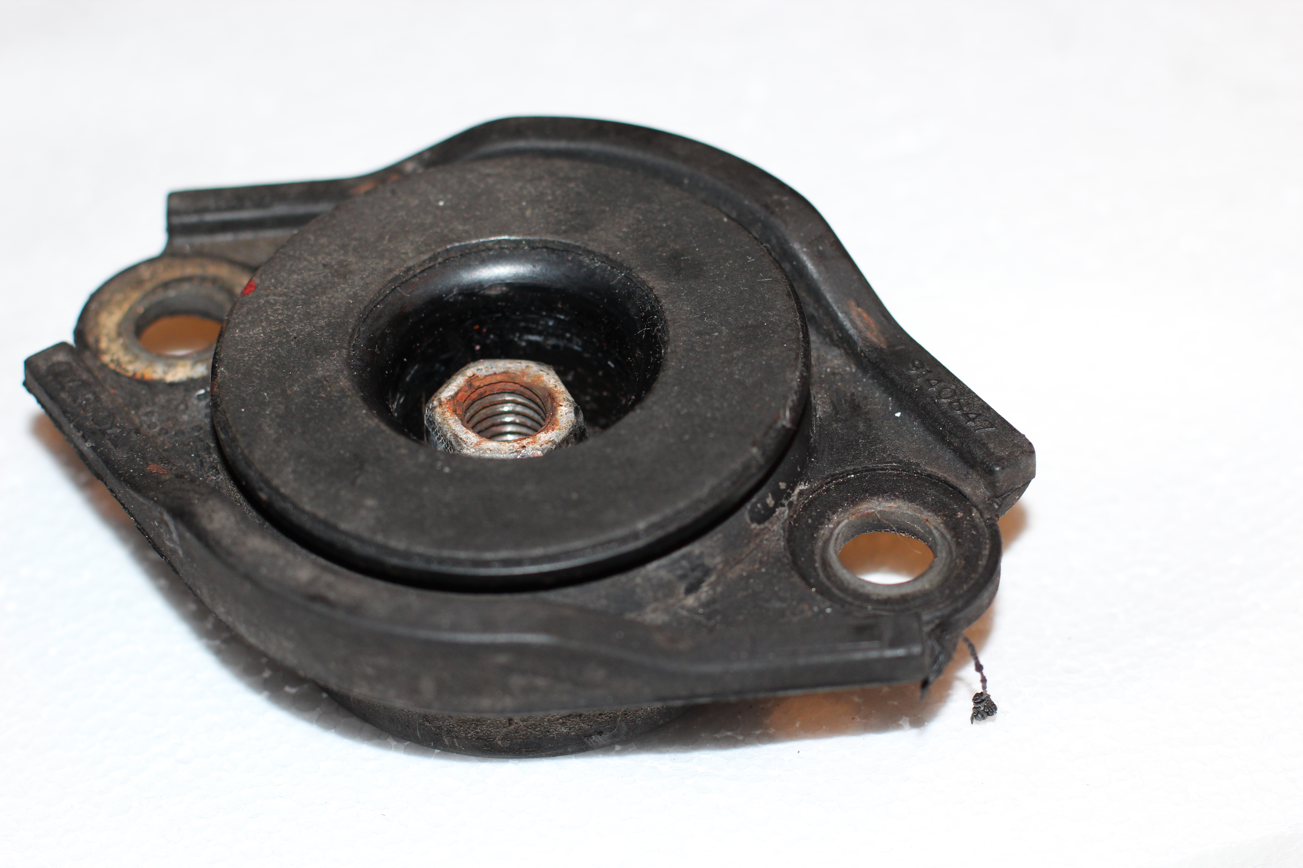

I just replaced my Platinum wagon rear NIVOMAT shock absorbers, which is a relative easy job. However, there are a few things different from regular shocks as reference to CN90’s excellent write-up:
Removal and Installation
The NIVOMAT shock has to be taken out and put back in from the bottom due to its huge size. In order to do that, the top locking nut (18mm, M12) has to be unscrewed first. Since NIVOMAT shock mount is quite bit deeper than regular mount, that nut is hard to grip by an offset wrench, but my impact wrench made this a breeze.
Parts
• Which NIVOMAT shock to get could be a bit confusing. The only way to be sure is to check the rear shock absorber code (AKA “marking”) on your VIN plate number 22. My shock is “F” and I found two shocks with different part numbers from Volvo would fit “marked F” rear shock absorber, 271809 (SACHS# 170 496) and 8626028 (SACHS# 444 213). At Sachs web site those two are listed as “replacement for/substituted by” to each other, which I assume 8626028 is a bit newer version but double the list price ($393 vs $181).
• For NIVOMAT shocks, the shock mount (Support plate) is 9140847, Mounting kit 272285 (top locking nut and bottom nut and washer).
Hope this is helpful to someone.
