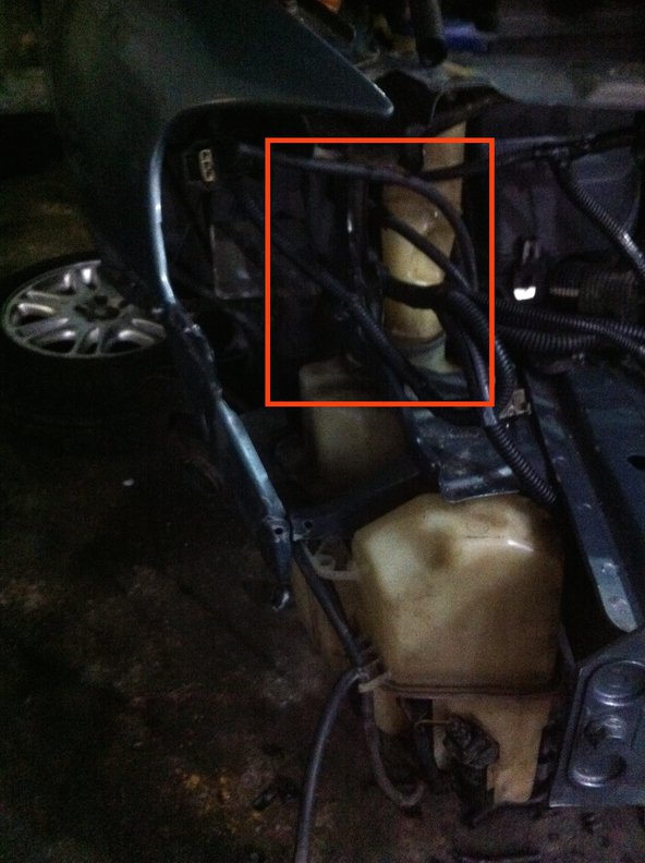

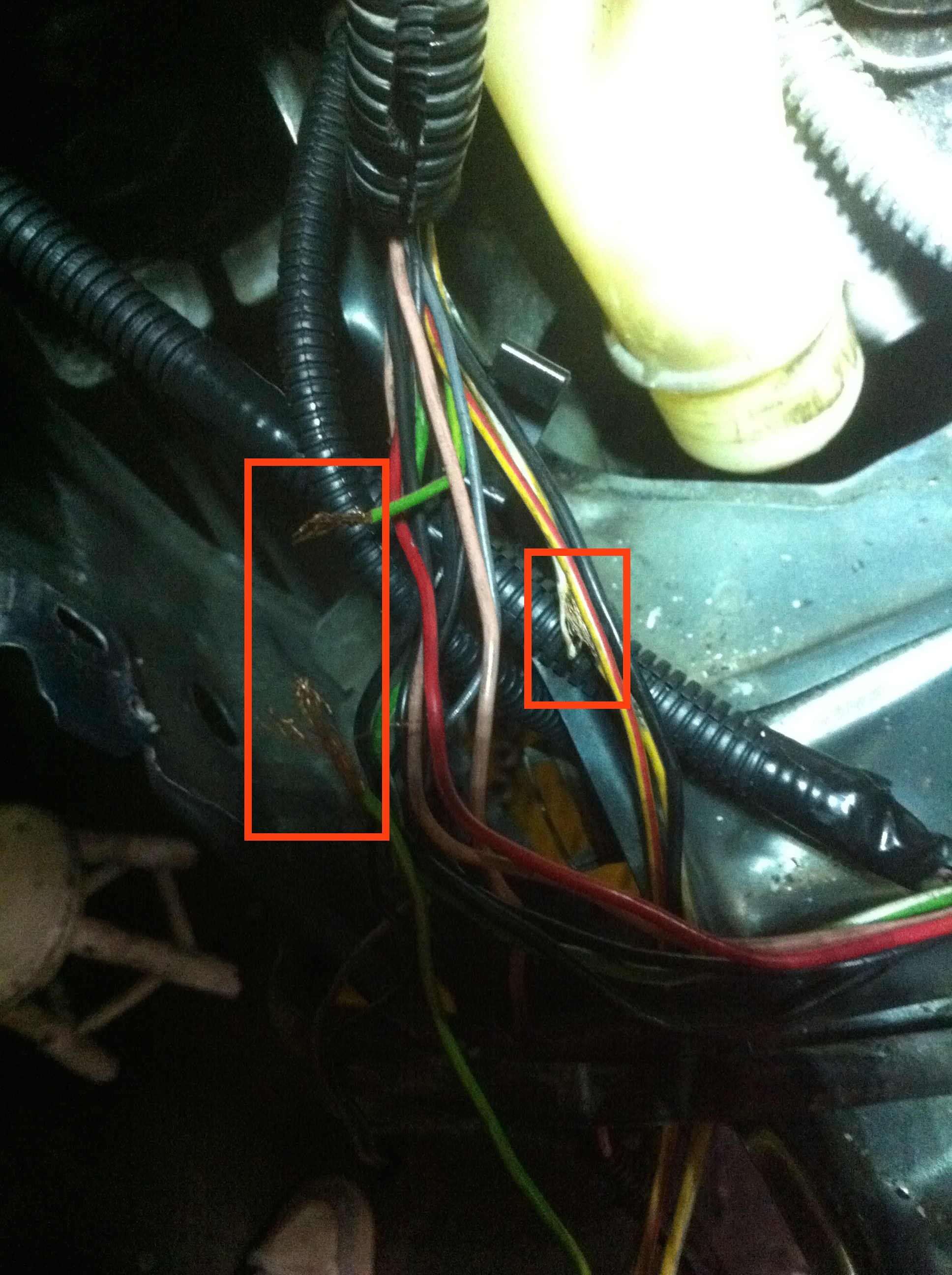

I knew the car was hit some years ago, on the passenger side, but was light crash, only a broken headlight lens and bend on the fender and a dent on the bonet; While changing the conduits I found one broken wire (that goes from the water reservoir to somewhere towards the back of the car ) and one exposed (this one I didn’t manage to track) - pics attached -, I fixed them properly… and removed the siren, that showed later a corroded circuit board.
