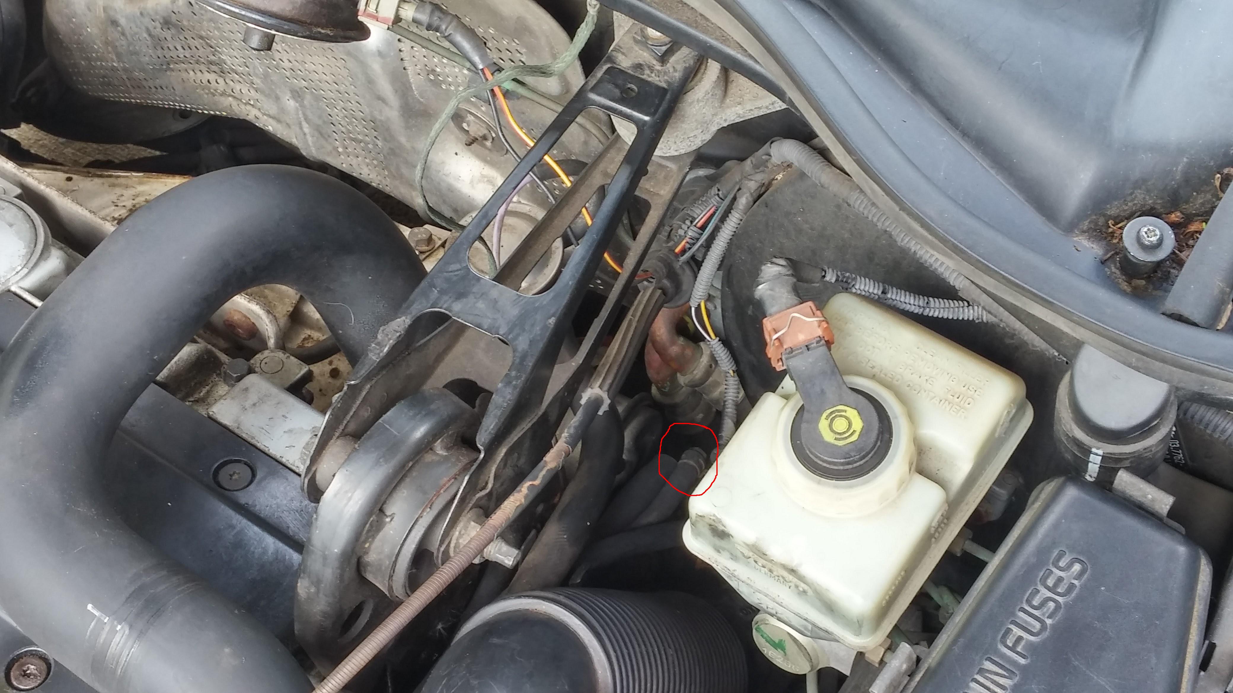

Well, another "What is this part" question. I can't find where it plugs in, and I seriously doubt this nail plugging it was there from the factory. Seems to me that it's part of the vacuum system, as it runs beside the line running to the intake hose from the purge valve.

What does the other end of the pipe connect to?

Post by bmdubya1198 »
scot850 wrote:What does the other end of the pipe connect to?
I have absolutely no idea. I tried going back on it, and I can't find where it goes. I'd have to move a lot of things to get in there. It might be connected right there, but I can't tell. If anything, it goes towards the engine.
