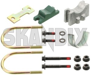

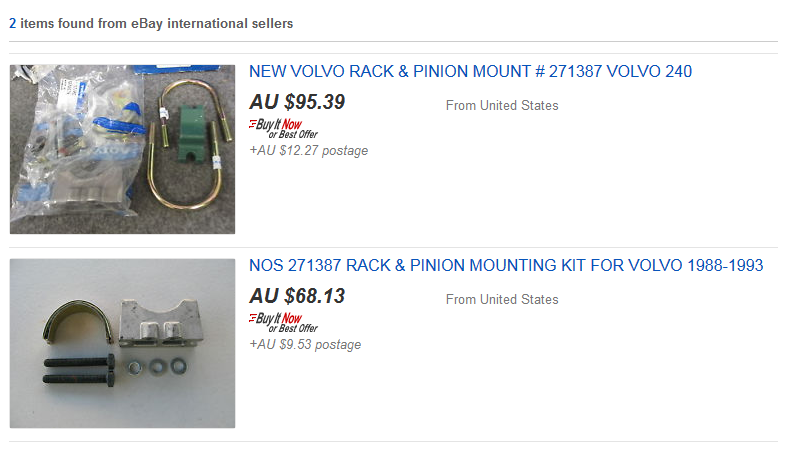

The part number might be: volvo 271387st956703 wrote:I am trying to source a mount kit
Ebay has this being shown, both are parts in US (and only the second listing ships to AU) but I have no idea what is the right part.
In Germany, they show this part kit, so that second ebay listing looks like they omitted those hangers.

I have found Skandix in Germany and have ordered the part which is as shown.
Bewt!!
Mick
