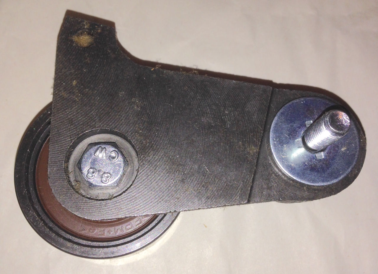

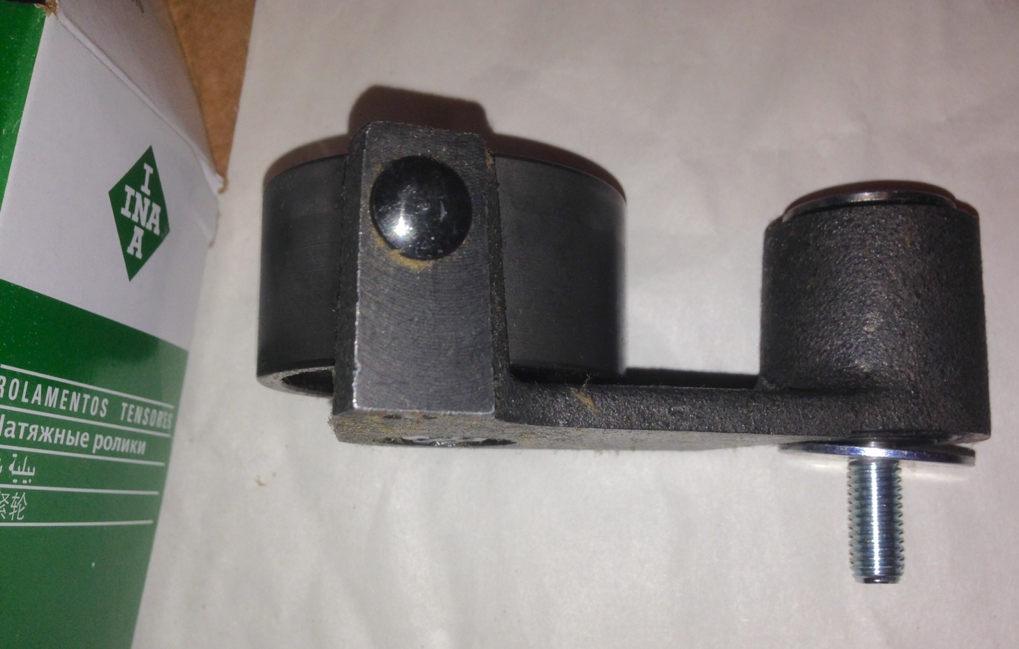

I'm gearing up for a timing belt change on my '97 855 at ~180k miles... getting tools, instructions, torque specs, materials and especially parts ready to go. This is going to be my second timing belt job and I decided to go with OE parts sourced from a reputable parts supplier (not a dealer). My question is, can you tell by looking at the tensioner pulley and other parts if they are genuine or counterfeit? They all look genuine to me, but I'm no expert. If you could take a look and let me know what you think, I'd appreciate it.

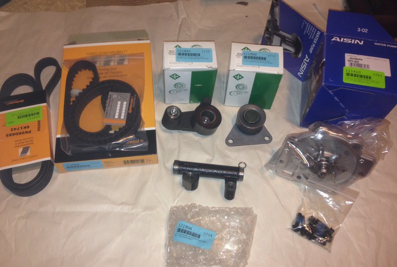

Overview of parts purchased:
Overview of timing belt parts

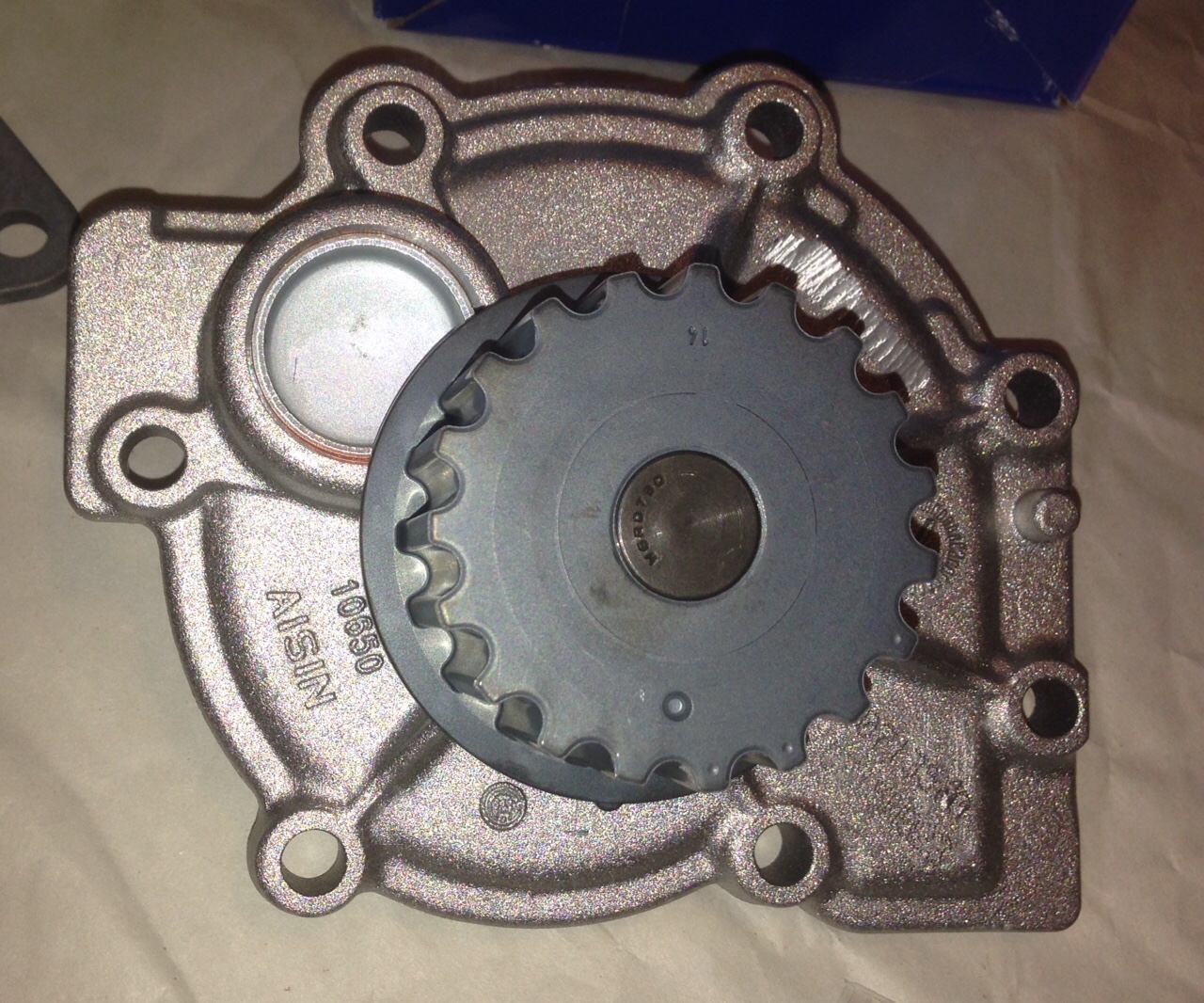

Aisin waterpump (I also got the gasket and 7 25mm bolts)

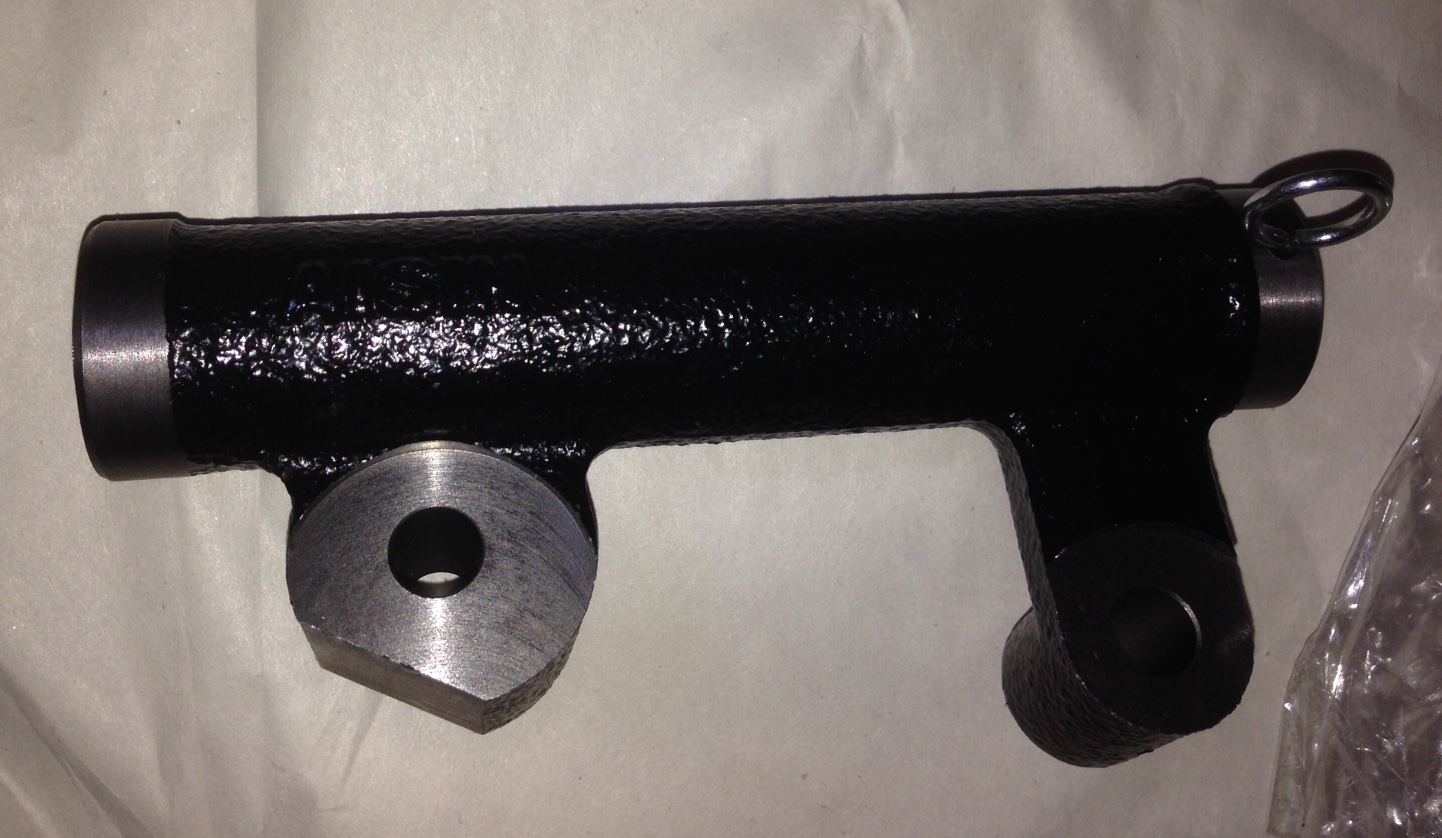

Aisin tensioner, with AISIN in casting on this side and a white ink AISIN stamp on the other side
Aisin tensioner
Aisin tensioner

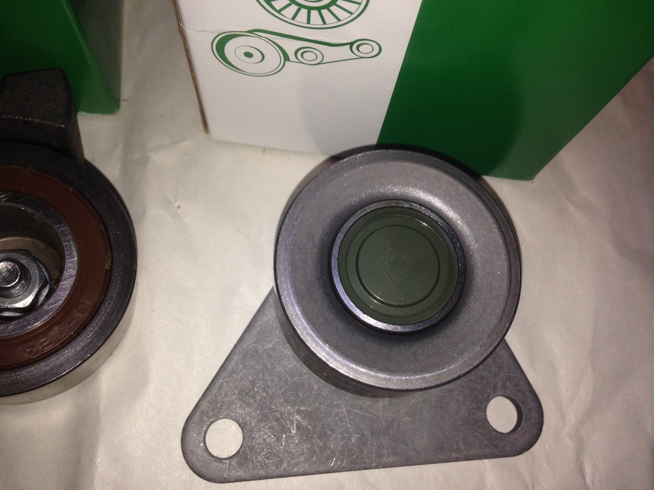

INA idler pulley
INA idler pulley

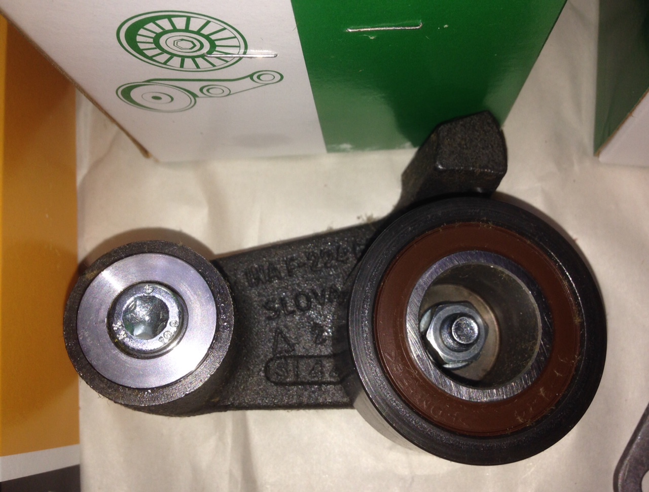

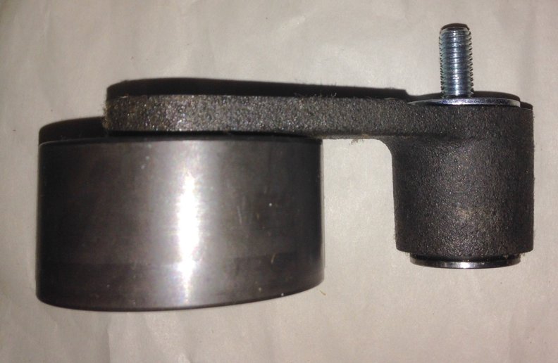

INA tensioner pulley view #1
INA tensioner pulley view #2
INA tensioner pulley view #3
INA tensioner pulley view #4

Looks good to me. I've done 6 or so P80 T-Belts so far...
See the area where there was grinding done on the water pump casting? That used to say "VOLVO". Aisin grinds it off their own branded water pumps.
