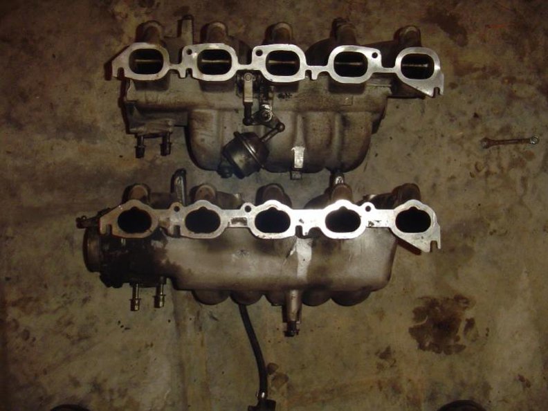

Here are the two manifolds for comparison.
The VVIS is top. You can see the vanes inside that alter the air flow.
The heads have ports that match. They are different.

I see the difference but there is also a different shaped manifold gasket to compensate that.
I would wait for other opinion for clarification.B5254 is B5254.....B5204 is B5204 and that's the end of story.
I just want to say again that i saw with my own eyes that engine from '98 v70 was installed into '92 850 which had 2.5 20v engine.Manifolds and sensors were transfered from original engine and it ran without problems.

The engine will run without the ports matching perfectly so long as the holes are centered the same but it won't run as well as it would otherwise.

cohomology wrote:Thank you Ben for the very helpful information. Based on the discussion, I guess I could live with the performance loss and just drop in an engine from a later model.
I do not believe there would be any loss of performance. leave the intake manifold on the replacement engine. Utilize the existing exhaust manifold from the '93 for above mentioned reason.
A few sensors may need to be changed, but up to '96 N/A should swap in, possibly with better performance.
